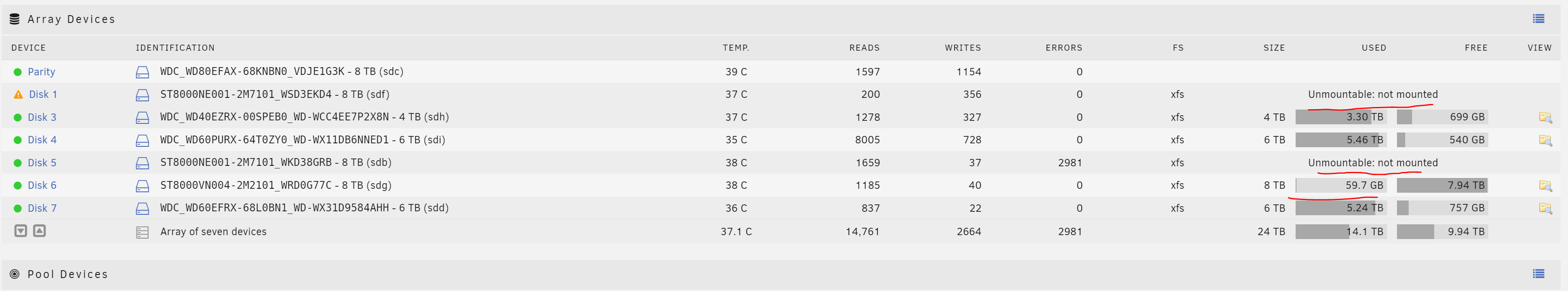

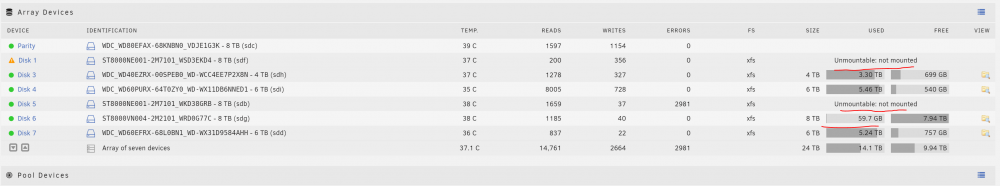

Are you saying Disk 6,5 and 1 possibly hardware failure? Because I just bought it recently, the oldest one is Disk6, around 4 months ago, Disk5 2 months ago. Disk 1 just bought it last week. Or seagate I bought is just shit?

I will try again tomorrow, I have some cables somewhere in office and will try that. I have swapped the sata cables but still unmountable. I havent tried to change the molex to sata adapter to power the HDD. I see numbers and most of it are empty. So it's good to say that disk6 is empty and I cant recover anything? EDIT: Side note, now the error is gone, just that 2 disks are unmountable

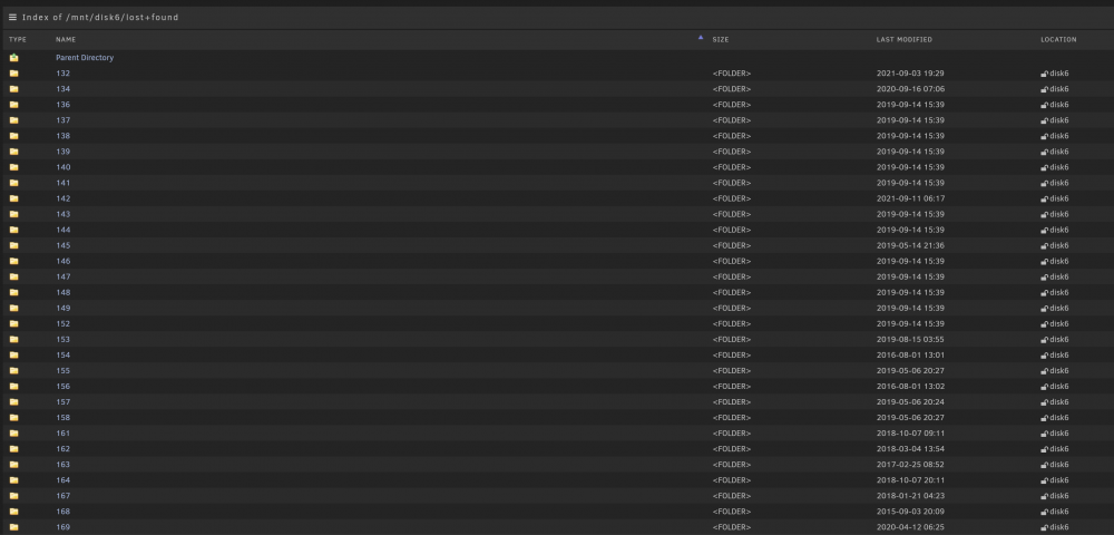

Unfortunately this is my best backup unraid has been reliable protecting my files. Should I try to back up whatever's left?

I changed the cable, changed the sata slot on disk5, still unmountable. mynas-diagnostics-20210913-2038.zip

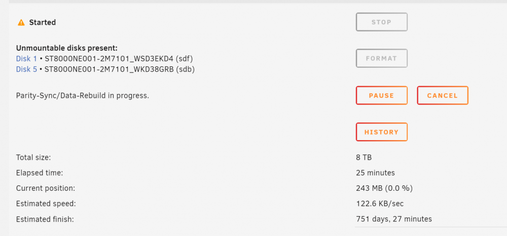

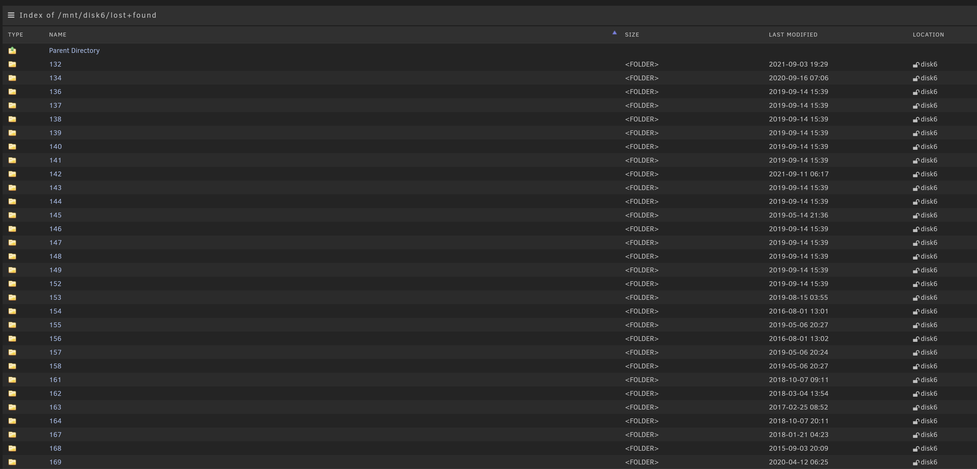

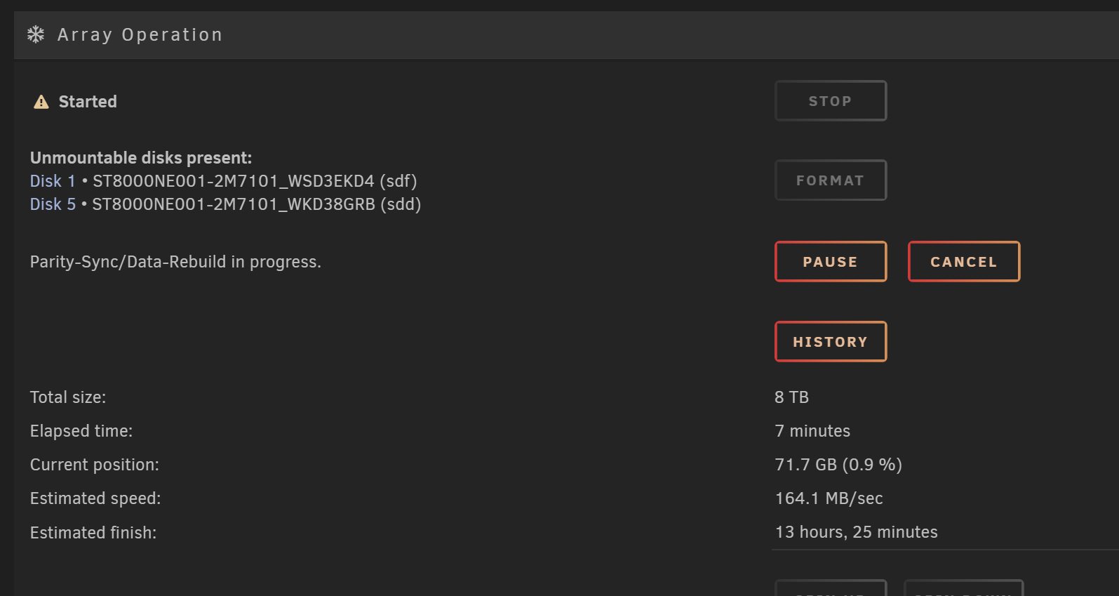

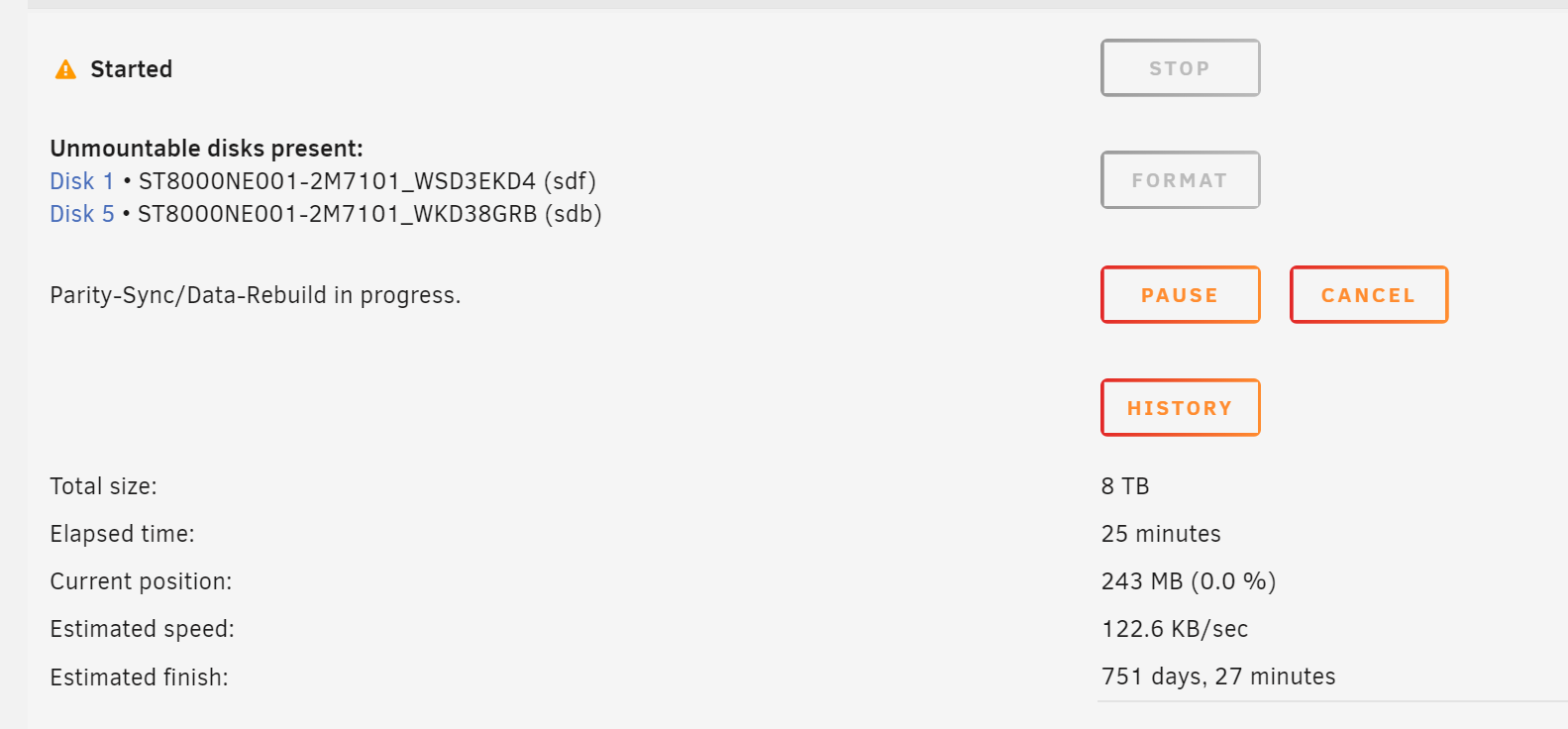

It all started with Disk 1 died, so for a few days while waiting new disk comes, content is emulated. Now that it has come, opened up the case, swap the disk, suddenly Disk 1 becomes unmountable: not mounted. Weird it's a new disk, so I swapped the cables for it, somehow disk 5 and 6 follows, becomes unmountable. So I read up here https://wiki.unraid.net/Check_Disk_Filesystems#Checking_and_fixing_drives_in_the_webGui I did the xfs-repair. Not sure how I did it, suddenly disk 5 and 6 loss all data, if you see screenshot above that disks 6 has 56gb used. originally both disk 5 and 6 has almost full disk. Is there anyway to recover those files? Panicked, I try to upgrade UNRAID to the latest RC version, only to kill my USB. I changed my USB to a new one, and copied the config to the new USB. Screenshot are all from the new USB. Anyway, I dare not do anything else as of now, here I seek guidance on how should I proceed. I noticed photos from 2008 are gone, probably because they're on disk 5 or 6. Right now the system is doing parity rebuild, but the speed is horrible. mynas-diagnostics-20210913-2001.zip here is the diagnostics, not sure if it any helps. Weird part that I notice is that all these happens to Seagate IronWolf disks.

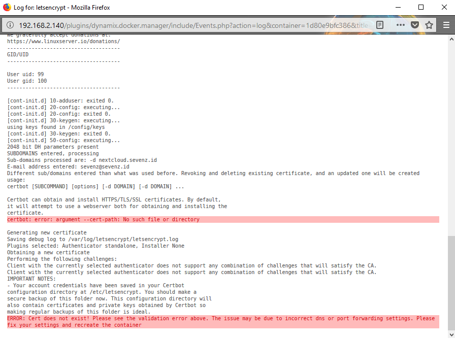

Hello guys, Letsencrypt goes down on me suddenly, I don't recall on making changes on UnRaid (only adding new HDD and SSD) and I haven't upgraded to 6.4.0 yet. Browsing through the thread, I don't see anyone with similar log to mine (or I missed it). Here is the log. I notice because Nextcloud stopped working this morning. Everything was working before then.

Ahh sorry, should I post in Letsencrypt instead? EDIT: Nevermind I got it working! Turns out I need to port letsencrypt to 443 and nextcloud to 444, not the other way around!
