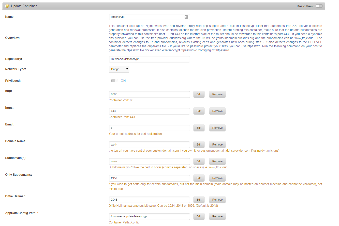

Hello, I'm trying to install letsencrypt. I wonder what causes this certbot error --cert-path: no such file or directory. Full log. and here is the command after I press applied. root@localhost:# /usr/local/emhttp/plugins/dynamix.docker.manager/scripts/docker run -d --name="letsencrypt" --net="bridge" --privileged="true" -e TZ="Asia/Bangkok" -e HOST_OS="unRAID" -e "EMAIL"="[email protected]" -e "URL"="work..example.me" -e "SUBDOMAINS"="www" -e "ONLY_SUBDOMAINS"="false" -e "DHLEVEL"="2048" -e "PUID"="99" -e "PGID"="100" -p 8083:80/tcp -p 443:443/tcp -v "/mnt/user/appdata/letsencrypt":"/config":rw linuxserver/letsencrypt 5014fdf3443be36024babe333597136c12a6b95e2d19e52a32946480ffdeea1b Any idea where I did wrong?
