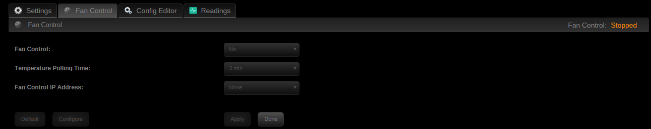

  6. Thanks for quick response! The option to select configure is grayed out. The fan control is reported as stopped in the top right corner, and I can't select yes. I've tried uninstalling the plugin, removing all files in the ipmi folder but same behavior. I've successfully used raw ipmi commands i found much earlier in this thread to set the rear fan on a higher setting while i figure this out, so the commands definitely do work.
  7. Hi all, Having a bit of trouble getting Fan Control to work on Asrock E3C236D2I Getting all the sensors , voltages/temps/fan speeds for the 3 fan headers ok on the IPMI Sensors page. Its obviously talking to the IPMI fine, data all matches what I get from the actual IPMI Fan Control settings are greyed out, and when I try to Force Start the ipmifan i get, ipmifan[3855]: Your AsrockRack motherboard is not supported or setup yet What exactly should I be setting up? is there some auto scan or file that needs to be edited? Sorry, i'm a bit useless, getting used to all this been a while since I did anything cli based.
