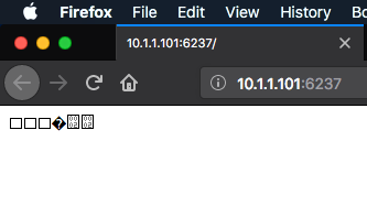

  3. I'm having an interesting issue - I've run unBalance a few times on my main server and it's worked great, but I'm setting up a new server for a friend and I can't get it to run - all I get is the attached screenshot when I try to pull up the UI - any thoughts? I'm trying to access this on my Mac, but I get the same result on Ubuntu as well (Firefox both times).
