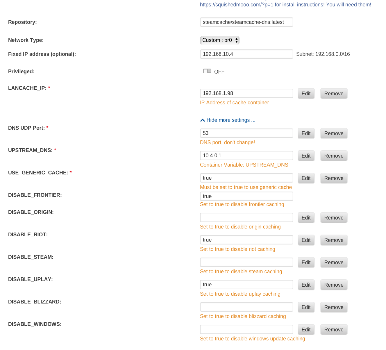

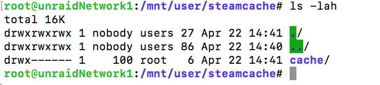

  5. Ok i've run that and removed all the '- - -' Also removed all the exceptions for cached servers. Feel like its gotta be something simple but just not sure. For the clients, Im only using the steam cache server for dns w/ no additional entries. Changed its dns as I was getting spotty results with it now. New dns pinging fine heres what the log looks like now - but still doesn't seem to be passing through data. Some of the previous posts show green/red/yellow .. but all I ever get is white.

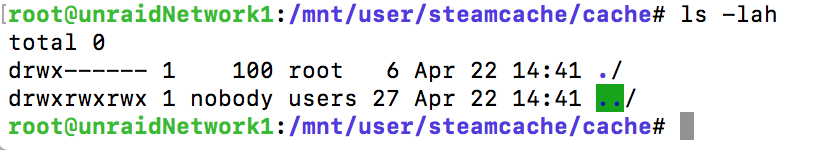

  6. Thanks for responding - I think it is some permission thing, I wasn't ever able to browse the \cache\ folder. I ran tools \ new permissions on that folder and fixed that but still wouldn't cache. Deleted the folder and started new. Remapped to the docker to add cache folder. Still doesn't work. Tracked down the file permissions, but not sure how to go about changing. If you could lead me in that direction ill try that .

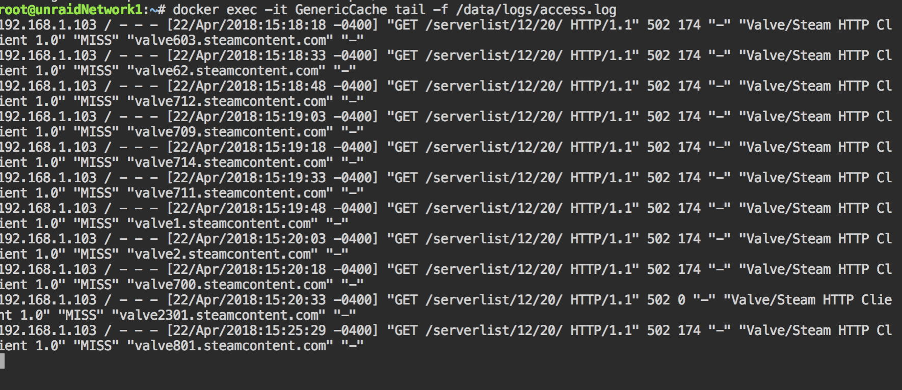

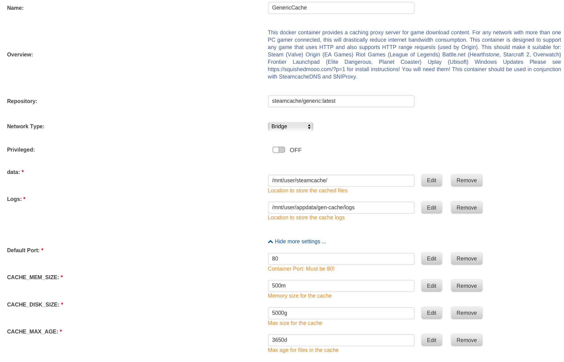

  7. Hi. Trying to get this all working on 6.5.0 . Followed instructions on https://squishedmooo.com/?p=1 and running all three dockers. When using on gaming machine, it returns unraid ip .1.98 and when checking on docker exec -it cache-steam tail -f /data/logs/access.log in terminal I get dns inquires and misses, but no data is downloaded or transferred to the machine. If I select that service to be disabled, it downloads perfectly. I've tried default installed directories into cache and then moved into /steamcache/ share. Any help would be appreciated. config snapshots

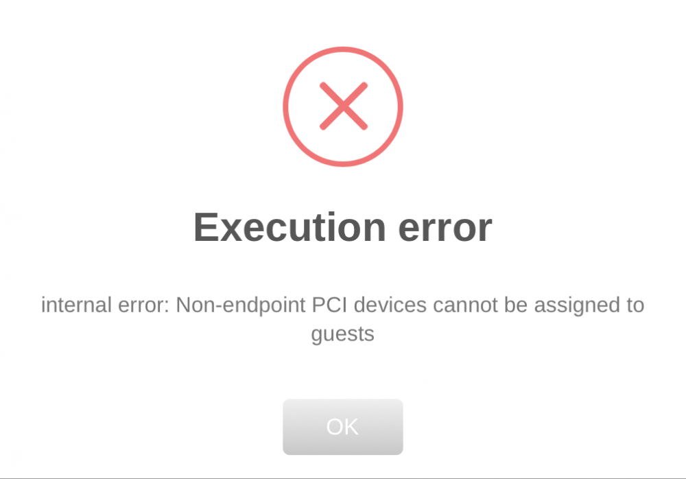

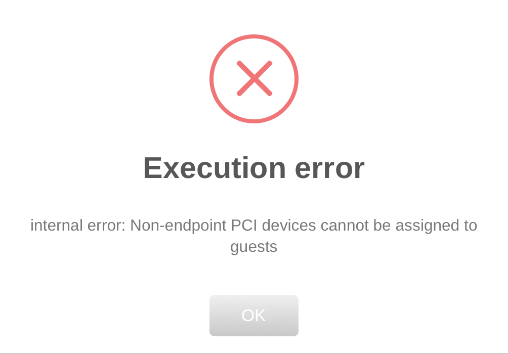

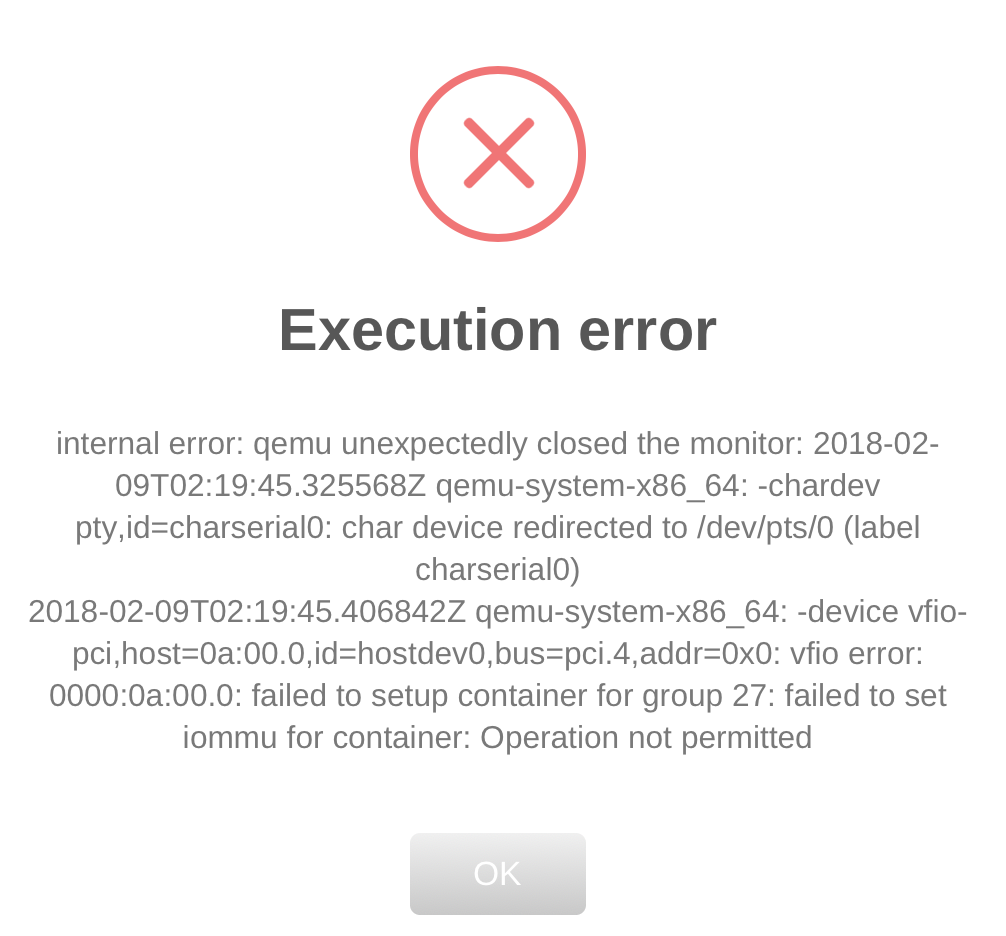

  12. added that all in but got a new and improved error - looking up on search just seeing acs enabling - let me know what you think default /syslinux/menu.c32 menu title Lime Technology, Inc. prompt 0 timeout 50 label unRAID OS menu default kernel /bzimage append pcie_acs_override=id:111d:8018,8086:10bc vfio_iommu_type1.allow_unsafe_interrupts=1 vfio-pci.ids=111d:8018,8086:10bc initrd=/bzroot label unRAID OS GUI Mode kernel /bzimage append initrd=/bzroot,/bzroot-gui label unRAID OS Safe Mode (no plugins, no GUI) kernel /bzimage append initrd=/bzroot unraidsafemode label unRAID OS GUI Safe Mode (no plugins) kernel /bzimage append initrd=/bzroot,/bzroot-gui unraidsafemode label Memtest86+ kernel /memtest IOMMU group 25: [111d:8018] 09:02.0 PCI bridge: Integrated Device Technology, Inc. [IDT] PES12N3A PCI Express Switch (rev 0e) IOMMU group 26: [111d:8018] 09:04.0 PCI bridge: Integrated Device Technology, Inc. [IDT] PES12N3A PCI Express Switch (rev 0e) IOMMU group 27: [8086:10bc] 0a:00.0 Ethernet controller: Intel Corporation 82571EB Gigabit Ethernet Controller (Copper) (rev 06) [8086:10bc] 0a:00.1 Ethernet controller: Intel Corporation 82571EB Gigabit Ethernet Controller (Copper) (rev 06) IOMMU group 28: [8086:10bc] 0b:00.0 Ethernet controller: Intel Corporation 82571EB Gigabit Ethernet Controller (Copper) (rev 06) [8086:10bc] 0b:00.1 Ethernet controller: Intel Corporation 82571EB Gigabit Ethernet Controller (Copper) (rev 06) <hostdev mode='subsystem' type='pci' managed='yes'> <driver name='vfio'/> <source> <address domain='0x0000' bus='0x09' slot='0x02' function='0x0'/> </source> </hostdev> <hostdev mode='subsystem' type='pci' managed='yes'> <driver name='vfio'/> <source> <address domain='0x0000' bus='0x0a' slot='0x00' function='0x0'/> </source> </hostdev> <hostdev mode='subsystem' type='pci' managed='yes'> <driver name='vfio'/> <source> <address domain='0x0000' bus='0x0a' slot='0x00' function='0x1'/> </source> </hostdev> <hostdev mode='subsystem' type='pci' managed='yes'> <driver name='vfio'/> <source> <address domain='0x0000' bus='0x09' slot='0x04' function='0x0'/> </source> </hostdev> <hostdev mode='subsystem' type='pci' managed='yes'> <driver name='vfio'/> <source> <address domain='0x0000' bus='0x0b' slot='0x00' function='0x0'/> </source> </hostdev> <hostdev mode='subsystem' type='pci' managed='yes'> <driver name='vfio'/> <source> <address domain='0x0000' bus='0x0b' slot='0x00' function='0x1'/> </source> </hostdev>
  13. default menu.c32 menu title Lime Technology, Inc. prompt 0 timeout 50 label unRAID OS menu default kernel /bzimage append intel_iommu=on vfio_iommu_type1.allow_unsafe_interrupts=1 pcie_acs_override=downstream pci-stub.ids=8086:10bc initrd=/bzroot label unRAID OS GUI Mode kernel /bzimage append initrd=/bzroot,/bzroot-gui label unRAID OS Safe Mode (no plugins, no GUI) kernel /bzimage append initrd=/bzroot unraidsafemode label unRAID OS GUI Safe Mode (no plugins) kernel /bzimage append initrd=/bzroot,/bzroot-gui unraidsafemode label Memtest86+ kernel /memtest <domain type='kvm'> <name>Pfsense</name> <uuid>52c7ad92-88b0-c265-c74a-504464704cd6</uuid> <metadata> <vmtemplate xmlns="unraid" name="FreeBSD" icon="freebsd.png" os="freebsd"/> </metadata> <memory unit='KiB'>4718592</memory> <currentMemory unit='KiB'>4718592</currentMemory> <memoryBacking> <nosharepages/> </memoryBacking> <vcpu placement='static'>4</vcpu> <cputune> <vcpupin vcpu='0' cpuset='10'/> <vcpupin vcpu='1' cpuset='22'/> <vcpupin vcpu='2' cpuset='11'/> <vcpupin vcpu='3' cpuset='23'/> </cputune> <os> <type arch='x86_64' machine='pc-q35-2.7'>hvm</type> <loader readonly='yes' type='pflash'>/usr/share/qemu/ovmf-x64/OVMF_CODE-pure-efi.fd</loader> <nvram>/etc/libvirt/qemu/nvram/52c7ad92-88b0-c265-c74a-504464704cd6_VARS-pure-efi.fd</nvram> </os> <features> <acpi/> <apic/> </features> <cpu mode='host-passthrough' check='none'> <topology sockets='1' cores='2' threads='2'/> </cpu> <clock offset='utc'> <timer name='rtc' tickpolicy='catchup'/> <timer name='pit' tickpolicy='delay'/> <timer name='hpet' present='no'/> </clock> <on_poweroff>destroy</on_poweroff> <on_reboot>restart</on_reboot> <on_crash>restart</on_crash> <devices> <emulator>/usr/local/sbin/qemu</emulator> <disk type='file' device='disk'> <driver name='qemu' type='raw' cache='writeback'/> <source file='/mnt/user/domains/Pfsense/pfsensemain.img'/> <target dev='hdc' bus='virtio'/> <boot order='1'/> <address type='pci' domain='0x0000' bus='0x03' slot='0x00' function='0x0'/> </disk> <disk type='file' device='cdrom'> <driver name='qemu' type='raw'/> <source file='/mnt/user/isos/pfSense-CE-2.3.5-RELEASE-amd64.iso'/> <target dev='hda' bus='sata'/> <readonly/> <boot order='2'/> <address type='drive' controller='0' bus='0' target='0' unit='0'/> </disk> <controller type='usb' index='0' model='ich9-ehci1'> <address type='pci' domain='0x0000' bus='0x00' slot='0x07' function='0x7'/> </controller> <controller type='usb' index='0' model='ich9-uhci1'> <master startport='0'/> <address type='pci' domain='0x0000' bus='0x00' slot='0x07' function='0x0' multifunction='on'/> </controller> <controller type='usb' index='0' model='ich9-uhci2'> <master startport='2'/> <address type='pci' domain='0x0000' bus='0x00' slot='0x07' function='0x1'/> </controller> <controller type='usb' index='0' model='ich9-uhci3'> <master startport='4'/> <address type='pci' domain='0x0000' bus='0x00' slot='0x07' function='0x2'/> </controller> <controller type='sata' index='0'> <address type='pci' domain='0x0000' bus='0x00' slot='0x1f' function='0x2'/> </controller> <controller type='pci' index='0' model='pcie-root'/> <controller type='pci' index='1' model='pcie-root-port'> <model name='pcie-root-port'/> <target chassis='1' port='0x10'/> <address type='pci' domain='0x0000' bus='0x00' slot='0x02' function='0x0' multifunction='on'/> </controller> <controller type='pci' index='2' model='pcie-root-port'> <model name='pcie-root-port'/> <target chassis='2' port='0x11'/> <address type='pci' domain='0x0000' bus='0x00' slot='0x02' function='0x1'/> </controller> <controller type='pci' index='3' model='pcie-root-port'> <model name='pcie-root-port'/> <target chassis='3' port='0x12'/> <address type='pci' domain='0x0000' bus='0x00' slot='0x02' function='0x2'/> </controller> <controller type='pci' index='4' model='pcie-root-port'> <model name='pcie-root-port'/> <target chassis='4' port='0x13'/> <address type='pci' domain='0x0000' bus='0x00' slot='0x02' function='0x3'/> </controller> <controller type='pci' index='5' model='pcie-root-port'> <model name='pcie-root-port'/> <target chassis='5' port='0x14'/> <address type='pci' domain='0x0000' bus='0x00' slot='0x02' function='0x4'/> </controller> <controller type='pci' index='6' model='pcie-root-port'> <model name='pcie-root-port'/> <target chassis='6' port='0x15'/> <address type='pci' domain='0x0000' bus='0x00' slot='0x02' function='0x5'/> </controller> <controller type='pci' index='7' model='pcie-root-port'> <model name='pcie-root-port'/> <target chassis='7' port='0x16'/> <address type='pci' domain='0x0000' bus='0x00' slot='0x02' function='0x6'/> </controller> <controller type='pci' index='8' model='pcie-root-port'> <model name='pcie-root-port'/> <target chassis='8' port='0x17'/> <address type='pci' domain='0x0000' bus='0x00' slot='0x02' function='0x7'/> </controller> <controller type='pci' index='9' model='pcie-root-port'> <model name='pcie-root-port'/> <target chassis='9' port='0x18'/> <address type='pci' domain='0x0000' bus='0x00' slot='0x03' function='0x0'/> </controller> <controller type='virtio-serial' index='0'> <address type='pci' domain='0x0000' bus='0x02' slot='0x00' function='0x0'/> </controller> <interface type='bridge'> <mac address='52:54:00:52:42:78'/> <source bridge='br0'/> <model type='virtio'/> <address type='pci' domain='0x0000' bus='0x01' slot='0x00' function='0x0'/> </interface> <serial type='pty'> <target port='0'/> </serial> <console type='pty'> <target type='serial' port='0'/> </console> <channel type='unix'> <target type='virtio' name='org.qemu.guest_agent.0'/> <address type='virtio-serial' controller='0' bus='0' port='1'/> </channel> <input type='tablet' bus='usb'> <address type='usb' bus='0' port='1'/> </input> <input type='mouse' bus='ps2'/> <input type='keyboard' bus='ps2'/> <graphics type='vnc' port='-1' autoport='yes' websocket='-1' listen='0.0.0.0' keymap='en-us'> <listen type='address' address='0.0.0.0'/> </graphics> <video> <model type='qxl' ram='65536' vram='65536' vgamem='16384' heads='1' primary='yes'/> <address type='pci' domain='0x0000' bus='0x00' slot='0x01' function='0x0'/> </video> <hostdev mode='subsystem' type='pci' managed='yes'> <driver name='vfio'/> <source> <address domain='0x0000' bus='0x0a' slot='0x00' function='0x0'/> </source> <address type='pci' domain='0x0000' bus='0x04' slot='0x00' function='0x0'/> </hostdev> <hostdev mode='subsystem' type='pci' managed='yes'> <driver name='vfio'/> <source> <address domain='0x0000' bus='0x0a' slot='0x00' function='0x1'/> </source> <address type='pci' domain='0x0000' bus='0x05' slot='0x00' function='0x0'/> </hostdev> <hostdev mode='subsystem' type='pci' managed='yes'> <driver name='vfio'/> <source> <address domain='0x0000' bus='0x0b' slot='0x00' function='0x0'/> </source> <address type='pci' domain='0x0000' bus='0x06' slot='0x00' function='0x0'/> </hostdev> <hostdev mode='subsystem' type='pci' managed='yes'> <driver name='vfio'/> <source> <address domain='0x0000' bus='0x0b' slot='0x00' function='0x1'/> </source> <address type='pci' domain='0x0000' bus='0x07' slot='0x00' function='0x0'/> </hostdev> <memballoon model='virtio'> <address type='pci' domain='0x0000' bus='0x08' slot='0x00' function='0x0'/> </memballoon> </devices> </domain>

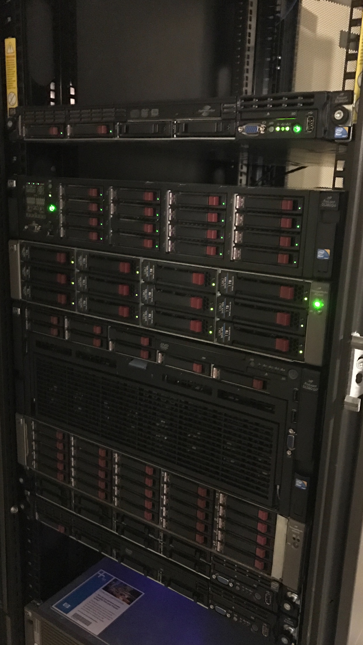

  14. Picked up a dl360e gen8 for some pfsense passthrough, but having some issues with its iommu groups and not working. Have tried the stub and vfio-pci.ids, with vfio_iommu_type1.allow_unsafe_interrupts=1 - neither has worked. I think its a 2014 bios and didn't see a newer one that I could get in the 2017 updates .... passing through a hp NC364T intel 4 port. Do you have any experience with it, or would a dell branded Broadcom work any differently ? Was trying on my 360 g6 but was running into rmrr issues even with a pre 2012 bios .. gave up and got this gen 8, which is great, but would be better if the network card worked ... IOMMU group 25 [111d:8018] 09:02.0 PCI bridge: Integrated Device Technology, Inc. [IDT] PES12N3A PCI Express Switch (rev 0e) [8086:10bc] 0a:00.0 Ethernet controller: Intel Corporation 82571EB Gigabit Ethernet Controller (Copper) (rev 06) [8086:10bc] 0a:00.1 Ethernet controller: Intel Corporation 82571EB Gigabit Ethernet Controller (Copper) (rev 06) IOMMU group 26 [111d:8018] 09:04.0 PCI bridge: Integrated Device Technology, Inc. [IDT] PES12N3A PCI Express Switch (rev 0e) [8086:10bc] 0b:00.0 Ethernet controller: Intel Corporation 82571EB Gigabit Ethernet Controller (Copper) (rev 06) [8086:10bc] 0b:00.1 Ethernet controller: Intel Corporation 82571EB Gigabit Ethernet Controller (Copper) (rev 06)
