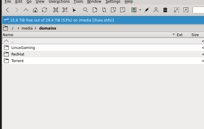

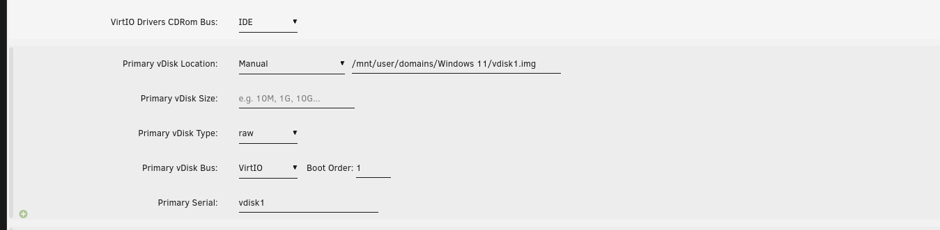

So my unraid is being really buggy and it seems to freeze for like 10 secs at a time and I have no clue what it could be. So a few things I just moved to a new place so I phyically moved my server, I really hope nothing was damaged as part of this My parity failed and my i fucked up the recovery so I lost that One drive failed, which I just did made a new config and just removed it because i thought that was causing the error One of my VM is pointing at a file which i can't find but it can still access The VM still runs and everything but i just can't seem to find the file I hope I really didn't fuck my the system that bad with this. tower-diagnostics-20241014-1202.zip

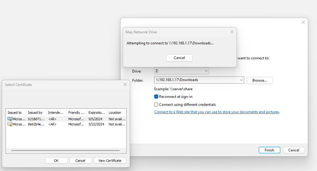

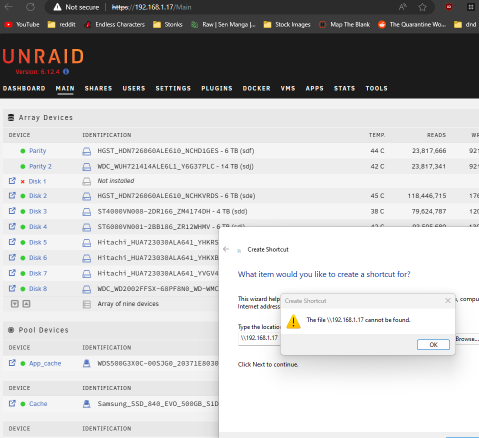

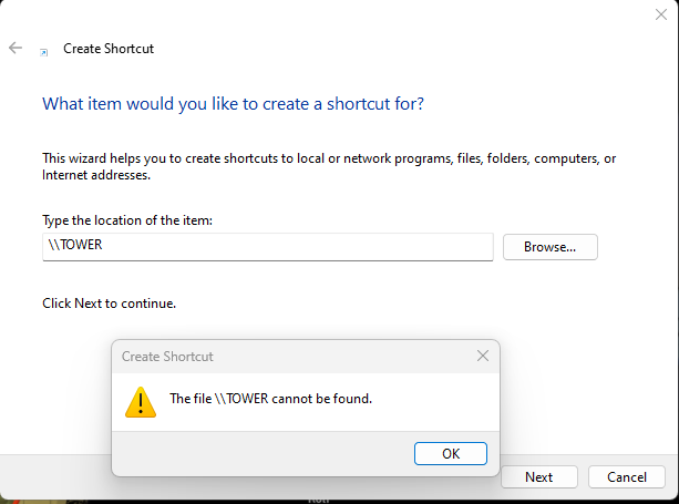

After changing usb due to corruption, I can't connect to my SMB shares
So I created a back up of the current usb and i reinstalled unraid on it, setup alot of the setting once again and i was able to connect the old way using \\tower\rootshare. So i am guessing something bonked a setting when my usb got corrupted

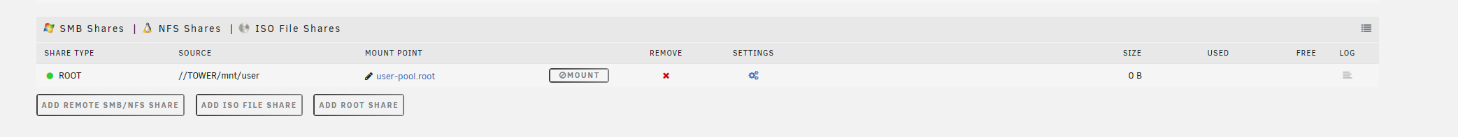

Sorry i thought i replied you earlier, but by accessible do you mean by the server itself or by me? Any docker container seems to have access to files, aka plex. I can't access the shares with my windows computer I have tried the ipaddress sharename but i don't think it was working either, I can try again once I am home. I tried to access the share using a different computer as well but with no luck.
Could it possibly be the USB at this point? after my usb drive said it fail, i made a backup and copied that to another usb
I assume this is what you are talking about, I have tried setting it up but still cannot access it. Imma give this a look tonight and see if i can solve it this way. For the USB, I have multiple different ones crash or corrupt over the year. and each time i have backup and upload the files on the a new usb

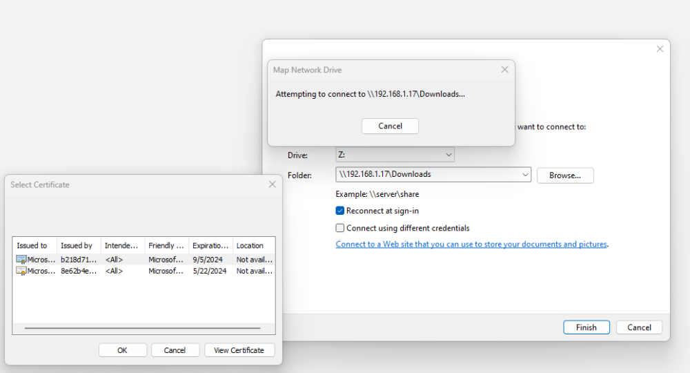

Ill try to delete them tonight when I have a bit more time, i have never touched any files on the flash drive so i hope i don't do anything wrong So here is the error i get when i try to access the folder i usually have it mapped to my z drive as a network drive, if that makes any sense. I have also tried to make a user and accessing that way, i get the same error as above
