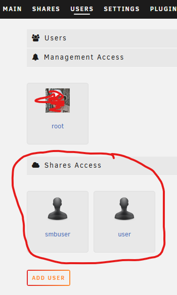

Another thing to look at is this:
Make that the Share Access user(s) have the proper credentials.  (Unfortunately, Unraid can not display the actual password as it is encypted by a hashing function.)  You can check that everything else is correct by editing the user(s).  (Myself, I would change the password for the user since I can't check that it was not corrupted when the USB drive failed.)

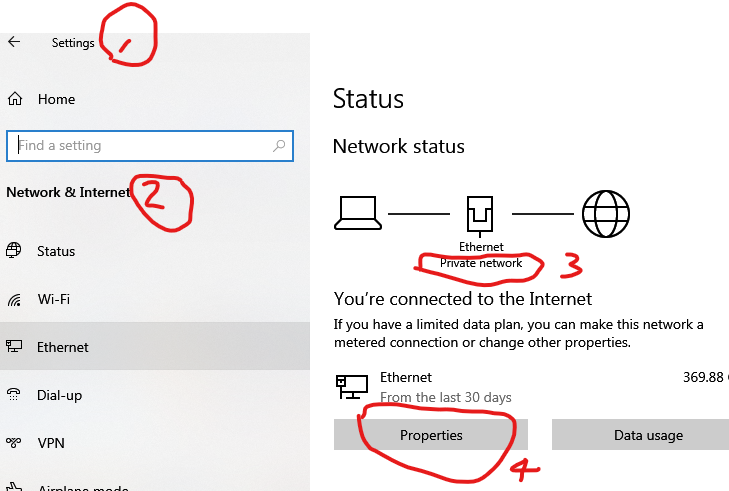

Also make sure that your Win11 computer is setup to be on a Private network.  The steps to do are shown below:
Steps 1 & 2 will get to the place where you can check.  Step 3 shows the setting you want.  Use step 4 to make a change if required.
