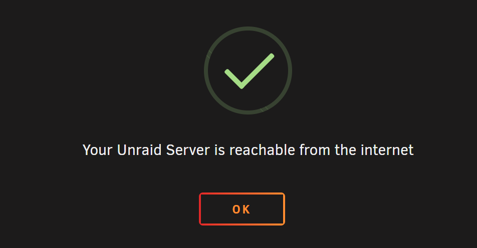

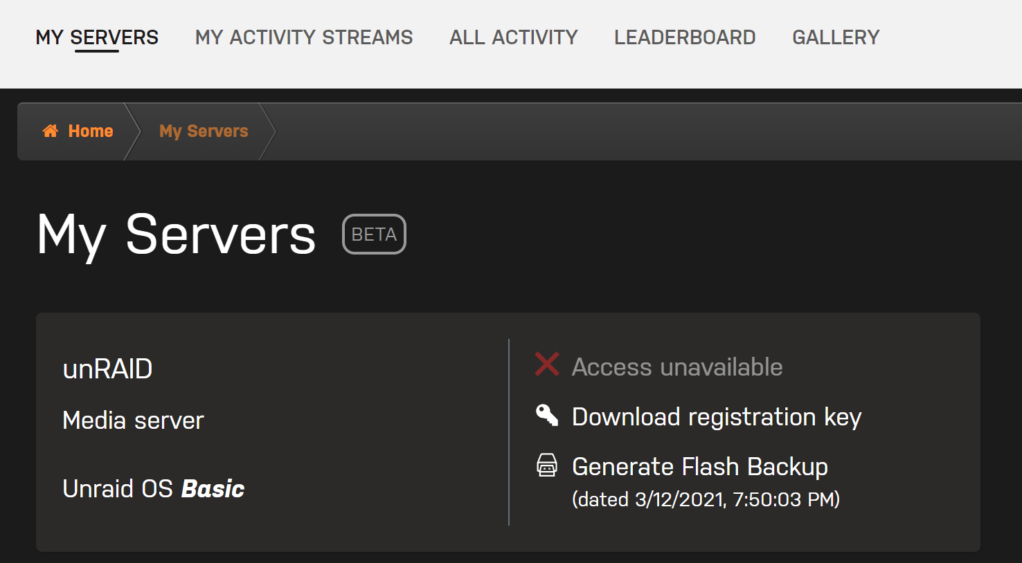

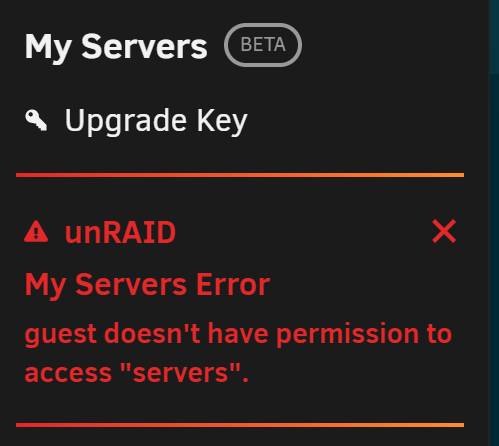

  5. I followed the guide and ran into some errors. Port forwarding is working and showing it is accessible from internet but get Guest doesn't have permission to access "servers". I am logged in as root and root has a password. I have a Let's Encrypt cert. Not sure what else to check. Here are some screenshots. Let me know what additional info you need or any ideas how to fix this. Thanks, Jason
