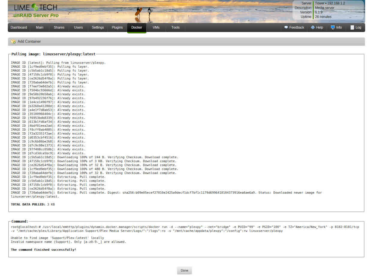

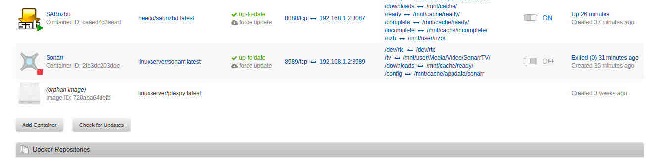

  7. As you can see installation went well, but now there is also orphan image of plexpy that was not there before. I created today new docker image on cache drive. So it cannot be 3 weeks old.
  8. I'm not sure what is going on. When I install this docker everything seems to be OK. I do get success message, but plexpy is not showing up in docker container list. It looks like is not installed at all.
