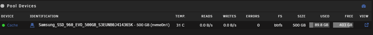

Problem solved removing the c.a. mover plugin did do the trick. after the night cache is empty and files are on the array

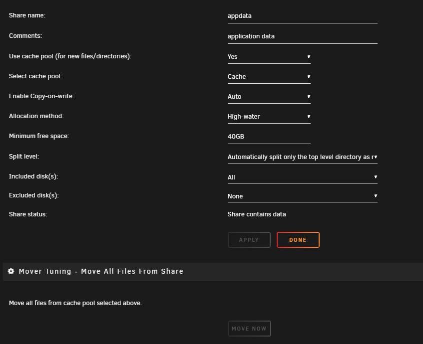

its all the files on the cache drive from appdata its complaining about ! regarding the mention about disks i looked at the /mnt/disk1 to 12 and the appdata files are not there. (ive found 4 from today ( the new files that were created as ive set the share to use cache no to test things out.) There were no other files on any of the disks SO: mover thinks the files ( all files from appdata share) it needs to move, already exists on the array. Which is not correct as ive checked every disk(1-12) for the files and they arent there . How can i convince the mover that he actually needs to copy the files to the array p.s. ive looked at /mnt aswell and ive noticed there is a /mnt/user and a /mnt/user0 with different contents is this normal ?- Solved : Unable to get mover to actually move 400 GB plus from cache to array

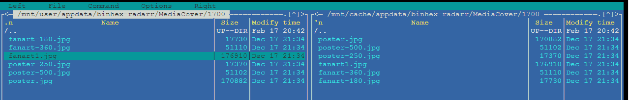

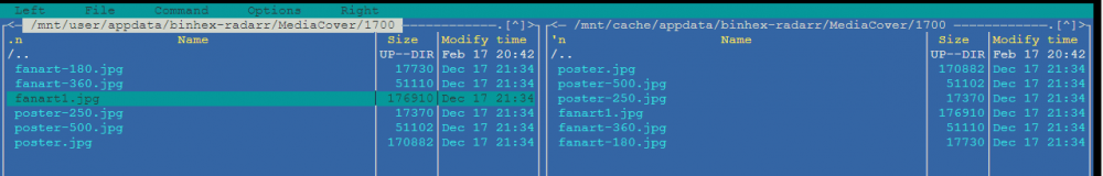

2 things a: it tells me ALL the files from share appdata already exists from the appdata subdir. the mover also moves other shares from cache. and does a splendid job I tried to rename a file in the destination from the appdata share ( before the mover got to that file) to look in the logfile what he was going to do with it. ( /mnt/user/appdata) i renamed 1 file .fanart.jpg to fanart1.jpg. as you can see the right (cache) is renamed aswell. so removing files from /mnt/user/appdata also renames it in cache. Therefor im not renaming/deleting anything . as i could lose it all- Solved : Unable to get mover to actually move 400 GB plus from cache to array

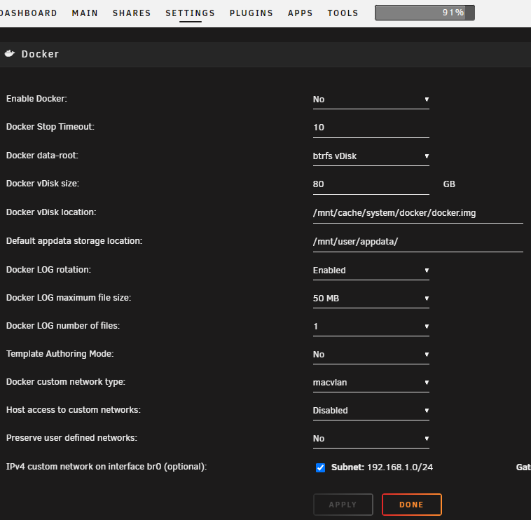

the dockers are crypto related and the databases are on the cache. They tend to be very large. ive got no idea on the speed impact and want to test that. But as the data isnt moving from cache to array im not able to test that. docker service and VM's are off. Open files cant be the problem. Your saying it might be some other problem... like ?- Solved : Unable to get mover to actually move 400 GB plus from cache to array

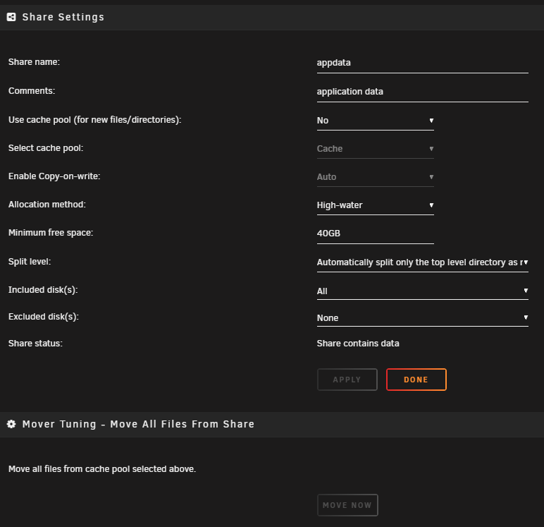

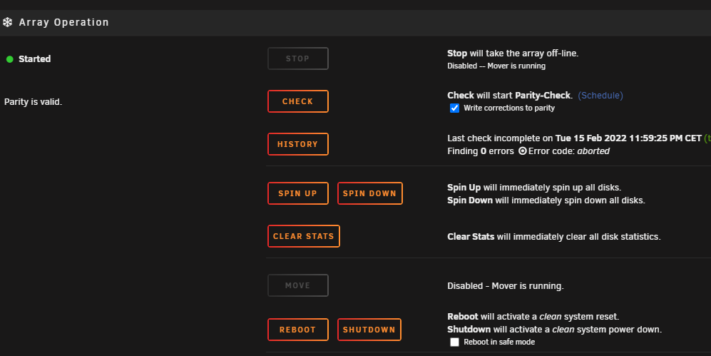

Hi itimpi, i tried several settings even the yes . the mover button is clickable but its actually doing noting. there are no writes to the array. and after 10-15 minutes its clickable again with no result and the drive still as full as it was.- Solved : Unable to get mover to actually move 400 GB plus from cache to array

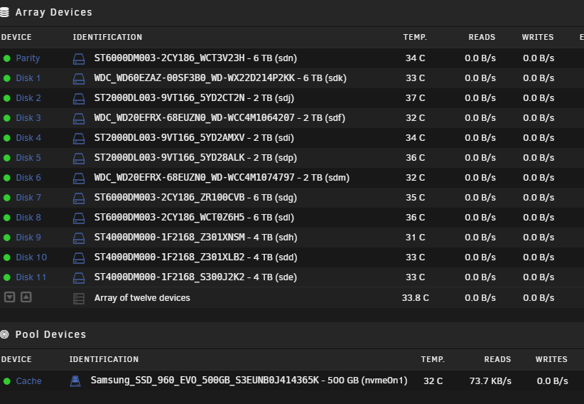

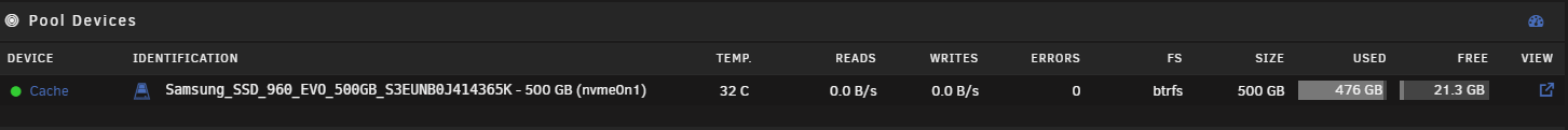

Hello all, im unable to get the mover to move all of my appdata ( dockerstuf etc) to the array. Cache drive is about 480 GB and 460 GB is filled . I know my docker image is on the cache and that only 80 Gb so thats not a prob. But i want to get to the array with only new files on the cache drive so it still will be quick and responsive while old data may be on the array. i tried several share settings for the appdata but mover wont move those files. I did move files from other shares Any idea where to start as ive tried all the different setting the data just wont move. The dockers i installed all point to /mnt/user/appdata share and not the /mnt/cache/appdata foxie4-diagnostics-20220218-1235.zipdr_dre started following random crashes with 6.10.0 rc1- random crashes with 6.10.0 rc1
