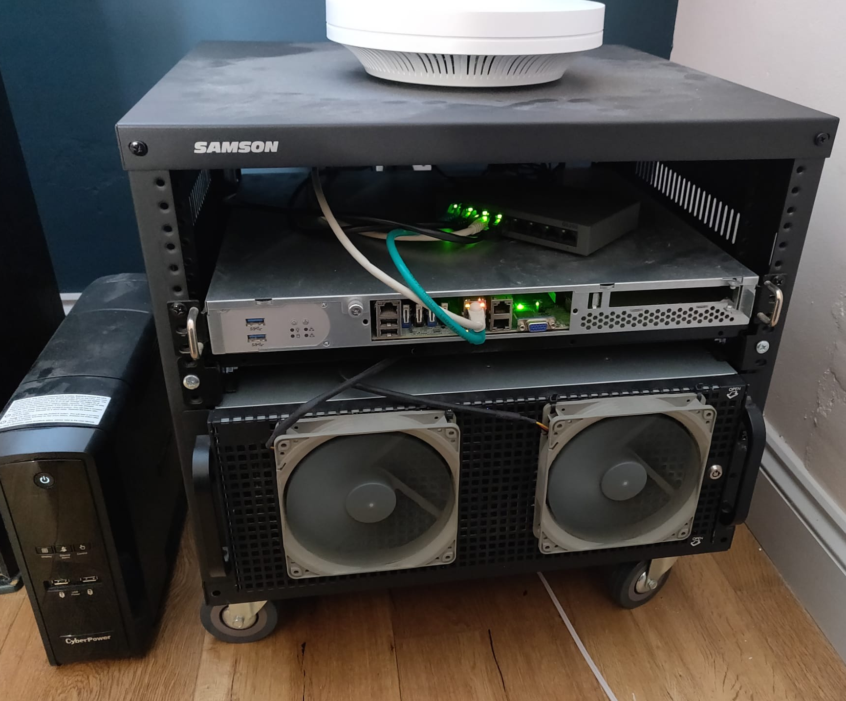

  1. I liked that original case. It just lacked internal cooling haha It did look funny though with the fans cable tied to the front. Worked though. 😂

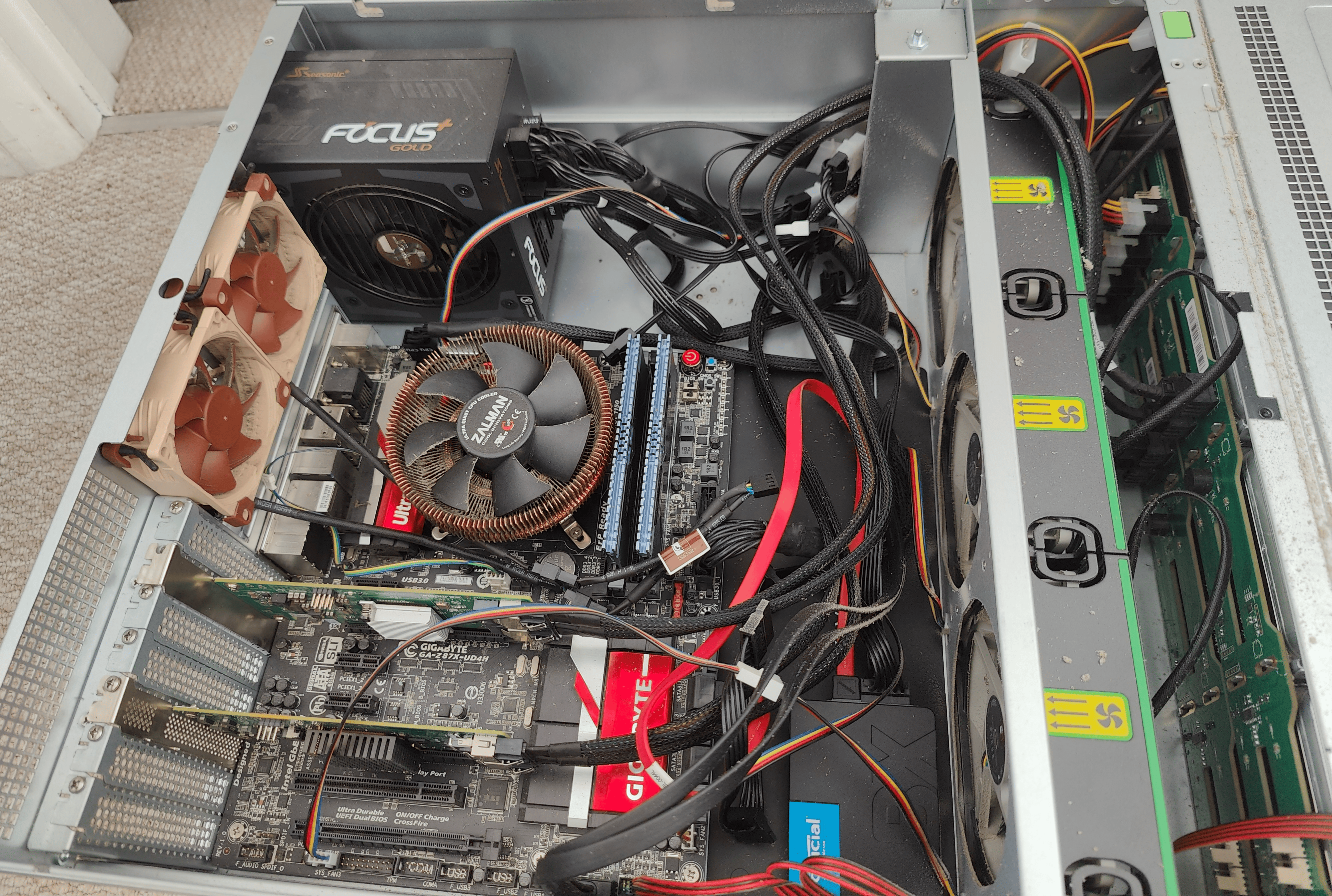

  3. I think it is sata power as I remember buying a new 12v atx cable for the PSU with sata connections but I will take a photo and check next time I open.

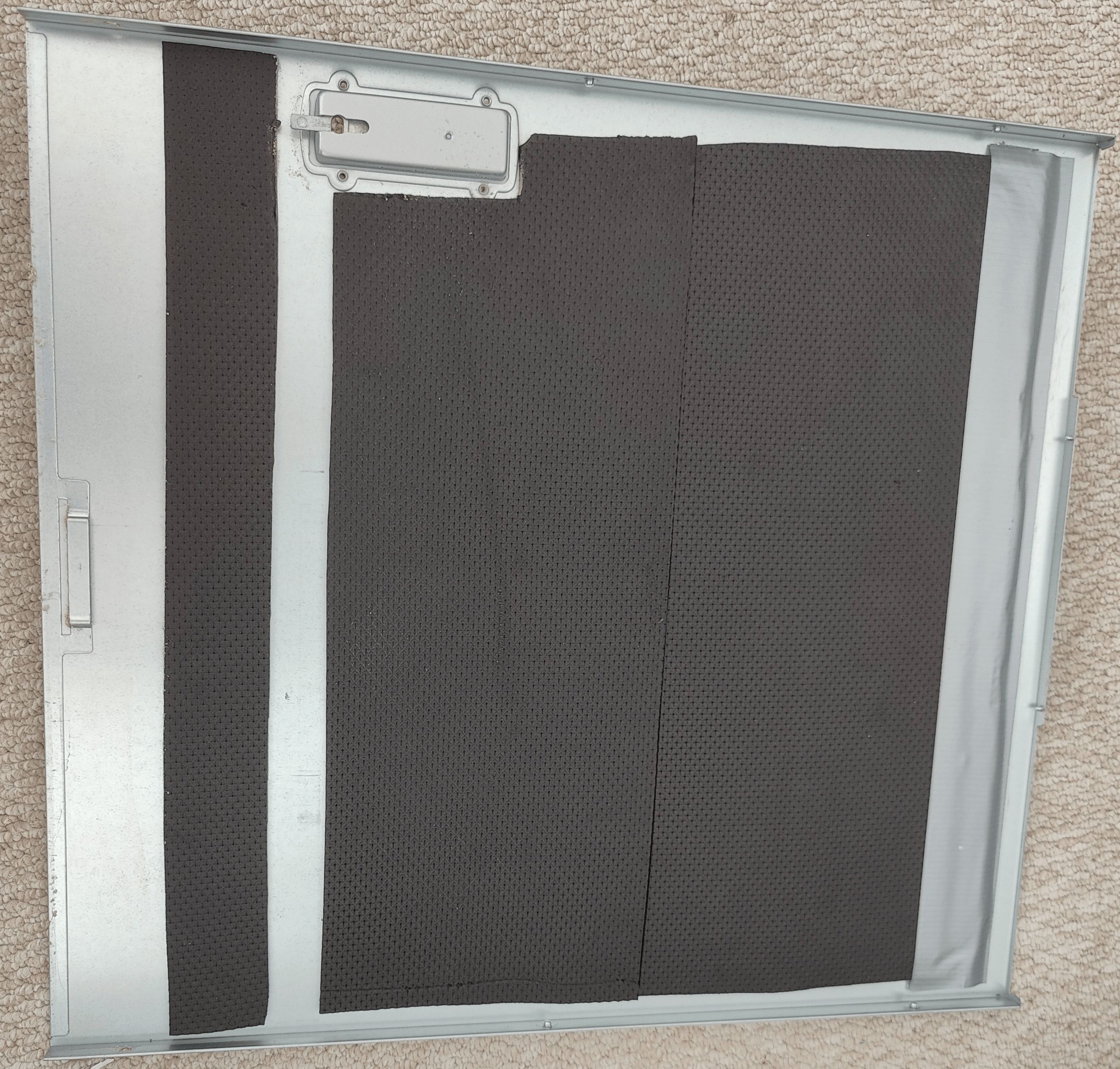

  4. Next time I open the case, I will take a photo. I just put them in to the housing and then used those rubber caskets to hold it in to place, it was a bit tricky putting them in but doable. Then the wire went in to the socket and they were still hot swappable. I am not sure i bought the correct fans, they do run moderately quiet as they are in my living room after I set them at around 900rpm but I feel a different type of fan could have achieved a quieter sound but this motherboard is limited on its fan voltage configuration so I ended up using the software one but that is temperamental. In the end I get very cold temps like 30-34 and can still watch TV with it being there. The only major down side still is the size, as for my tiny rack it sticks out too much at the back. I also bought this sound dampening sticky pads from amazon and put those on the inside of the case where reasonable and that has helped a lot as well.

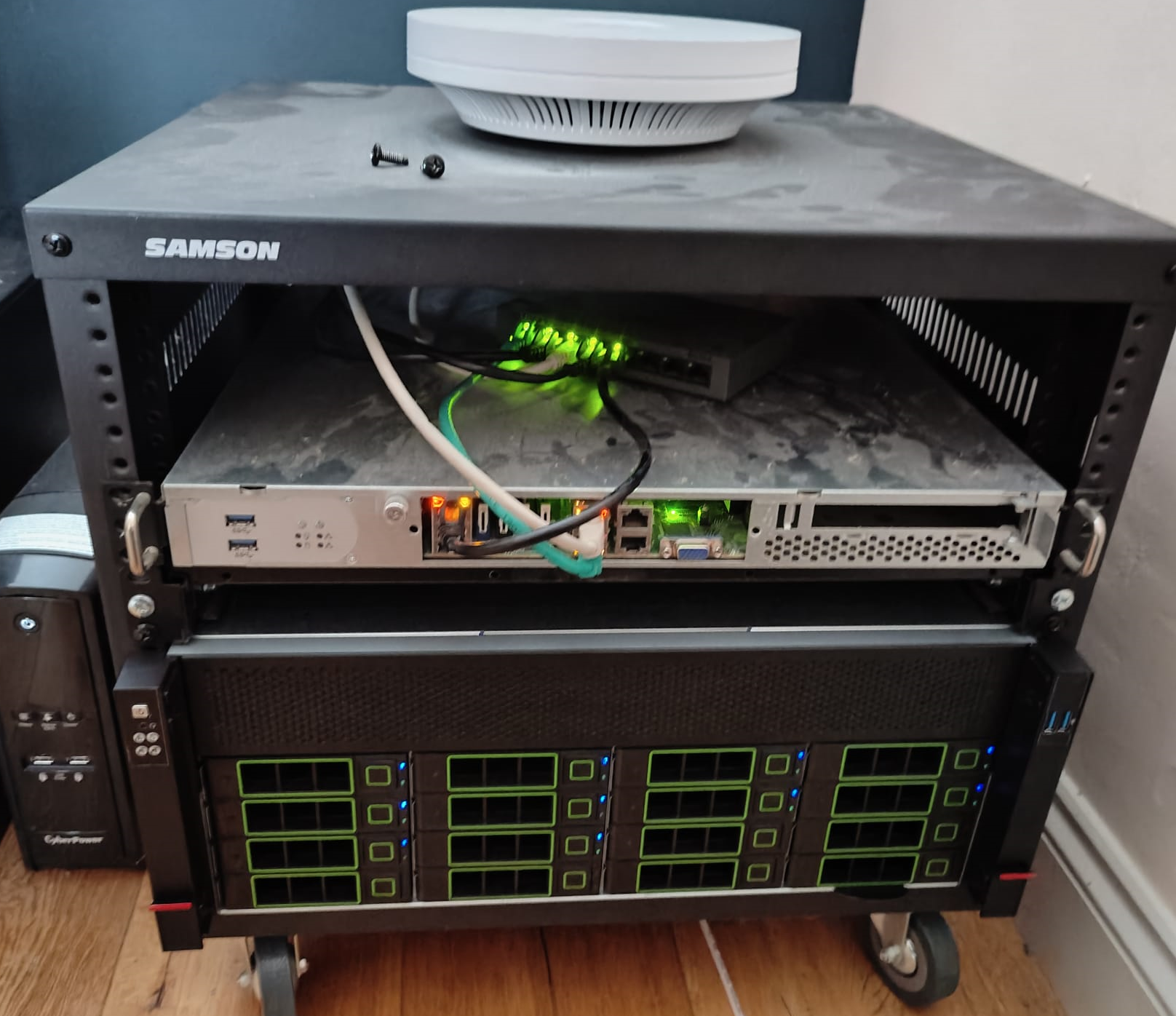

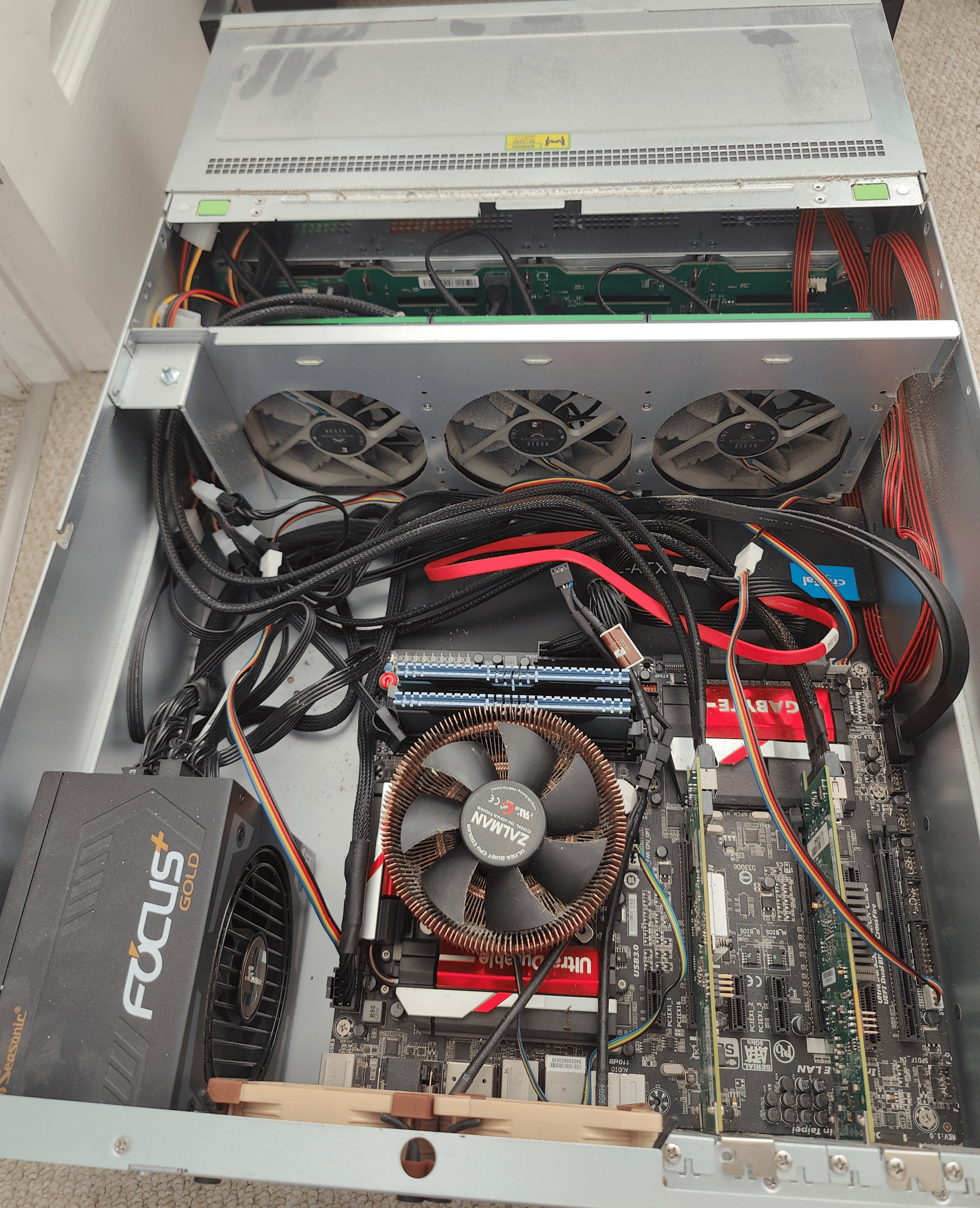

  5. 2024 update Total 66TB now. I bought the new Logic Case LC-4680-16B-WH 4U it has 16 hot swap bays and 12gbit hba support. I use two HBA cards in IT mode now and still using the same sea sonic 550w PSU and same UPS. I removed the existing 120mm fans from the case because they were way too noisy and at full RPM they went to 4000 RPM haha. That is like a datacentre cooling. Not for me, I am looking for silent as possible. I installed 3x 1700rpm Noctua 4pin and set the fan speed to max out at about 1000rpm. They are pretty quiet, I also bought some 4mm rubber adhesive to sound proof the case. I closed up the top front and side vents and put the sound proofing on the top. This is so that the air is pulled through the drive cages from outside. It has reduced the temps down and now I am idling at low 30s c temps which is better than my old case. The only other main downside to the case design is the depth, it sticks out the back of my small rack 20cm, this is mainly because they give support for extended ATX and the over sized fans. I think they could cut it down by 10cm or more by changing fans and no e-atx support. Other than the case is a lot higher quality than the previous generation, in terms of sharp edges, the closing mechanism and the hot swap drive quality. Also would have been nice to have some screw holes in the back of the case for a ssd or two. The hot swap bays also don't adapt to support SSD which is a shame because they could easily do that. 150-170w on idle now. Unraid Logic Case LC-4680-16B-WH 4U Gigabyte GA-Z87X-UD4H Intel 4670k 3.8ghz 8GB corsair unbuffered PCI-e 8x SilverStone ECS04 PCI-e 8x SAS 2308 3x 12TB SEAGATE 7x 6TB SEAGATE 550W Seasonic Focus Gold PSU 3x 120mm fan 1x 512gb cache drive Pfsense in-Win IW-RF100 Supermicro A2SDi-4C-HLN4F 4gb 2133mhz Unbuffered new Seasonic 1u psu 60gb SSD TPLINK EAP660HD 8 port netgear switch UPS Cyberpower 780w Future New NAS mb and cpu will be the gigabyte X570S AERO G and rysen 9 5900x. Once I upgrade my desktop PC. Also looking in to moving to 10gigabit internal lan.

  11. Is there any way to make the files while they are still on the cache writeable? If I download something and then want to remove it, I can't delete it until it has been synced to the main array. Is there a way to change the permissions on the cache drive so that I can delete through SMB?
  12. 2023 update on my build Unraid Logic Case SC-43400-8HS Gigabyte GA-Z87X-UD4H Intel 4670k 3.8ghz 8GB corsair unbuffered 8 Port SilverStone ECS04 3x 12TB SEAGATE 5x 6TB SEAGATE 550W Seasonic Focus Gold PSU 2x 140mm fan 1x 512gb cache drive Pfsense in-Win IW-RF100 Supermicro A2SDi-4C-HLN4F 4gb 2133mhz Unbuffered 60gb SSD TPLINK EAP660HD 8 port netgear switch UPS Cyberpower 780w Interesting to see the entire setup including another windows media pc, vero 4k, my LG CX and the unraid nas only uses 110watts at idle.

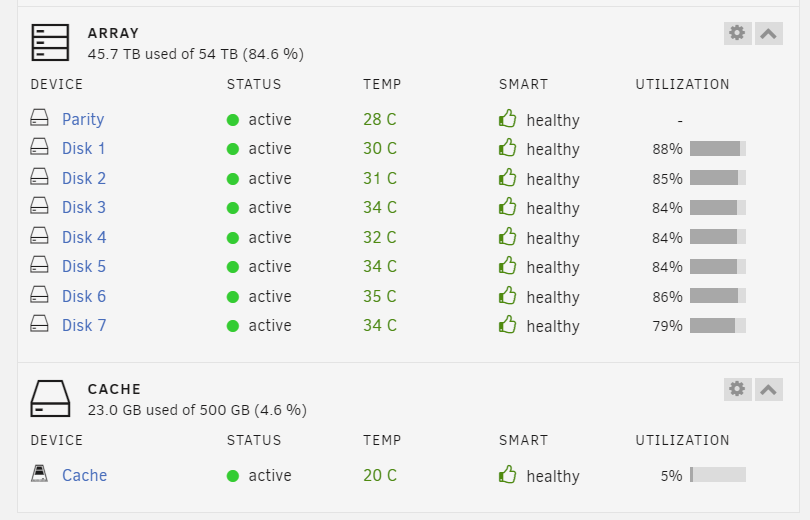

  13. I finally bought a 512gb SSD for a cache drive cost me £25 and I couldn't believe how much it allowed for my main array to not be spun up and reduced disk temperatures of the array overall.
