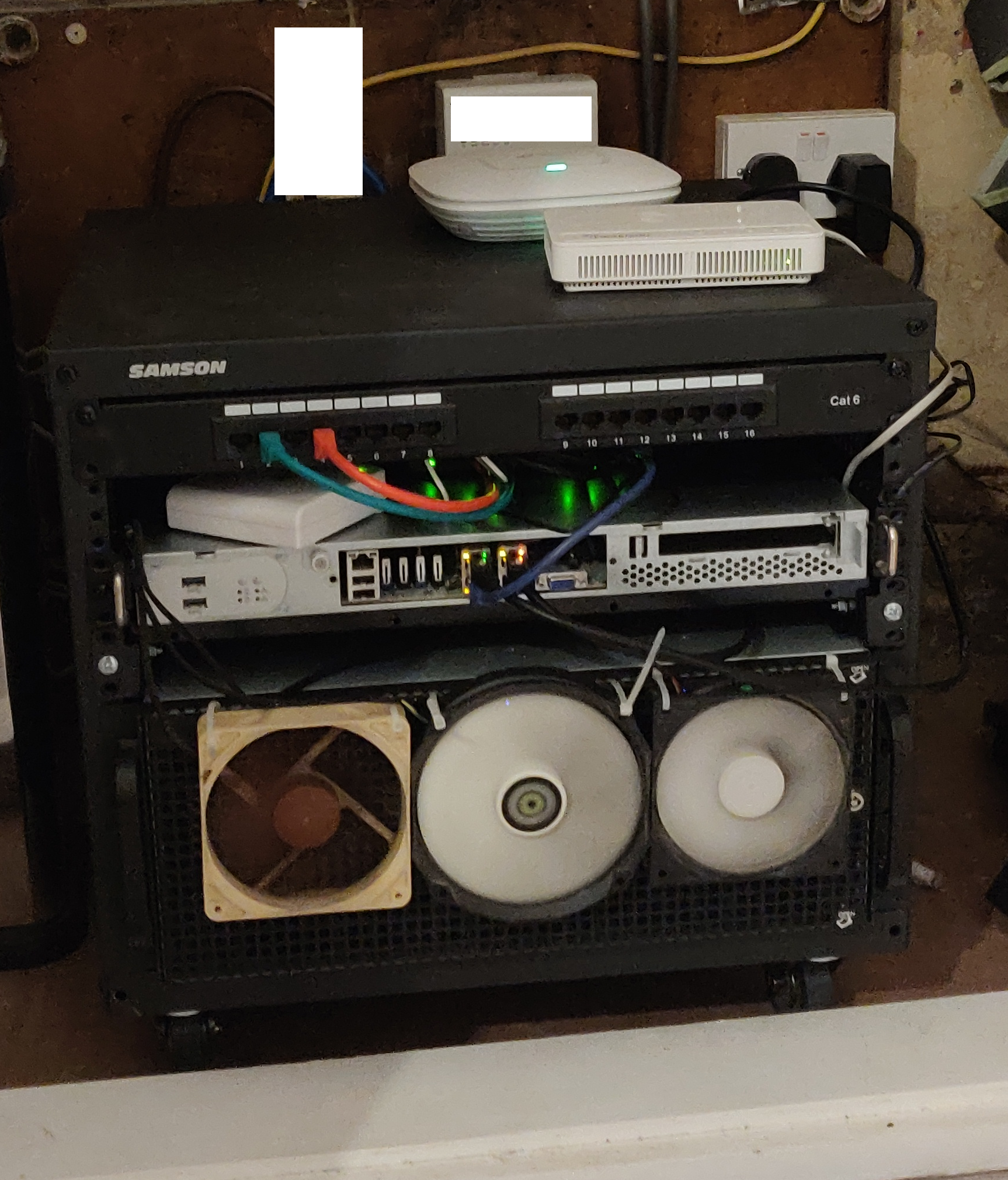

  23. I did post about my build buying decisions back in 2018. I have since bought a rack, so I thought I would share a photo and current specs. Unraid Logic Case SC-43400-8HS Gigabyte GA-Z87X-UD4H Intel 4670k 3.8ghz 8GB corsair unbuffered 8 Port SilverStone ECS04 7x 6TB Seagate ST6000VN0033 1x 4TB WD 550W Seasonic Focus Gold PSU 2x 80mm back Noctua Fans for Case 2x 120mm front fan 1x 140mm front fan Pfsense in-Win IW-RF100 Supermicro A2SDi-4C-HLN4F 4gb 2133mhz Unbuffered 60gb SSD TP-LINK CAP1750 WAP 8 port netgear switch Vero 4k for media center To solve the heating issues in the Logic Case I had to cable tie fans to the front of the case on the dust filter. It solved the temp issue completely. Unfortunately it does not look very good, I need to buy some fan guards and maybe matching 120mm FANs would look better. I bought a very good short throw rack from Amazon Samson brand, it was only £90 delivered. If you have any questions let me know.
