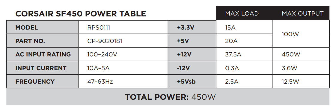

  3. Thank you. The drive *was* in a parity protected array, but after I replaced one of the other disks, I got loads of errors on the troublesome disk as well as the parity disk. Believing this to be possible disk issues I actually ended up zeroing the parity drive and starting again, so I think the parity question is well out of the window now. The disk is not in the server at all, in fact I don't think unraid even detects it any more. The power supply is a Corsair SF450, this is the spec from the manual:
  4. Thank you, I gave this a try and it actually worked perfectly! Since reconfiguring the power supply, I haven't had any read errors on any disks, and no bad noises from any of them, so I think that issue is solved thankfully. Can't believe I made such a rookie mistake, but I also didn't expect that HDDs use masses of power (my system is mainly 5400rpm disks) and I never thought the power supply would have been struggling running them all on a single rail. One issue that remains is that I think one disk has possibly gone faulty as a result. I have over 5TB of data on this disk which while not critical, would be nice to recover if possible. Unraid doesn't even detect the disk any more, although it does show up in POST when the server boots. I put it in a USB caddy and connected it to a laptop and booted Partition Magic and it correctly detects it as a 6TB disk although with an unknown file system etc. Is there anything I can do to possibly recover the files from this or is it toast? It's still well within warranty but I'd like to try getting my data off before sending it back.
  5. OK never really thought of this...I just checked the server and yes all 10 3.5" HDD plus two 2.5" SSD and a couple of case fans are all running off the same cable from the PSU. It is a micro PSU (can't fit a full size one in this case as it blocks some drives) and it only has two 6-pin connectors on the power supply. I've moved 4 of the HDDs onto another cable to see if it makes a difference.
