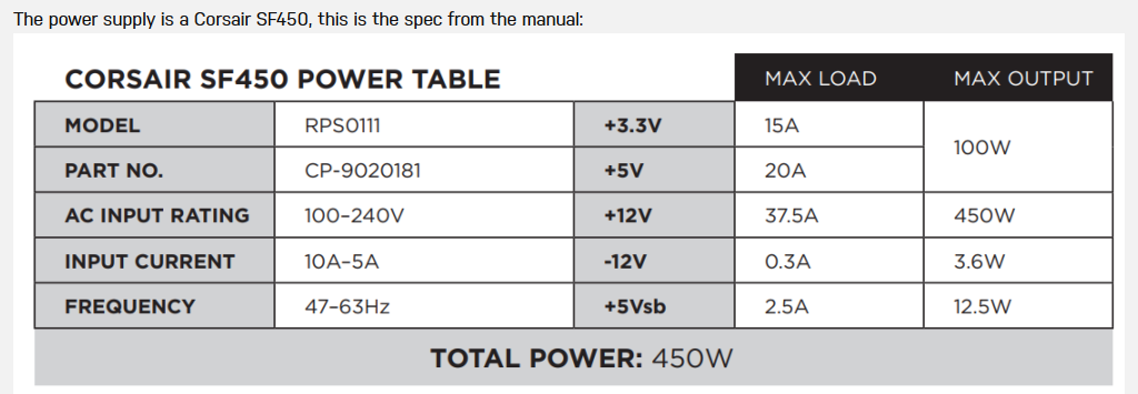

The power supply is a Corsair SF450, this is the spec from the manual:
I looked up the WD Red Plus 6TB drives and it appears that it draws 1.75A (max).  (This usually only occurs as the drive spins up.  Unraid actually does this quite often during Parity operations.)  So it looks like you are have to allow for 210W on the +12V rail out of the 450W max for the entire PS.  (Note that the max wattage for the +12V rail is 450 watts.  IF you use all of that rating, the other rails will have to have zero wattage to keep the supply within its total Max Power Rating!  This type of specmanship rating scheme is actually quite common.)   The PS may be adequate if the CPU is not power hungry and you don't have a med-to-high end GPU.   The reason I am cautioning you is that the designers of PS have put circuits into them that will shut the PS down if any rating in that table is exceeded for a very few milliseconds.  (Think of it as pulling the plug out of the wall.)
