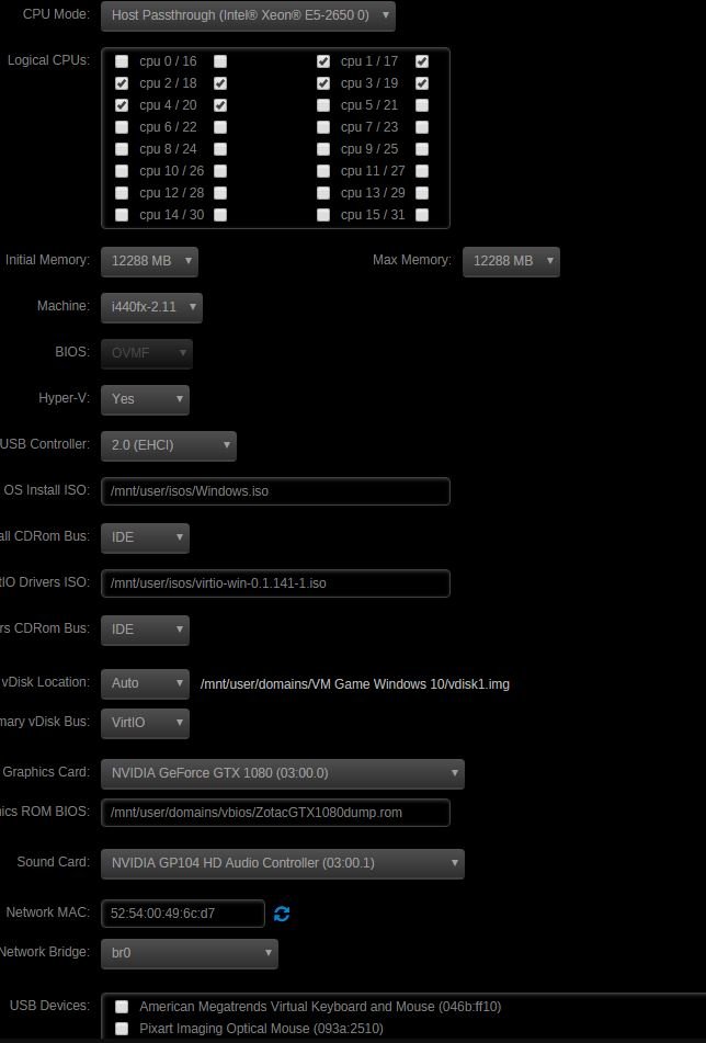

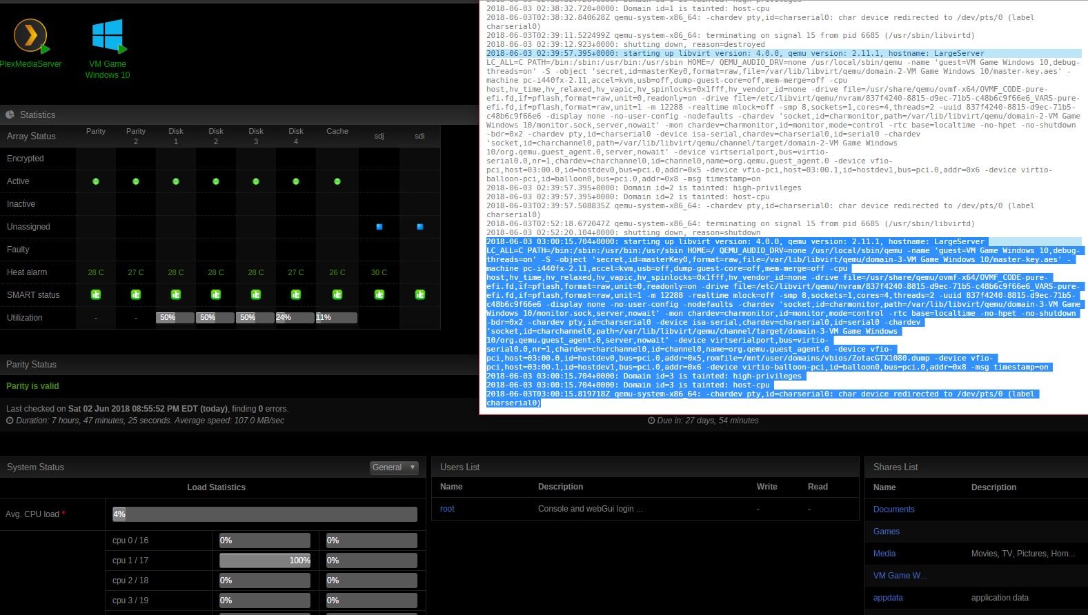

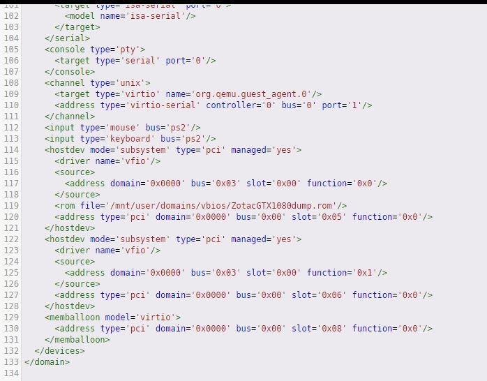

  3. First of thanks for these videos and walk throughs they have been a god send and up until the last step went with out a hitch but I have one Zotac GTX1080 mini that i want to pass through to the VM. The are no other graphics but the onboard in the system. But here is the issue now... when i add in the vbios file to either the xml or the GUI in the VM editor when i start the VM one of the cores goes to 100% and it just hangs there. i can pause but not stop the VM with out forcing it to stop. it is never accessable via either splash top or remote desktop connection. it essentially hangs at startup where i cant see it. I've changed physical location of the card from top to bottom pci express slot. renamed the hex edited vbios file from .dump to .rom. I'm scratching my head here. When i remove the vbios the VM will start up no problem. However it will be available via remote desktop but has issue in splashtop where it will let me log in but the screen goes black after i put in my password. I am using this unraid machine remotely. it is not hooked up to a monitor usually but is connected via the onboard VGA to a screen since i began trouble shooting. If i go back to VNC no GPU then of course everything works but that defeats the point as this is meant to be a "gaming" VM. I've attached pictures of the sytems hang up and the vm log at the time. xml and gui set up of the VM and vbios files. along with the last 2hrs of system logs during this. Please help... it may be the lack of sleep but I'm obviously missing something! Edit: with the benefit of sleep and hindsight.... I had just swapped out motherboards in this server/workstation combo because the previous boards didn't have the pci express slot to take a full sized graphics card. So my added question is would having created the VM on another mother board then affect its usage on another once applying the graphics card? Should i rebuild the VM? syslog.txt
