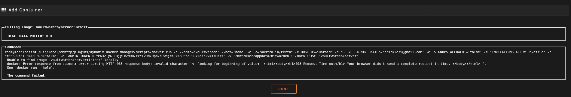

  5. I have been having problems with my dockers for a few days now and have hit a wall after trying to update some of them. when i tried to update my dockers it failed., i then tried to re-pull some and then they disappeared after failing to find image (screenshot attached). i tried deleting my docker img and recreating it and so far i have managed to get a couple of dockers to install but most have failed with the same error as in the attached screenshot. I have sucessfully reinstalled: lscr.io/linuxserver/mariadb lscr.io/linuxserver/nextcloud lscr.io/linuxserver/unifi-controller Following is some of the dockers that fail: binhex/arch-krusader binhex-qbittorrentvpn jlesage/nginx-proxy-manager vaultwarden/server flippinturt/pihole-dot-doh:latest I'm probably missing something simple and obvious but i'm at a loss. If anyone has an insight or advice it would be greatly appreciated
