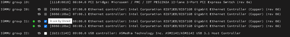

  12. Thanks, i tried what you suggested. Its still greyed out as shown in the screenshot. Also rebooted the host EDIT : Noticed that the devices also had bridging on, i think i was messing with that quite some time ago. Disabled that with the DHCP and now i can pass them through Thank you for the helping hand
  13. The NIC that is on the motherboard is the default network interface for unraid. installed the quad NIC last night again after removing it some time ago in the past im quite sure i was able to passthrough all 4 ports as you can see on the screenshot i posted there is a quad nic there and its allowing me to passthrough 2 of the 4 ports Some additional info. i had to turn on PCIe ACS override to split them into their own IOMMU groups
  14. Hey thanks for the reply. here are the diags as requested tower-diagnostics-20230329-1039.zip
