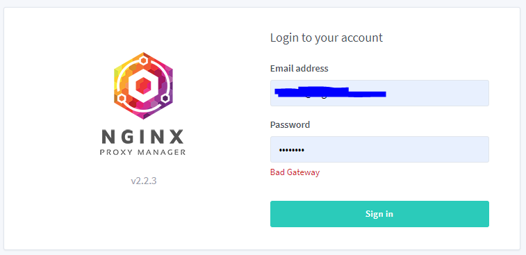

  16. Hi Guys, I'm having some issues recently, so after going thru reinstalling trying to downgrade to v1.70 etc, i finally resolve the issue by restoring my backup for appdata, the proxy host works now. However, i'm unable to log in to the gui it shows bad gateway I'm getting lots of errors in the logs. [4/20/2020] [5:49:29 PM] [Migrate ] › ℹ info Current database version: 20190227065017 [4/20/2020] [5:49:29 PM] [Migrate ] › ℹ info [access_list_client] Migrating Up... migration file "20200410143839_access_list_client.js" failed migration failed with error: create table `access_list_client` (`id` int unsigned not null auto_increment primary key, `created_on` datetime not null, `modified_on` datetime not null, `access_list_id` int unsigned not null, `address` varchar(255) not null, `directive` varchar(255) not null, `meta` json not null) - ER_TABLE_EXISTS_ERROR: Table 'access_list_client' already exists [4/20/2020] [5:49:29 PM] [Global ] › ✖ error create table `access_list_client` (`id` int unsigned not null auto_increment primary key, `created_on` datetime not null, `modified_on` datetime not null, `access_list_id` int unsigned not null, `address` varchar(255) not null, `directive` varchar(255) not null, `meta` json not null) - ER_TABLE_EXISTS_ERROR: Table 'access_list_client' already exists [4/20/2020] [5:49:30 PM] [Migrate ] › ℹ info Current database version: 20190227065017 [4/20/2020] [5:49:30 PM] [Migrate ] › ℹ info [access_list_client] Migrating Up... migration file "20200410143839_access_list_client.js" failed migration failed with error: create table `access_list_client` (`id` int unsigned not null auto_increment primary key, `created_on` datetime not null, `modified_on` datetime not null, `access_list_id` int unsigned not null, `address` varchar(255) not null, `directive` varchar(255) not null, `meta` json not null) - ER_TABLE_EXISTS_ERROR: Table 'access_list_client' already exists looks like something to do with access list, but i've not setup anything wif access list, any help will be appreciated. Sorry i'm kinda noob, i may need some help in collecting information for troubleshooting ****Edit****** Hi, I've manage to resolve the problems......
