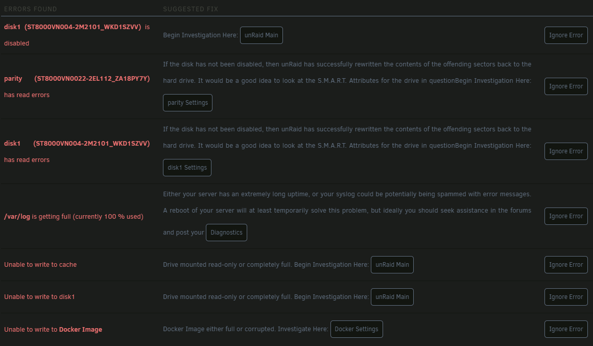

  5. I do, my phone went off immediately. I get messaged via telegram and love that feature. I hadn’t gone back and put eyes on fox common problems since I rebuilt the disc after installing the HBA.
  6. I'm starting to pull my hair out here. I went to check fix common problems this evening to see how things were looking and I got a disc error. elliot-diagnostics-20210915-1856.zip

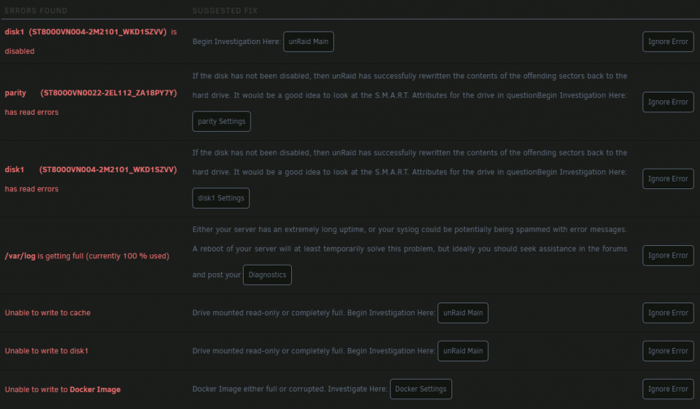

  9. Hi Jorge, I think you've helped me out in the past so thank you again! The add-on controller is definitely going to be the way to go for me at this point if my issue is the onboard SATA controller again. I don't want to get off topic but I have a few questions if you don't mind me posting them here. -Currently I'm using 6 SATA ports on my MOBO, 1 optical, 2 SSD (cache) and 3 HDD. Should I be looking to move all SATA devices to the add-on controller or just HDDs? -I've looked at the Unraid Hardware Compatibility doc quick and newegg but any recommendations on where to start researching SATA and or SAS controllers? I'm not looking for anyone else to do the work for me just any head start is appreciated. Thanks
  10. Diagnostics attached for reference. I've had some disk issues in the past that I've posted about and the answer has been to update the MOBO and keep Unraid up to date. It looks like there's a recent BIOS update for the board so I can do that but I wanted to post the diagnostics before that. Fix Common Problems Errors elliot-diagnostics-20210908-0944.zip
