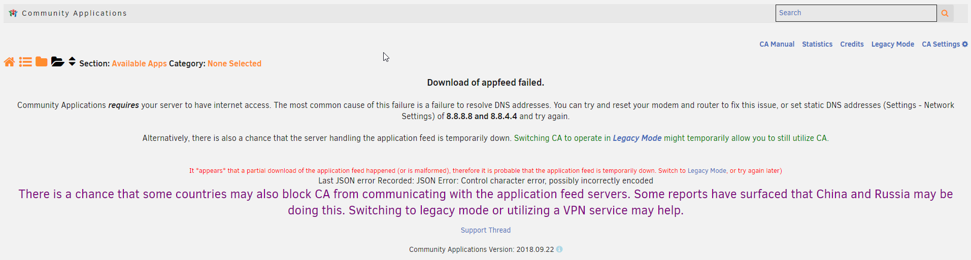

  10. Hello - I was curious if there is currently an issue with the CA feed. I noticed there is mention of some issues in the past few days, but not this one in particular. I do have my DNS settings pointed at 8.8.8.8 and 8.8.4.4. I've rebooted my server once as well. My server does have access to the internet, so is there a way I can determine if it is something on my end that changed (I don't think so) or if something elsewhere is currently down? EDIT: Currently (without any changes on my end) CA is now showing without error....
