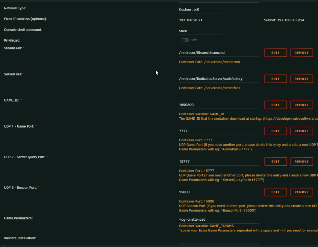

  11. First I want to say thank you for all the great game server docker you have created. I'm having trouble starting the Satisfactory server. I put my save file here "satisfactory/FactoryGame/Saved/" here is the config : and here are the logs: [2022.12.12-12.29.25:230][ 0]LogStreaming: Error: Couldn't find file for package /Game/FactoryGame/Schematics/Story/Schematic_ObjectScanner_WAT1 requested by async loading code. NameToLoad: /Game/FactoryGame/Schematics/Story/Schematic_ObjectScanner_WAT1 [2022.12.12-12.29.25:230][ 0]LogStreaming: Error: Found 1 dependent packages... [2022.12.12-12.29.25:230][ 0]LogStreaming: Error: /Game/FactoryGame/Prototype/WAT/Desc_WAT1 [2022.12.12-12.29.25:237][ 0]LogStreaming: Error: Couldn't find file for package /Game/FactoryGame/Schematics/Story/Schematic_ObjectScanner_WAT2 requested by async loading code. NameToLoad: /Game/FactoryGame/Schematics/Story/Schematic_ObjectScanner_WAT2 [2022.12.12-12.29.25:237][ 0]LogStreaming: Error: Found 1 dependent packages... [2022.12.12-12.29.25:237][ 0]LogStreaming: Error: /Game/FactoryGame/Prototype/WAT/Desc_WAT2 [2022.12.12-12.15.28:303][ 0]LogGenericPlatformMisc: Error: SetEnvironmentVar not implemented for this platform: SteamAppId = 526870 [2022.12.12-12.15.28:320][ 0]LogSteamShared: Warning: Steam Dedicated Server API failed to initialize. [2022.12.12-12.15.28:320][ 0]LogOnline: STEAM: [AppId: 0] Game Server API initialized 0 [2022.12.12-12.15.28:320][ 0]LogOnline: Warning: STEAM: Failed to initialize Steam, this could be due to a Steam server and client running on the same machine. Try running with -NOSTEAM on the cmdline to disable. [2022.12.12-12.15.28:320][ 0]LogOnline: Display: STEAM: OnlineSubsystemSteam::Shutdown() [2022.12.12-12.15.28:320][ 0]LogOnline: Warning: STEAM: Steam API failed to initialize! [2022.12.12-12.15.28:320][ 0]LogOnline: Display: STEAM: OnlineSubsystemSteam::Shutdown() [2022.12.12-12.15.28:324][ 0]LogServer: Bound Server Query Socket to address '0.0.0.0:15777' [2022.12.12-12.15.28:324][ 0]LogServer: Bound Server Query Socket to address '0.0.0.0:15777' [2022.12.12-12.15.28:326][ 0]LogGame: MaxNumBackupsaves: 25 [2022.12.12-12.15.28:326][ 0]LogInit: Display: Game Engine Initialized. [2022.12.12-12.15.28:326][ 0]LogNetVersion: Set ProjectVersion to ++FactoryGame+rel-early-access-CL-211116. Version Checksum will be recalculated on next use. [2022.12.12-12.15.28:326][ 0]LogConsoleResponse: Display: Can't switch to RHI thread mode when we are not running a multithreaded renderer. [2022.12.12-12.15.28:326][ 0]LogConsoleResponse: Display: RHIThread is disabled. [2022.12.12-12.15.28:327][ 0]LogInit: OnPostEngineInit has been broadcasted successfully. [2022.12.12-12.15.28:336][ 0]LogInit: Display: Starting Game. [2022.12.12-12.15.28:336][ 0]LogNet: Browse: /Game/FactoryGame/Map/DedicatedserverEntry?Name=Player And do i get the Session ID?
