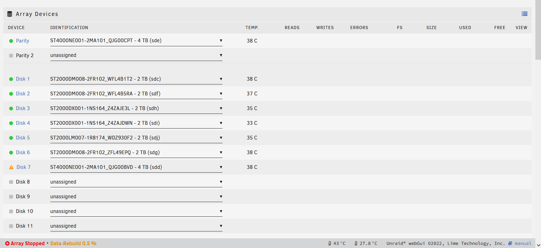

  9. Dear JorgeB, yes, I am using Firefox. I thought it would be the closest match to the browser Unraid's own GUI uses... How can I repair the filesystem on my unassigned drive? Should I follow the instructions to execute xfs_repair in the console? If so, is it enough to run xfs_repair -v /dev/sdb ? Thank you all again

  11. Dear moderators, I've finally replaced the psu and cables (apparently shipments to my region take a while). However, following the procedure to rebuild data on drive 7, I've found that the array won't start up but the data rebuild seems to be proceeding anyway. Is this behaviour normal? I remember that on my old Unraid version the data rebuild would begin immediately upon array start... Now I'm really confused. tower-diagnostics-20230403-2300.zip

  19. Thank you all for your replies. I've checked the cables and everything was absolutely fine in terms of physical connection. However. The SATA power connector was the last of a rail of 4. I'm not sure if this should affect its performance, but I went ahead and used another one from a different cable coming from my power supply. Now (fingers crossed) it seems that data rebuild has started. But the question is: could this really have been the problem? And why would this happen? tower-diagnostics-20230217-2120.zip

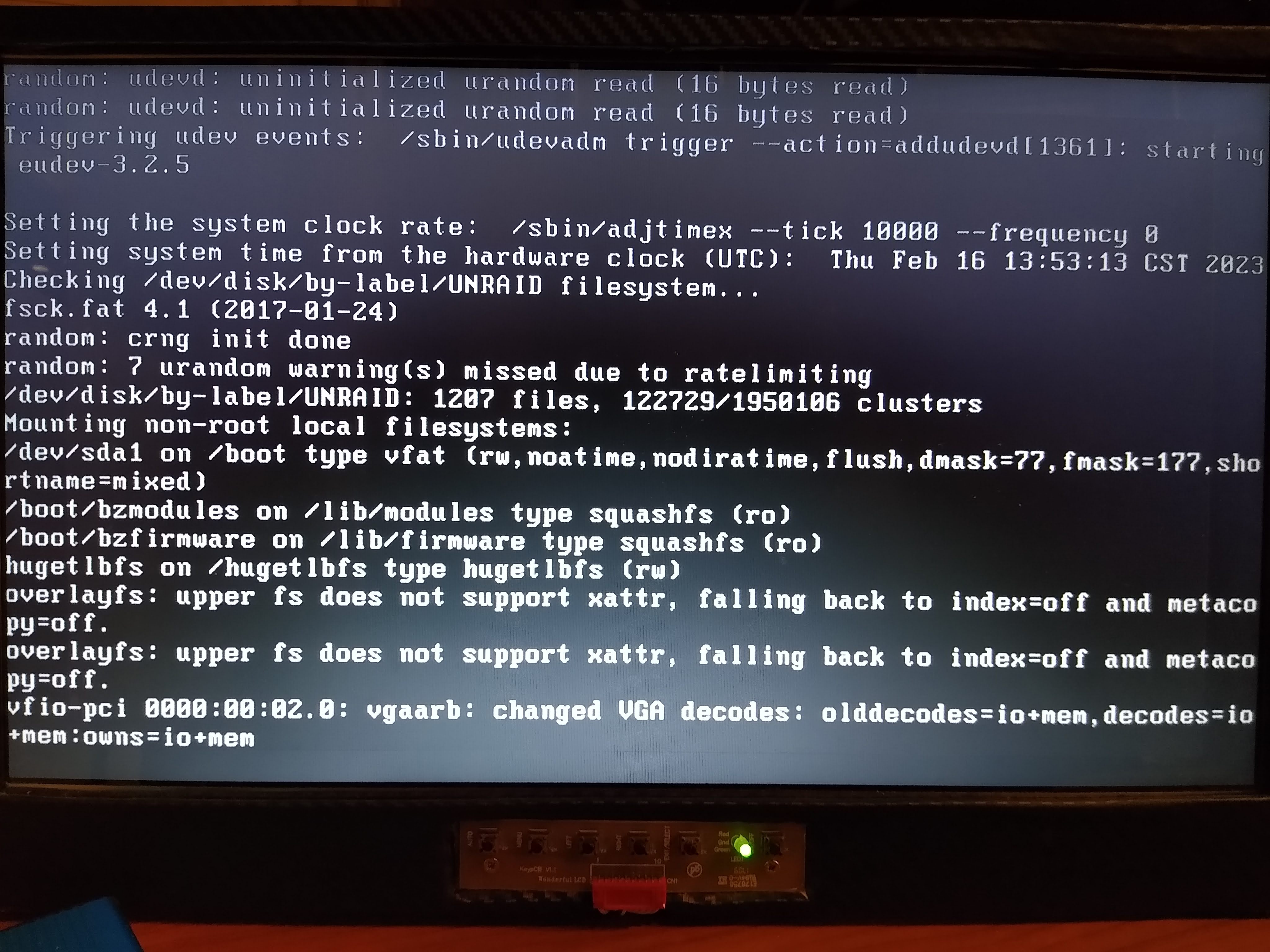

  24. I am now again able to access my server and after checking, it seems that one of the sata cables had indeed come loose (although I'm not 100% sure about that, it might just be from my poking into the system). However, upon rebooting the system freezes up: EDIT: Following the instructions on this link and renaming vfio-pci.cfg solved the issue but I still have an unmountable drive (disk 7) and a disabled one (disk 2, see diagnostics). What are the next steps going to be? Thank you all in advance! tower-diagnostics-20230216-2120.zip
