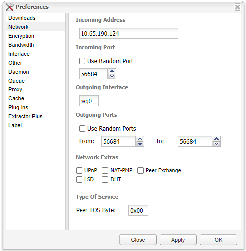

  3. I just tried to switch from rtorrent-vpn to deluge-vpn and am trying to use wireguard as I did with rtorrent-vpn. But I can't get it to work correctly, I can add a torrent and in the beginning it starts to download at around 30MiB/s (I am have a 1000/1000MB/s connection). But after a few seconds it goes down to a few KiB/s for a couple of minutes then again up to around 30MiB/s for a few seconds. So I can only download at a decent speed at a few seconds at a time. I did not have this problem with rtorrent, what can cause this problem ? I am using Wireguard and in rtorrent I had to add the opened wireguard port to the settingsfile in rtorrent under "listening ports" Where is the correct place to add this port in deluge ?
