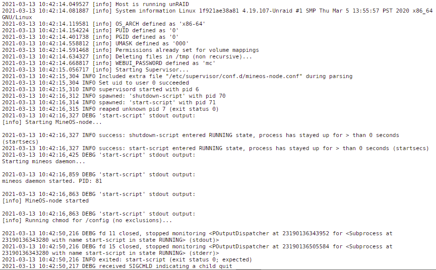

anybody else have an issue where the docker takes almost 20 minutes to finish loading so i can access the webui? The log will stay at this screen for 17-18 minutes or so before finishing booting, and any time i need to restart the docker it does the same thing. Eventually it finishes booting and the log looks like this (note the timestamps to see the delay):
