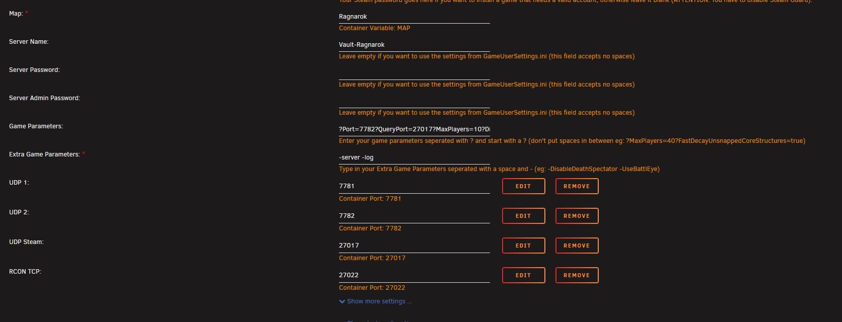

  11. That's the config file i couldn't find... Ill use the game params method. That's impressive! Ark is the only one that i am using so far, but considering how easy it was to setup the first time, ill definitely keep an eye out for any others i need that are authored by you. This should get me on my way until i can get someone to test outside connectivity. Thanks again! You and your work are amazing!!
  12. Yo dawg i heard you like folders so we put folders in your folders so you can have folders in your folders... Like that? 🤣 Yeah i was able to connect and play on both, But i am also using the assigned IPs and both using port 27015 Sorry for the circular conversation here.... Im irritating myself so i can only imagine how you're feeling right now... You mention "in the config" are you talking in the docker template in the UDP Steam variable or a separate config file? If i use the Game Parameters variable then the addition to it would look like this? "?Port=27015" (Without quotes ofc) (Most of the servers i have set up are edited all in a config file somewhere and dont have to communicate with steam I.E. Minecraft) I really do appreciate all the help here, if there was a way i could show my appreciation other than throwing trophies at your posts i would!
  13. Will this hurt anything? I like having the additional directory layer. I dont know if anyone outside the network will be able to connect, but somehow both servers are running right now, and i havent changed any settings in the router. Both servers are visible thru steam and ark. As far as the steam port goes, do i only need to change that in the docker settings or is there a .ini file somewhere with it as well? That is the 20715 port right?
  14. Thanks for the speedy reply!!! Im trying the custom network setting and seeing if that works with the server that has been running. I like that idea much better anyway. If i set the other servers up this way, what would my port forwarding look like? How would i forward the same port to multiple IPs? Or would they just stay the same? All ports forwarded to the main unraid server? Forgive me here, i have never used the custom network settings. The way this formatted in the post looks goofy, hopefully thats all thats wrong with it. This is the server that has been running /serverdata/steamcmd/ <> mnt/disks/SSD_500/SteamCMD/ /serverdata/serverfiles/ <> mnt/disks/SSD_500/SteamCMD/ArkSurvival/ArkSurvivalValguero This is the server that im trying to get to run /serverdata/steamcmd/ <> mnt/disks/SSD_500/SteamCMD/ /serverdata/serverfiles/ <> mnt/disks/SSD_500/SteamCMD/ArkSurvival/ArkSurvivalCrystalIsles
  15. Im also trying to make this work. So far i have setup another docker with the same SteamCMD directory and for the server files they are under SteamCMD/ArkSurvival/ArkSurvivalValguero/ -And- SteamCMD/ArkSurvival/ArkSurvivalCrystalIsles/, etc... I have setup new ports within the docker, Deleting UDP 1 and making a new one Using 7780 for UDP 2 Using 7779 for UDP 1 (this is the only one i deleted and remade) Using 27016 for UDP Steam Using 27021 for RCON TCP All the Container ports are set to the defaults, only changing the host ports as it looks like Unraid is assigning different internal IPs to the different dockers (Not sure if this is correct?) I changed the RCONPort in GameUserSettings.ini to match 27021 I cant seem to find any game settings file that holds the actual game port of 7777 or 7778 The server seems to start fine when looking at the logs and i can see it in the steam game browser, and the ark server browser but when i try to connect it times out. Not sure what i messed up here but i would appreciate any help you guys might have!
