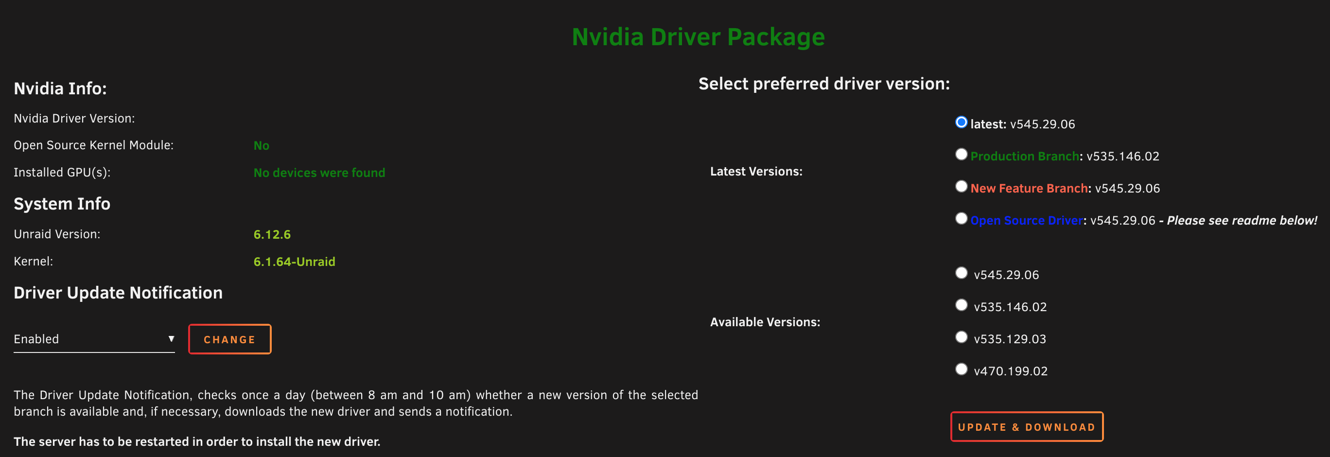

  4. I put in a different GTX 1060 and it was recognized instantly in the Nvidia Plugin. It was definitely a bad card. Thank you for your help!
  5. I tried it in another PC that has Windows 10 installed. The card doesn't work in that machine either. No video output. I think the card may be bad. I'll see if I can get it replaced and try again with a new card.
  6. I believe the card is supported as I've read posts and videos of people using a 1060 and a 1080 in my server HP z620. I upgraded the bios to the latest version today. I didn't see any options for 4g decoding or resizable bar in the bios. I did try changing a setting for 'Video Options Rom' from Legacy to EFI. That didn't seem to make a difference. The power supply is 800watts and should supply enough power. An older quadro card I had works in the pci slot and displays video output of unraid booting, etc..., so I know the pci slot is ok. I'm going to try the 1060 card in another PC I have to see if it works over there as I'm wondering if the card is bad.
  7. I also tried installing driver version 470 and unraid crashes as soon as I click on the plugin in settings.
  8. My Nvidia GTX 1060 card is not showing up in the Driver Plugin. I can see the card in System Devices, but in the plugin it says no devices were found. I do however see this error in the logs: Dec 21 14:11:15 Unraid kernel: nvidia_uvm: module uses symbols nvUvmInterfaceDisableAccessCntr from proprietary module nvidia, inheriting taint. Dec 21 14:11:15 Unraid kernel: nvidia-uvm: Loaded the UVM driver, major device number 239. Dec 21 14:11:16 Unraid kernel: NVRM: GPU 0000:05:00.0: RmInitAdapter failed! (0x24:0x72:1436) Dec 21 14:11:16 Unraid kernel: NVRM: GPU 0000:05:00.0: rm_init_adapter failed, device minor number 0 Dec 21 14:11:16 Unraid kernel: NVRM: GPU 0000:05:00.0: RmInitAdapter failed! (0x24:0x72:1436) Dec 21 14:11:16 Unraid kernel: NVRM: GPU 0000:05:00.0: rm_init_adapter failed, device minor number 0 I have read that sometimes that rminitadapter failed error could be related to power. I am using the 6pin Pcie power cable from my PSU. I have also tried a 15pin Sata power to 6pin pcie adapter and saw the same error. Attached are my diagnostics. Any suggestions? unraid-diagnostics-20231221-1417.zip
