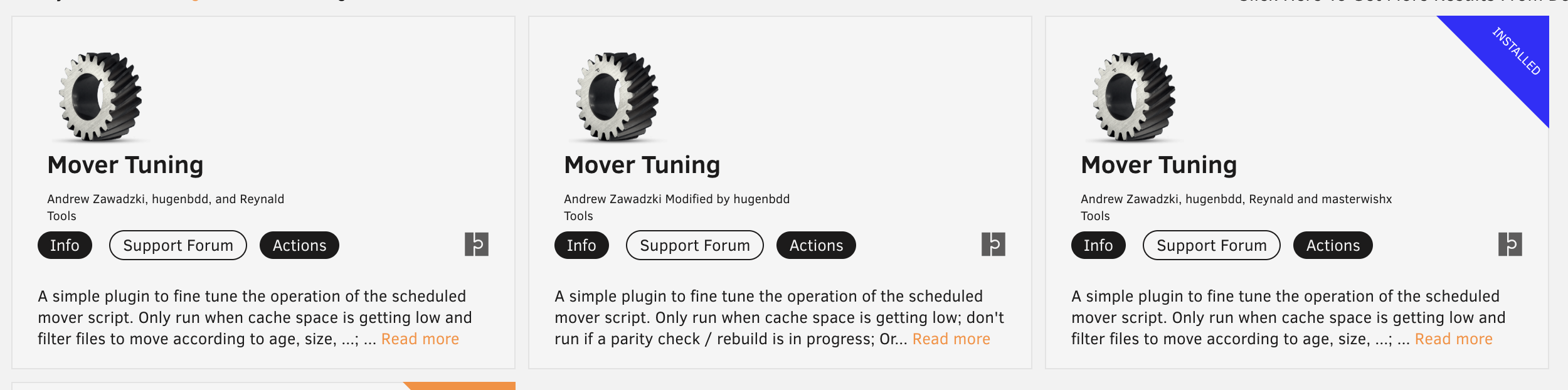

  2. Yes that would help. I feel like most aren't going to click into the info for each to determine what is the 'latest updated'. I didn't even know there was an update for example until I explicitly looked for it. Is the newest version of the plugin not compatible with older versions of UnRAID? Just curious as to why there are three different plugins that accomplish the same task?
  3. I will say...it is a bit confusing having 3 different versions without being able to really differentiate 'which' one you should be using.
  4. Just to confirm...I seem to have gotten it working. Removed plugin. Added the 2025.02.24 version of the plugin. Copied previous setup over. Seems to be working accordingly and is currently moving files. Will update in a few days if all keeps working.

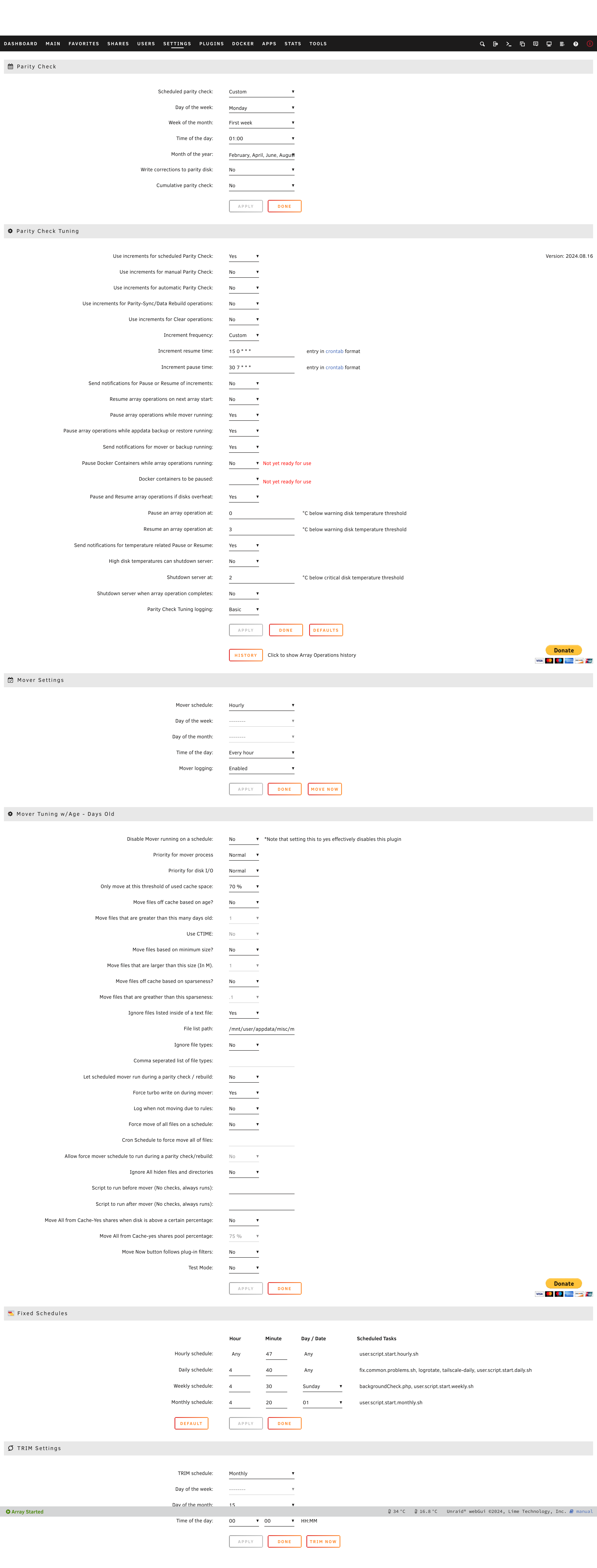

  5. 1. Mover Tuning Version: 2023.12.19 2. Attached setup page below 3. Attached exclusion list below mover_ignore.txt
  6. Has anyone seen/experienced these issues? Mover is triggered, seeing those errors...and then nothing happens. Have well over a TB of data waiting to be moved...but doesn't seem to be working. Feb 27 15:00:04 PlexRAID move: /usr/local/sbin/move does not exists, creating soft link Feb 27 15:00:04 PlexRAID move: ln: failed to create symbolic link '/usr/local/sbin/move': File exists Feb 27 15:00:04 PlexRAID move: mover: started Feb 27 15:00:04 PlexRAID move: script: Generating exclusions list... Feb 27 15:00:04 PlexRAID move: script: Validating /mnt/user/appdata/misc/mover_tuning_excluded_files.txt Feb 27 15:00:04 PlexRAID move: script: Validating /mnt/user/appdata/misc/mover_tuning_excluded_directories.txt Feb 27 15:00:05 PlexRAID move: script: Generated exclusions list /mnt/user/appdata/misc/mover_tuning_exclusions.txt Feb 27 15:00:05 PlexRAID move: mover: finished
