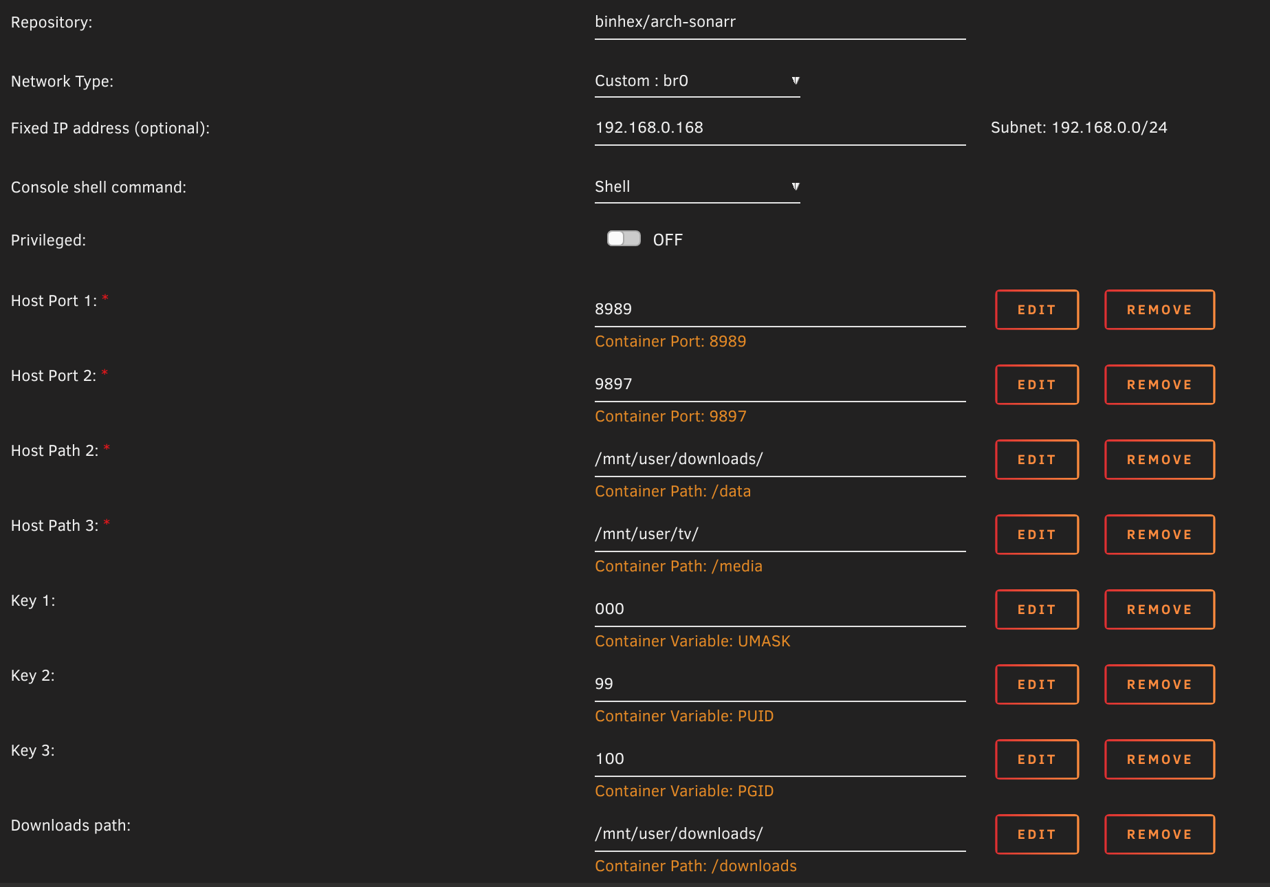

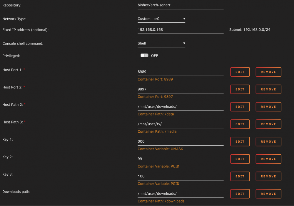

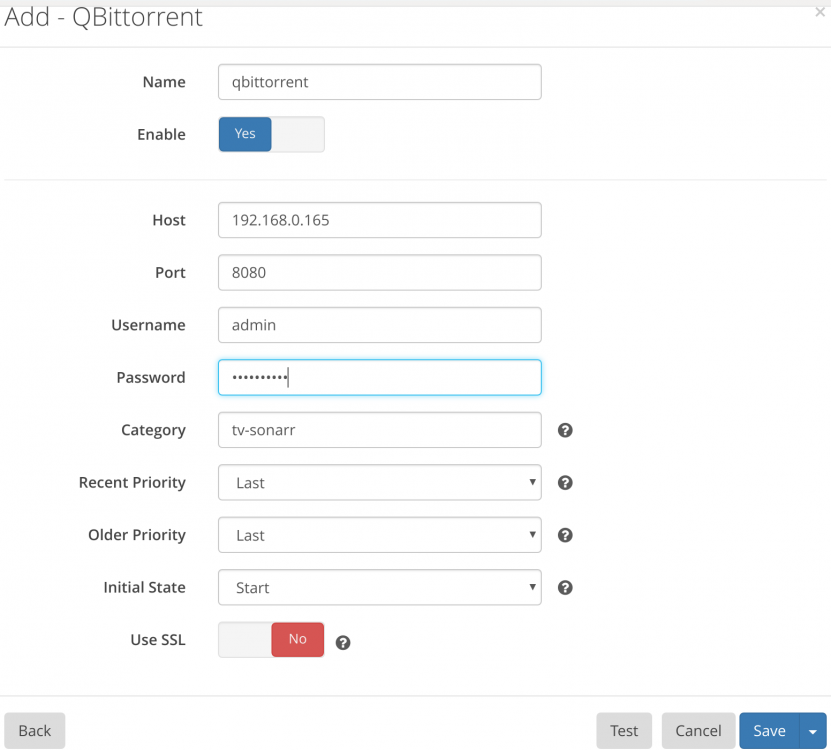

  16. Here is sonarr's config: And here is qbittorrent's connection config in Sonarr: @binhex Thanks for your help! (Note: The extra downloads path that I added is "after the fact" to test with transmission)

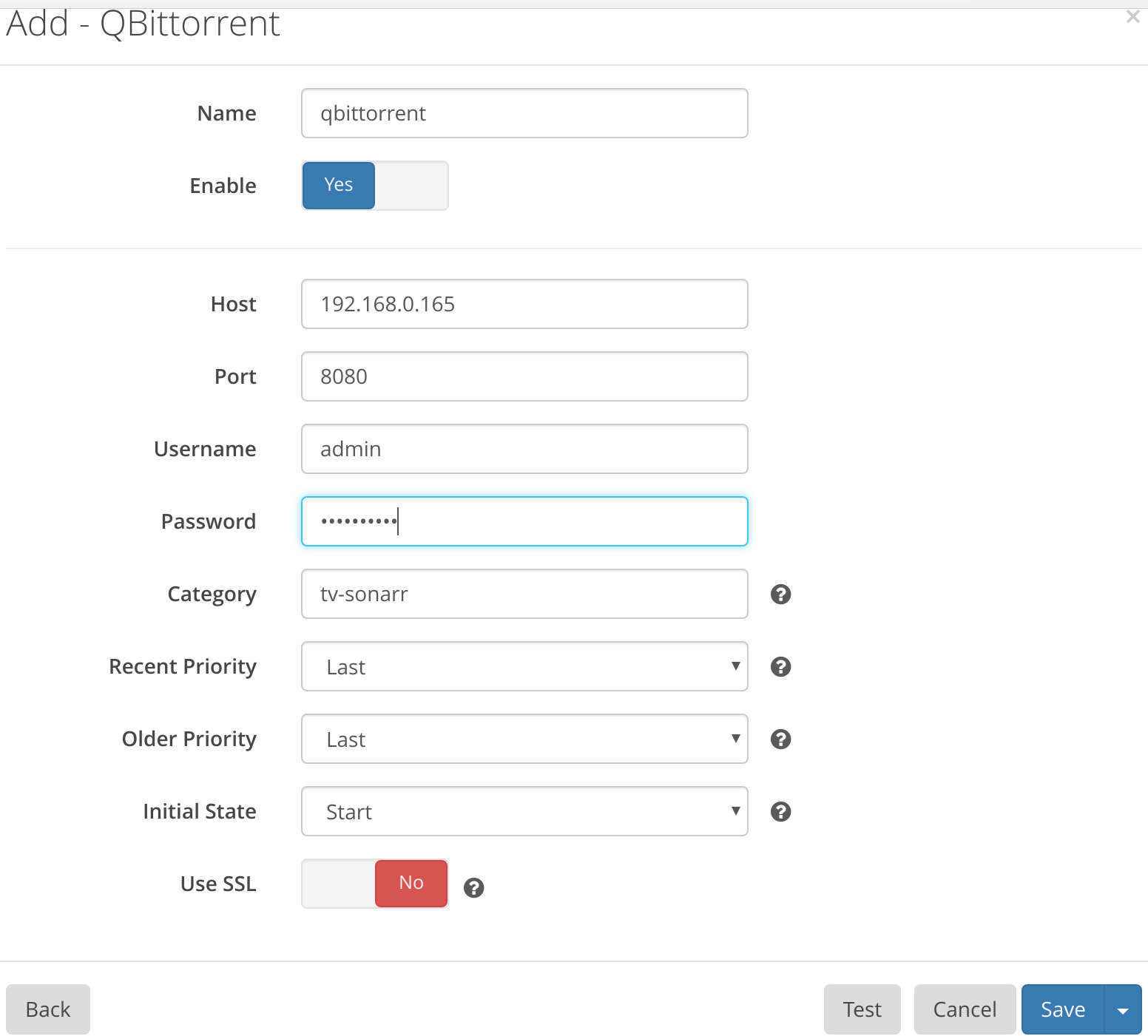

  19. My sonarr container cannot connect to my delugevpn container when vpn is enabled. I use pia. When VPN_ENABLED is set to 'no', sonarr can connect to deluge without issues. I also tried setting VPN_ENABLED set to 'yes' and STRICT_PORT_FORWARD set to 'no'. sonarr fails to connect to deluge in this case too. I use fixed IPs for the docker containers. Disclaimer: I have the same issue with qbittorrentvpn. It seems that deluge is more popular, hence I gave it a try too (and the cross posting). I will update both posts once I can figure this out.
  20. That's the first thing I double checked after reading this thread. It is set to 192.168.0.0/24 Update: I gave delugevpn a shot. I am getting the same exact timeout behavior. 2nd Update: If I configure the container with VPN_ENABLED set to 'no', sonarr can connect normally to qbittorrent. 3rd update: To eliminate port forwarding being the issue, I tested with VPN_ENABLED set to 'yes' and STRICT_PORT_FORWARD set to 'no'. Still sonarr cannot connect to qbittorrent. I can't figure out what's wrong. Did anyone get this working using fixed IPs for the two containers?
  21. I have the exact same problem. VPN is connected. I can use the web UI. I can download stuff, etc. However, all my attempts to connect sonarr to qbittorrent have failed. My qbittorrentvpn docker uses a custom bridge with a fixed IP 192.168.0.xxx I use the following in sonarr: Host: 192.168.0.xxx Port: 8080 + my qbittorrentvpn credentials. Can someone help me figure this out? Update: Checking the sonarr logs, I see this: The operation has timed out: 'http://192.168.0.xxx:8080/api/v2/app/webapiVersion' Note: Copying and pasting the url into a browser works just fine.
