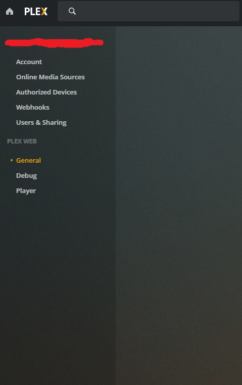

  5. Alright, I'm back with another issue and it's certainly a misunderstanding on my part that has caused it. My ISP recently changed my IP address and I didn't recognize it - I thought I was hacked therefore I changed my Plex password and force logged-out all devices. I also updated to the latest Plex version. Logging in seemed to work with the new password so I looked no deeper and went out of town on a business trip. Now I'm sitting in the hotel room trying to connect and unable to. I assumed I had to disconnect and re-claim my server so I logged into my VPN - I now have full access to my local network but I see no options to claim my server - though it didn't put up any fuss when I removed the existing server connection. Maybe I am misunderstanding how Open VPN works - I have full access to my local 192.168 network at home: My server, my router, etc. but when I go to http://192.168.xxx.xxx:32400/web/index.html I see no options beyond the generic ones. It's as if it doesn't recognize that I am indeed on that local network and cannot see my plex server. I suspect this is the case as I also cannot access any share folders through windows explorer - if I click on my pinned shortcuts it says "the local device name is already in use" and if I hard type \\192.168.xxx.xxx or \\192.168.xxx.xxx\ShareFolderName it asks for a username and password and then either claims I do not have access or that the username/password combination is wrong.
