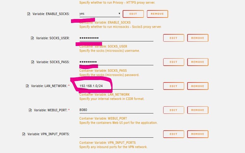

  3. Same thing! Any workaround?

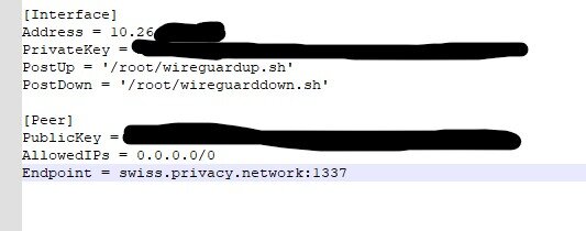

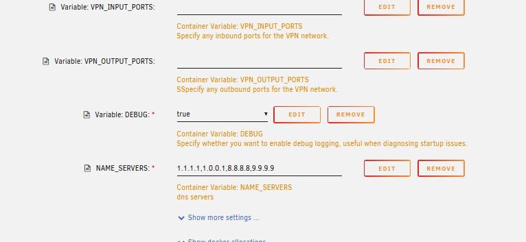

  4. You didn't enable privoxy and shadowsocks....enable them even if you don't use them for now

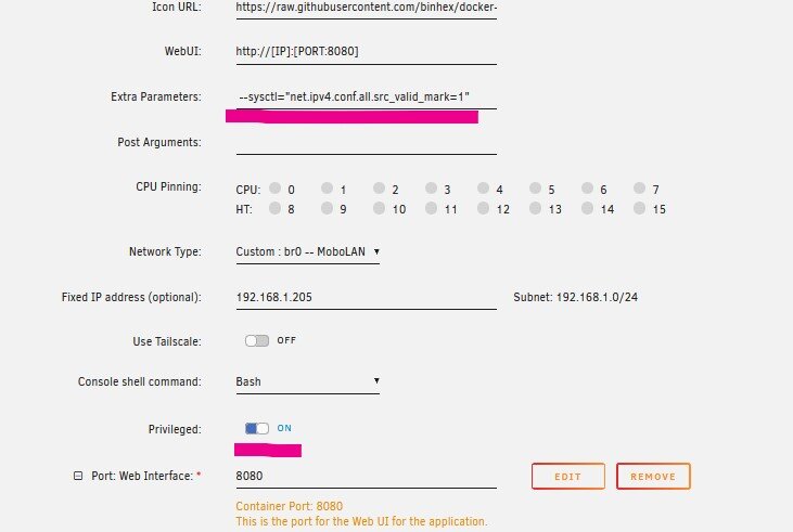

  5. Just to make sure you got all the settings as I have set with wireguard connected to swiis server.... try different server as well Try adding a NAME_SERVERS var...
  6. Just to mention that I am behind a cgnat with a static ip at the end of my network for me! And I work with macvlan as well. Recently changed for better dhcp compatibility in my network! I hope at least!
