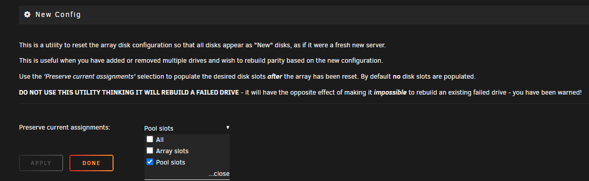

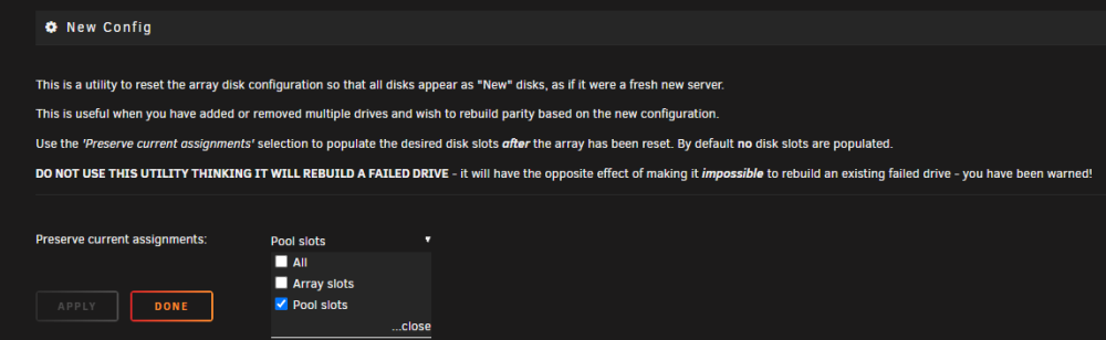

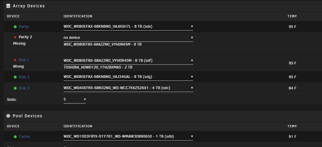

  2. so i did the new config. so do I got to wait until the Parity-Sync is finished and then stop the array again and switch the 2tb drive slot with the 8tb drive? also if i just have the 16tb drive as the parity drive(only the 16tb drive as parity) if 2 drives fail would the parity drive be able to run both drives or only one?

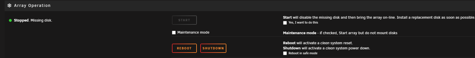

  3. so when i try that it does not allow me to turn the array back on. unless i need to check the "Yes, I want to do this" option?

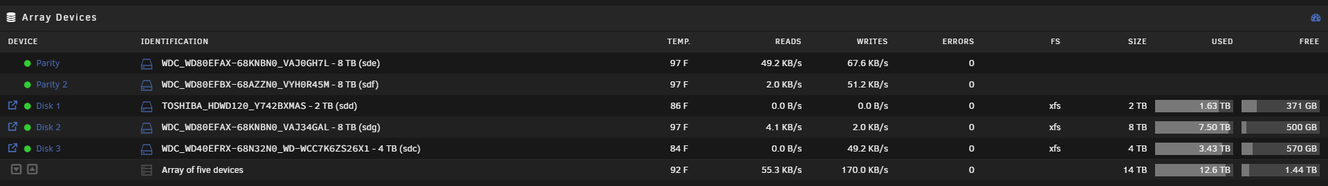

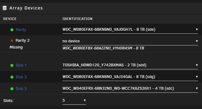

  4. hello, I was wondering how do i move some of my drives without losing data? so, I want to remove the 2tb drive and I will be adding a 16tb drive. so I was going to move one of the 8tb drives from the party to the slot of the 2tb drive but I don't want to lose that data off of the 2tb drive, so is it going to automatically transfer the data or do I have to do something different? the 16tb drive will be a party drive and i was also going to transfer the other 8tb drive at some point so the 16tb drive will be the only party drive. I did look at this but im still not sure how to do this: https://docs.unraid.net/unraid-os/manual/storage-management/#adding-disks

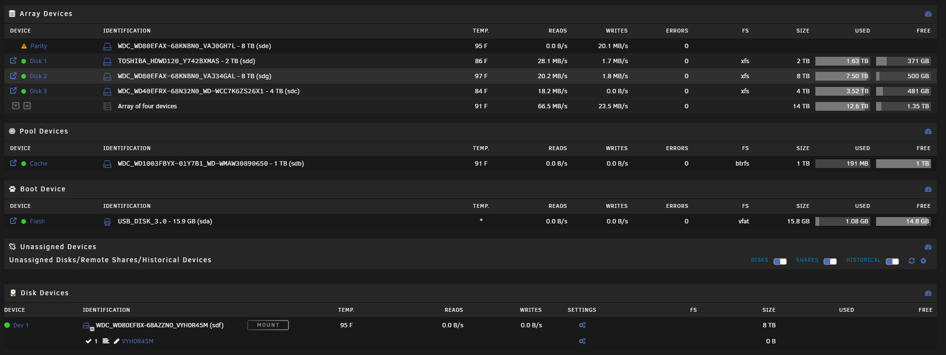

  6. Well I think rebooting it fix the cache drive because it has not showed an error since rebooting. But I will replace the drive once I get a chance.
  7. yea i realized that now. lol so i do have one more question about the cache drive. is it possible to set it up to just be used when im uploading file to the server and not to store data from application that are running on the array. like when i change the share like appdata. almost instantly the cacha drive start to have data moved to it from one of the dockers(i set it to just "yes"). i just want the data that i upload to the server to be stored to the cache and then the mover will move my data to the array. is that possible?
  8. i think I'm misunderstanding what a parity drive is. i was thinking the parity drive has a copy of the array drives.
  9. so, update: the cache drive is running again and is reading and writing again with no error so far. i started running the mover(it working so far). ah that make sense! will one of the 8tb parity drive stop being in parallel when i go past the 8tb mark for storage? and will it be used to store a backup? or do i have to do something manually? i'm at 7.70tb out of 14tb of used storage right now. ok i started to do this and the mover almost got everything moved but there a few mb of data that it can't move. how do i move files? or should I somehow delete the file? it's in appdata and it's for docker but all my docker are off right now.

  12. i would have thought it would be 16tb( or 14tb). yea i got it used when i first got the server. i'm not going to be home for about 2 weeks. is there something i could try to do? like stop the array and start it back up? or reboot the server? i forgot to ask but for the plugin Fix Common Problems it also saying that docker appdata location is not a cache-only share and i should change it to that. but when i did it started to fill my cache drive to 100% full.(this was a few months ago when i did this). but what i want is to only use the cache drive when i transfer files to via SMB and just allow the docker and vm to use the main drives to store data. is that possible?
