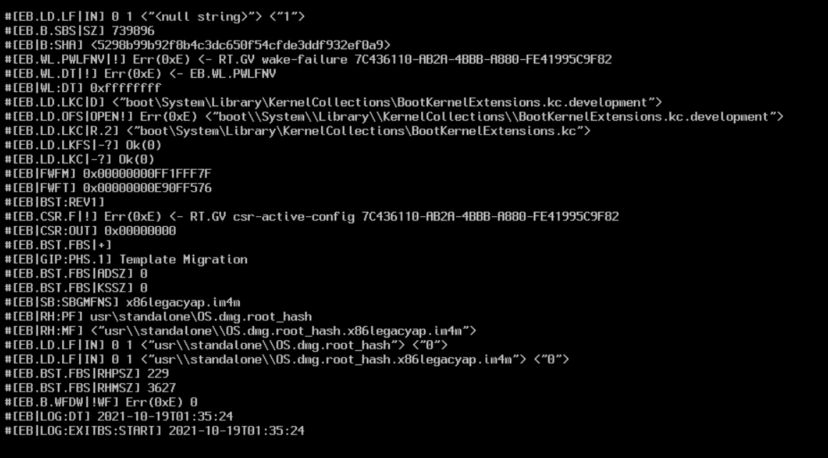

  1. Help spaceinvaderone you are my only hope... Hi, first, thank you for make vms easier to make in unraid I really appreciate your efforts. Since im a little dumb, probably this is already answered but Im not been able to find someone with the same problem im experiencing: I did follow your step by step guide by the letter installing bigsur. Everything goes fine until I delete the extra disks, seems something is missing in my install because I keep geting this (tried this many times) (no gui) and then I get an err that doesnt recover seems that im missing something at the UEFI copy thing, but im unable to figure it out. Can you help me? Thanks!
