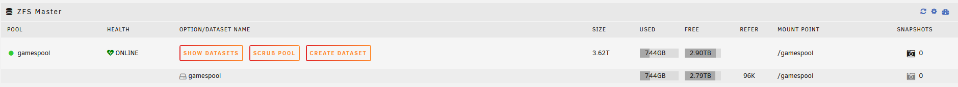

  5. @Iker Will it be possible to show also zvol's in a future version of your plugin? Currently I see only the pool name if I click "SHOW DATASETS"... yes I know, zvols are't datasets 😆

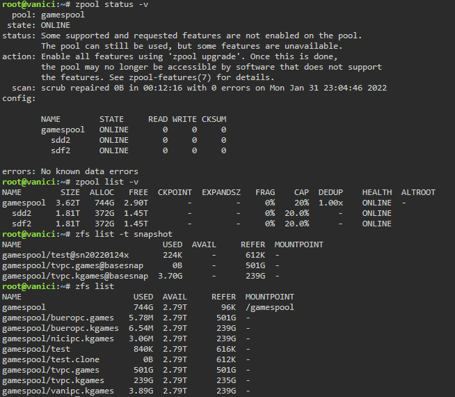

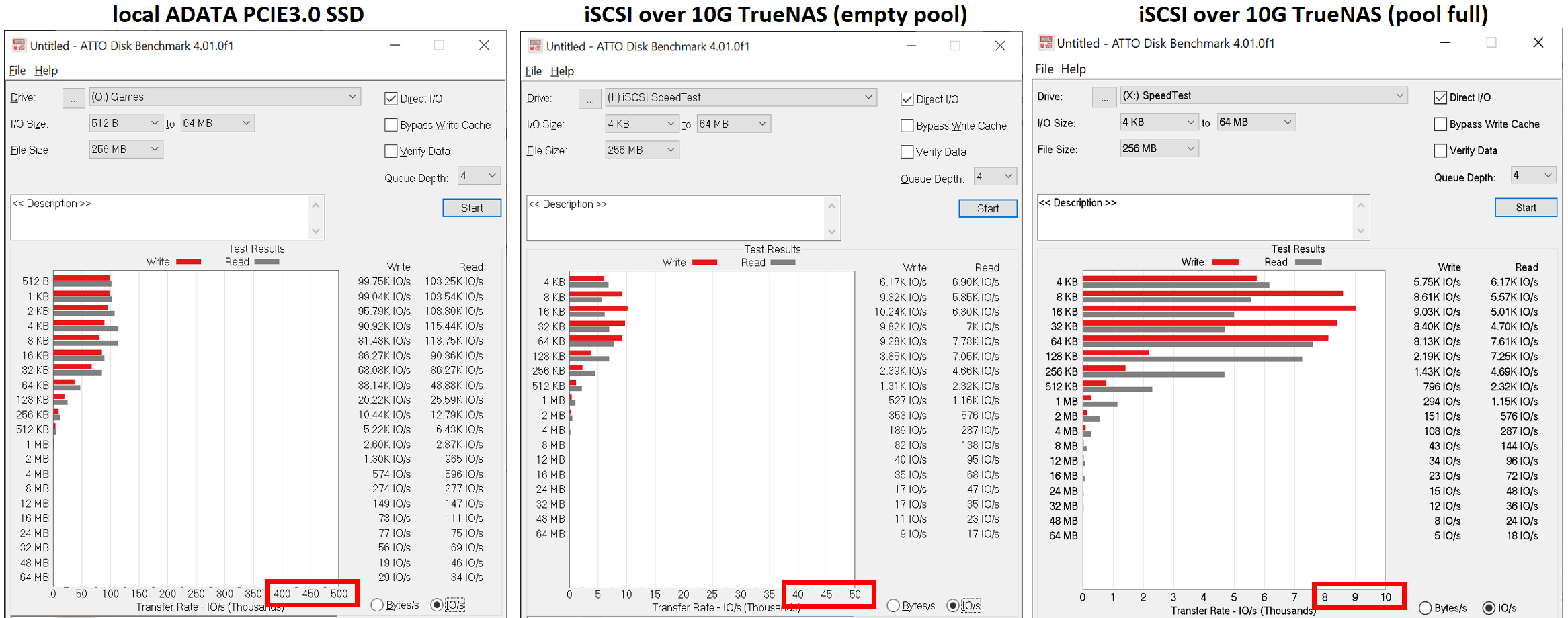

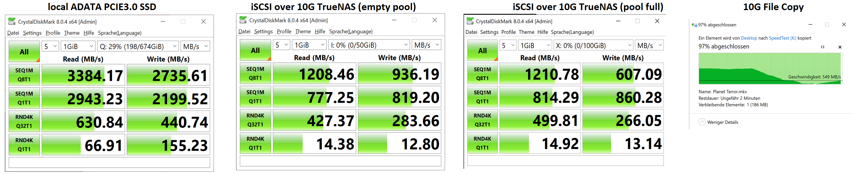

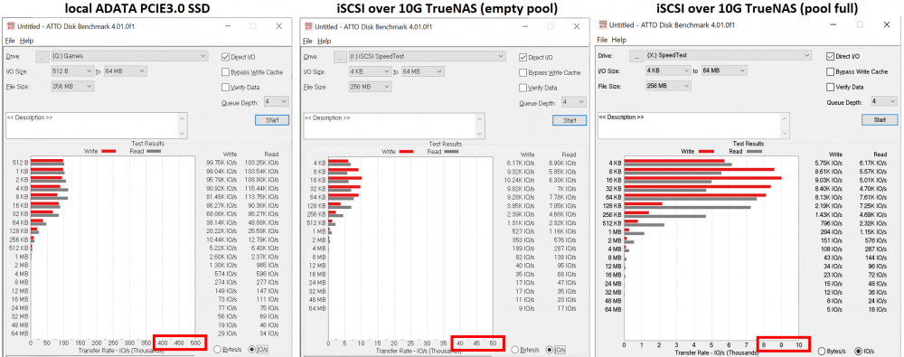

  7. So I ended up useing the 'hybrid mode' called by @SpaceInvaderOne to create my pool, datasets and zvol's and import/export them to Unraid: Another help for ZFS+iSCSI is this post here: https://forum.level1techs.com/t/guide-iscsi-target-server-on-linux-with-zfs-for-windows-initiator-clients/174803 But creating a zvol (which is more or less a 'disk within a file stored on your ZFS pool') is easy as: zfs create -s -V 100G -o volblocksize=4096 -o compression=lz4 YOURPOOLNAME/testzvol -s = sparse, thin provisioning so only used space within the zvol is allocated -V 100G = 100GB size All the created zvol's are listed under /dev/zvol/YOURPOOLNAME/*** (example above is therefore /dev/zvol/YOURPOOLNAME/testzvol ) and also shown there after reboot. The zvol's are also shown with zfs list and it's possible to create zvol's within other datasets if you need it. Such a zvol can be used as VM disk by just add a manual entry like this: or in my case use it together with the iSCSI target plugin by @SimonF and @ich777: You just need to create the backstorage manually (I think at the moment 😉) with the following commands: targetcli /backstores/block create name=testzvol dev=/dev/zvol/YOURPOOLNAME/testzvol cd /backstores/block/testzvol/ set attribute block_size=4096 set attribute emulate_tpu=1 set attribute is_nonrot=1 cd / exit The rest can be configured within the iSCSI plugin, you can just pick this manually created backstorage there: If you don't need it any longer, remove the initiator mapping and delete the backstorage entry (note the zvol still exists): targetcli cd /backstores/block/ delete testzvol cd / exit And last but not least how to clone an existing zvol and/or delete it: zfs snapshot YOURPOOLNAME/testzvol@yoursnapshotname zfs clone -p YOURPOOLNAME/testzvol@yoursnapshotname YOURPOOLNAME/testzvol.myclone zfs destroy YOURPOOLNAME/testzvol.myclone zfs destroy YOURPOOLNAME/testzvol@yoursnapshotname zfs destroy YOURPOOLNAME/testzvol

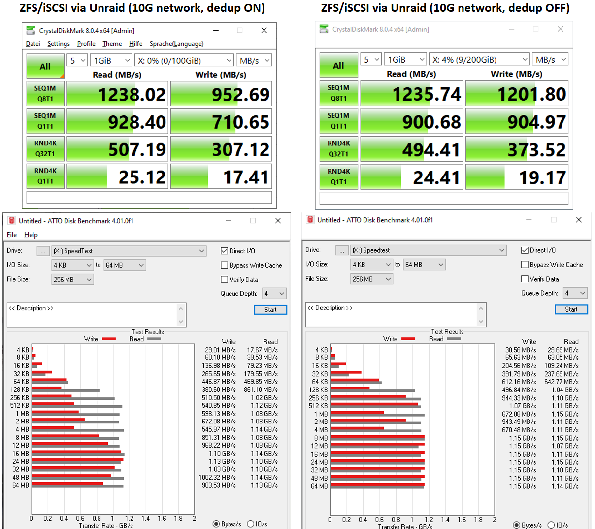

  8. If there are any interests in my results of "have fun with ZFS/iSCSI on Unraid" for a shared game library... I've finished my tests and I will NOT use dedup. The real world performance of copying hundreds of GB to my dedup enabled test zvol's via iSCSI (10G network) is horrible and tooks hours... compared to dedup-off which tooks just 12 minutes for 520GB. The syntetic benchmarks are also better without dedup (see attached screenshots). My second idea of "setup all games and clone it" works great... now I need even less storage in my pool as with dedup enabled because of there is just one fully installed game library present, all the others are clones with just a few MB of different files. The performace is better and I don't need much more RAM for the DDT. For the update process I have a little script that removes the iSCSI mapping/backstorage, creates a new snapshot/clone and re-creates the iSCSI mapping/backstorage... so game install or update is simple as: - do it on the main gaming rig - run a user-script - bam, a few seconds later all my kids getting new games 😁 => My next project based on this setup is testing GPU-P and clone another 2-3 game libraries... which is now done in seconds and does not need any additional storage!!! If someone needs the commands to create iSCSI backstorages for zvol's or someting... I can write a little tutorial. Benchmarks with dedup ON vs. OFF over iSCSI (better write performance, max out my 10G network, pool with 2 cheap SATA consumer SSD's stiped, 24GB for ZFS ARC):

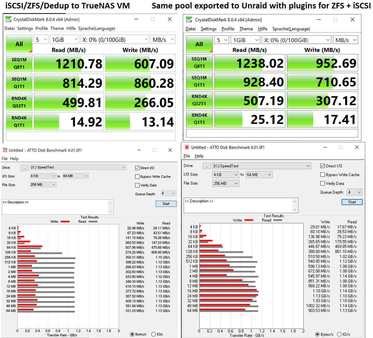

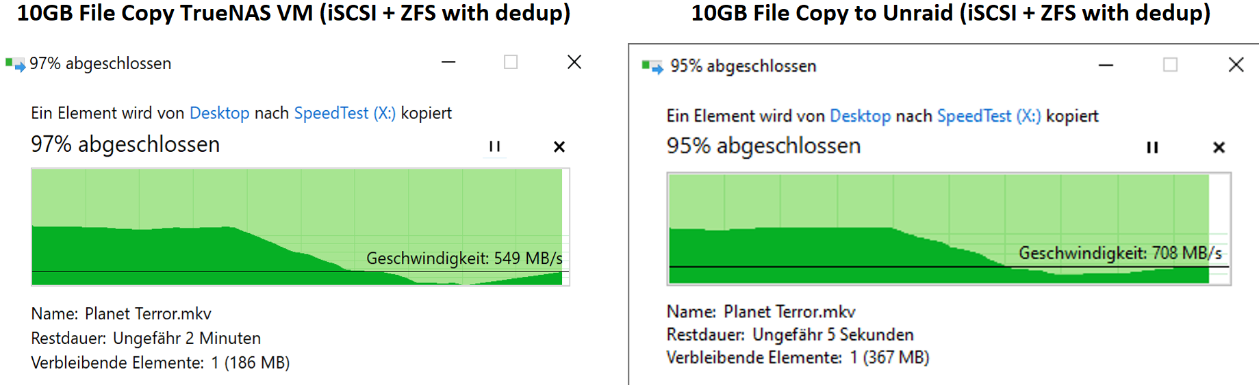

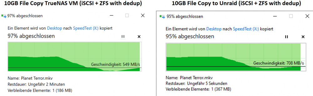

  9. And now my speed compare ZFS/Dedup/iSCSI to TrueNAS (as VM on Unraid) vs. ZFS/Dedup/iSCSI to native Unraid... I mean to the awsome community plugins on Unraid 😇 !!! Thanks a lot at this point for all your work. As I hoped the performance is (mostly) better. It could be because of no virtio layer needed (I don't know the performance of the FreeBSD/TrueNAS virtio driver). The "real world" 10GB movie file copy doesn't drop as much and runs really faster on "native unraid". Conclusion: Will I use iSCSI => yes, the performance for games over 10G network is great, normally just a few seconds compared with local Nvme which is not noticable if you have to watch intos... Will I use ZFS => yes! Will I use Dedup => it depends... the dedup ratio could be better for that and the drawbacks of slower performance with more data in the future is a big point. I've another idea to test... Next idea: Prepare one game lib as zvol with really everything installed, take a snapshot/clone of it for every client. The clones should only use the space on disk for the changed data and no additional RAM needed for dedup table. With such a setup I need to update only the initial/primary "game lib zvol" and a reset/redo new clones via a user-script should be possible.

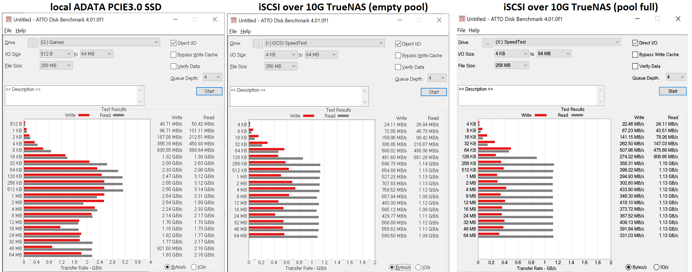

  13. Here some numbers while I'm still testing my ZFS-dedup+iSCSI game library idea and the pool is not yet exported to unraid. Specs: - TrueNAS 12.U7 as VM on unraid with 32G RAM, 2x2TB SATA SSD passthrough (I descided to use some old cheap consumer SSD's) - these 2 disks striped together in a pool, sync off, dedup on (data loss doesn't matter, games can be downloaded again and again...) - 4 game libraries in total (2x800G + 2x200G) fully loaded, each as individual zvol linked via iSCSI to the clients, tested and all is working - 951G allocated disk space for this 2TB data in total (at the moment) - Dedup ratio of 2.16, compression off (I don't get more than 1.01 compression ration on the game libs) - 58mio DDT entries à 300B => around 16-17GB dedup table in RAM needed - 10G network Subjective impressions: Read speed is astonshing for disks over network, game loading times doesn't differ a lot compared with local NVMe SSD's! Write speeds are good as long as the data fit's into the ARC cache... afterwards it drops to 50-100MB/s until the cache is flushed and ready for high speeds 😁. Some benchmarks screenshot and the "10G file copy" test attached (Windows really can't calculate a correct copy time...). And here some game loading time differences in seconds (local gen3 Nvme vs. iSCSI-ZVOL): - MSFS2020 until Menu: 185 vs. 195 (I personally don't understand why this game tooks so long to load also on Nvme!!!) - Battelfield V until Menu: 57 vs 63 - Battlefield level loading: 26 vs 28 - Doom Ethernal until Menu: 46 vs 56 (I hate watching intros and warn text every time 😄) - Doom Ethernal level loading: 6 vs 8 - Cyberpunk 2077 level loading: 6 vs 14 (here I can see the biggest difference) The next step is export this game library ZFS pool to unraid, configure iSCSI on unraid and test again.
