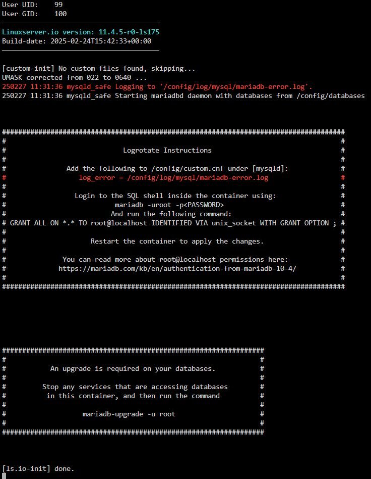

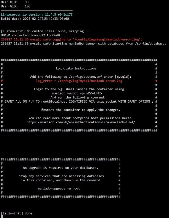

  3. Hi, Today i have started having issues with Mariadb - please see attached screenshot. I am using the latest instances of Mariadb, swag, nextcloud and vaultwarden. I have added "log_error = /config/log/mysql/mariadb-error.log" to the "custom.cnf" in the maria appdata. Using the container console I ran this command "mariadb -uroot -p<PASSWORD>" (with my MYSQL root password). I get this "sh: syntax error: unexpected newline" Any help would be much appreciated. please see attached..

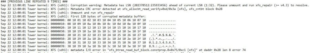

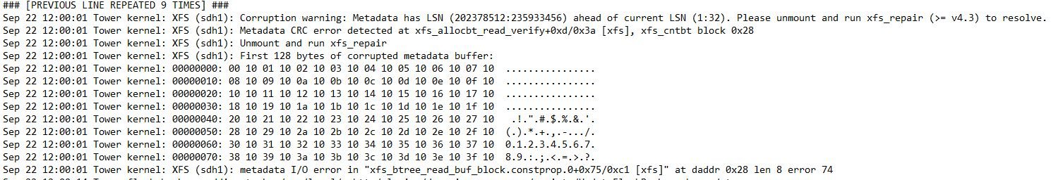

  5. So iI performed the "xfs_repair -n /dev/sdh1" result: - root@Tower:~# xfs_repair -n /dev/sdh1 Phase 1 - find and verify superblock... Phase 2 - using internal log - zero log... - scan filesystem freespace and inode maps... sb_icount 64, counted 32 sb_ifree 61, counted 29 sb_fdblocks 61019537, counted 61019541 - found root inode chunk Phase 3 - for each AG... - scan (but don't clear) agi unlinked lists... - process known inodes and perform inode discovery... - agno = 0 - agno = 1 - agno = 2 - agno = 3 - process newly discovered inodes... Phase 4 - check for duplicate blocks... - setting up duplicate extent list... - check for inodes claiming duplicate blocks... - agno = 0 - agno = 2 - agno = 3 - agno = 1 No modify flag set, skipping phase 5 Phase 6 - check inode connectivity... - traversing filesystem ... - traversal finished ... - moving disconnected inodes to lost+found ... Phase 7 - verify link counts... No modify flag set, skipping filesystem flush and exiting. ####### Then ############################################## xfs_repair /dev/sdh1 Phase 1 - find and verify superblock... Phase 2 - using internal log - zero log... - scan filesystem freespace and inode maps... Metadata CRC error detected at 0x439496, xfs_agf block 0x8/0x1000 agf has bad CRC for ag 0 Metadata CRC error detected at 0x4643f6, xfs_agi block 0x10/0x1000 agi has bad CRC for ag 0 bad magic # 0x6623c00f for agf 0 bad version # -2051342234 for agf 0 bad sequence # -2114235325 for agf 0 bad length 1346441093 for agf 0, should be 15262348 flfirst 260377600 in agf 0 too large (max = 1014) fllast 1734774099 in agf 0 too large (max = 1014) bad uuid 4a286681-f900-0008-000f-830c0067668b for agf 0 bad magic # 0x46494c45 for agi 0 bad version # 805307136 for agi 0 bad sequence # -233627648 for agi 0 bad length # 0 for agi 0, should be 15262348 bad uuid 00000400-0000-0000-0000-040000000000 for agi 0 reset bad agf for ag 0 reset bad agi for ag 0 Metadata CRC error detected at 0x439034, xfs_agfl block 0x18/0x1000 agfl has bad CRC for ag 0 bad agbno 301994752 in agfl, agno 0 freeblk count 1 != flcount 275211915 in ag 0 bad agbno 2952823289 for btbno root, agno 0 bad agbno 33623938 for btbcnt root, agno 0 Metadata CRC error detected at 0x46e02d, xfs_refcountbt block 0x3319e48/0x1000 btree block 0/6697929 is suspect, error -74 bad magic # 0 in refcount btree block 0/6697929 bad refcountbt block count 0, saw 3222242307 agf_freeblks 183182736, counted 0 in ag 0 agf_longest 1734774099, counted 0 in ag 0 agf_btreeblks 275211915, counted 0 in ag 0 bad agbno 939524352 for inobt root, agno 0 bad agbno 2952790016 for finobt root, agno 0 agi_count 16777472, counted 0 in ag 0 agi_freecount 262144, counted 0 in ag 0 agi_freecount 262144, counted 0 in ag 0 finobt agi unlinked bucket 0 is 117440512 in ag 0 (inode=117440512) agi unlinked bucket 1 is 0 in ag 0 (inode=0) agi unlinked bucket 2 is 33554432 in ag 0 (inode=33554432) agi unlinked bucket 3 is 0 in ag 0 (inode=0) agi unlinked bucket 4 is 268435456 in ag 0 (inode=268435456) agi unlinked bucket 5 is 1610612736 in ag 0 (inode=1610612736) agi unlinked bucket 6 is 6144 in ag 0 (inode=6144) agi unlinked bucket 7 is 0 in ag 0 (inode=0) agi unlinked bucket 8 is 1207959552 in ag 0 (inode=1207959552) agi unlinked bucket 9 is 402653184 in ag 0 (inode=402653184) agi unlinked bucket 10 is 552670106 in ag 0 (inode=552670106) agi unlinked bucket 11 is 2746341121 in ag 0 (inode=2746341121) agi unlinked bucket 12 is 552670106 in ag 0 (inode=552670106) agi unlinked bucket 13 is 2746341121 in ag 0 (inode=2746341121) agi unlinked bucket 14 is 552670106 in ag 0 (inode=552670106) agi unlinked bucket 15 is 2746341121 in ag 0 (inode=2746341121) agi unlinked bucket 16 is 552670106 in ag 0 (inode=552670106) agi unlinked bucket 17 is 2746341121 in ag 0 (inode=2746341121) agi unlinked bucket 18 is 100663296 in ag 0 (inode=100663296) agi unlinked bucket 19 is 0 in ag 0 (inode=0) agi unlinked bucket 20 is 0 in ag 0 (inode=0) agi unlinked bucket 21 is 0 in ag 0 (inode=0) agi unlinked bucket 22 is 0 in ag 0 (inode=0) agi unlinked bucket 23 is 65536 in ag 0 (inode=65536) agi unlinked bucket 24 is 0 in ag 0 (inode=0) agi unlinked bucket 25 is 0 in ag 0 (inode=0) agi unlinked bucket 26 is 0 in ag 0 (inode=0) agi unlinked bucket 27 is 0 in ag 0 (inode=0) agi unlinked bucket 28 is 805306368 in ag 0 (inode=805306368) agi unlinked bucket 29 is 1744830464 in ag 0 (inode=1744830464) agi unlinked bucket 30 is 6144 in ag 0 (inode=6144) agi unlinked bucket 31 is 768 in ag 0 (inode=768) agi unlinked bucket 32 is 1241513984 in ag 0 (inode=1241513984) agi unlinked bucket 33 is 402653440 in ag 0 (inode=402653440) agi unlinked bucket 34 is 83886080 in ag 0 (inode=83886080) agi unlinked bucket 35 is 1280 in ag 0 (inode=1280) agi unlinked bucket 36 is 552670106 in ag 0 (inode=552670106) agi unlinked bucket 37 is 2746341121 in ag 0 (inode=2746341121) agi unlinked bucket 38 is 552670106 in ag 0 (inode=552670106) agi unlinked bucket 39 is 2746341121 in ag 0 (inode=2746341121) agi unlinked bucket 40 is 552670106 in ag 0 (inode=552670106) agi unlinked bucket 41 is 2746341121 in ag 0 (inode=2746341121) agi unlinked bucket 42 is 552670106 in ag 0 (inode=552670106) agi unlinked bucket 43 is 2746341121 in ag 0 (inode=2746341121) agi unlinked bucket 44 is 4194304 in ag 0 (inode=4194304) agi unlinked bucket 45 is 0 in ag 0 (inode=0) agi unlinked bucket 46 is 4194304 in ag 0 (inode=4194304) agi unlinked bucket 47 is 0 in ag 0 (inode=0) agi unlinked bucket 48 is 100663296 in ag 0 (inode=100663296) agi unlinked bucket 49 is 0 in ag 0 (inode=0) agi unlinked bucket 50 is 67314688 in ag 0 (inode=67314688) agi unlinked bucket 51 is 1291863552 in ag 0 (inode=1291863552) agi unlinked bucket 52 is 1409286144 in ag 0 (inode=1409286144) agi unlinked bucket 53 is 0 in ag 0 (inode=0) agi unlinked bucket 54 is 2147483648 in ag 0 (inode=2147483648) agi unlinked bucket 55 is 1207959552 in ag 0 (inode=1207959552) agi unlinked bucket 56 is 16793600 in ag 0 (inode=16793600) agi unlinked bucket 57 is 1536 in ag 0 (inode=1536) agi unlinked bucket 58 is 0 in ag 0 (inode=0) agi unlinked bucket 59 is 0 in ag 0 (inode=0) agi unlinked bucket 60 is 1056964608 in ag 0 (inode=1056964608) agi unlinked bucket 61 is 0 in ag 0 (inode=0) agi unlinked bucket 62 is 1073741824 in ag 0 (inode=1073741824) agi unlinked bucket 63 is 0 in ag 0 (inode=0) sb_icount 64, counted 0 sb_ifree 61, counted 0 sb_fdblocks 61019537, counted 45757207 root inode chunk not found Phase 3 - for each AG... - scan and clear agi unlinked lists... - process known inodes and perform inode discovery... - agno = 0 Metadata corruption detected at 0x435c43, xfs_inode block 0x80/0x4000 Metadata corruption detected at 0x435c43, xfs_inode block 0xa0/0x4000 bad CRC for inode 128 bad magic number 0x68 on inode 128 bad version number 0x2 on inode 128 bad next_unlinked 0x30683168 on inode 128 inode identifier 5505735654847827816 mismatch on inode 128 bad CRC for inode 129 bad magic number 0x69 on inode 129 bad version number 0x2 on inode 129 bad next_unlinked 0x30693169 on inode 129 inode identifier 5506017134119571305 mismatch on inode 129 bad CRC for inode 130 bad magic number 0x6a on inode 130 bad version number 0x2 on inode 130 bad next_unlinked 0x306a316a on inode 130 inode identifier 5506298613391314794 mismatch on inode 130 bad CRC for inode 131 bad magic number 0x6b on inode 131 bad version number 0x2 on inode 131 bad next_unlinked 0x306b316b on inode 131 inode identifier 5506580092663058283 mismatch on inode 131 bad CRC for inode 132 bad magic number 0x6c on inode 132 bad version number 0x2 on inode 132 bad next_unlinked 0x306c316c on inode 132 inode identifier 5506861571934801772 mismatch on inode 132 bad CRC for inode 133 bad magic number 0x6d on inode 133 bad version number 0x2 on inode 133 bad next_unlinked 0x306d316d on inode 133 inode identifier 5507143051206545261 mismatch on inode 133 bad CRC for inode 134 bad magic number 0x6e on inode 134 bad version number 0x2 on inode 134 bad next_unlinked 0x306e316e on inode 134 inode identifier 5507424530478288750 mismatch on inode 134 bad CRC for inode 135 bad magic number 0x6f on inode 135 bad version number 0x2 on inode 135 bad next_unlinked 0x306f316f on inode 135 inode identifier 5507706009750032239 mismatch on inode 135 bad CRC for inode 136 bad magic number 0x70 on inode 136 bad version number 0x2 on inode 136 bad next_unlinked 0x30703170 on inode 136 inode identifier 5507987489021775728 mismatch on inode 136 bad CRC for inode 137 bad magic number 0x71 on inode 137 bad version number 0x2 on inode 137 bad next_unlinked 0x30713171 on inode 137 inode identifier 5508268968293519217 mismatch on inode 137 bad CRC for inode 138 bad magic number 0x72 on inode 138 bad version number 0x2 on inode 138 bad next_unlinked 0x30723172 on inode 138 inode identifier 5508550447565262706 mismatch on inode 138 bad CRC for inode 139 bad magic number 0x73 on inode 139 bad version number 0x2 on inode 139 bad next_unlinked 0x30733173 on inode 139 inode identifier 5508831926837006195 mismatch on inode 139 bad CRC for inode 140 bad magic number 0x74 on inode 140 bad version number 0x2 on inode 140 bad next_unlinked 0x30743174 on inode 140 inode identifier 5509113406108749684 mismatch on inode 140 bad CRC for inode 141 bad magic number 0x75 on inode 141 bad version number 0x2 on inode 141 bad next_unlinked 0x30753175 on inode 141 inode identifier 5509394885380493173 mismatch on inode 141 bad CRC for inode 142 bad magic number 0x76 on inode 142 bad version number 0x2 on inode 142 bad next_unlinked 0x30763176 on inode 142 inode identifier 5509676364652236662 mismatch on inode 142 bad CRC for inode 143 bad magic number 0x77 on inode 143 bad version number 0x2 on inode 143 bad next_unlinked 0x30773177 on inode 143 inode identifier 5509957843923980151 mismatch on inode 143 bad CRC for inode 144 bad magic number 0x78 on inode 144 bad version number 0x2 on inode 144 bad next_unlinked 0x30783178 on inode 144 inode identifier 5510239323195723640 mismatch on inode 144 bad CRC for inode 145 bad magic number 0x79 on inode 145 bad version number 0x2 on inode 145 bad next_unlinked 0x30793179 on inode 145 inode identifier 5510520802467467129 mismatch on inode 145 bad CRC for inode 146 bad magic number 0x7a on inode 146 bad version number 0x2 on inode 146 bad next_unlinked 0x307a317a on inode 146 inode identifier 5510802281739210618 mismatch on inode 146 bad CRC for inode 147 bad magic number 0x7b on inode 147 bad version number 0x2 on inode 147 bad next_unlinked 0x307b317b on inode 147 inode identifier 5511083761010954107 mismatch on inode 147 bad CRC for inode 148 bad magic number 0x7c on inode 148 bad version number 0x2 on inode 148 bad next_unlinked 0x307c317c on inode 148 inode identifier 5511365240282697596 mismatch on inode 148 bad CRC for inode 149 bad magic number 0x7d on inode 149 bad version number 0x2 on inode 149 bad next_unlinked 0x307d317d on inode 149 inode identifier 5511646719554441085 mismatch on inode 149 bad CRC for inode 150 bad magic number 0x7e on inode 150 bad version number 0x2 on inode 150 bad next_unlinked 0x307e317e on inode 150 inode identifier 5511928198826184574 mismatch on inode 150 bad CRC for inode 151 bad magic number 0x7f on inode 151 bad version number 0x2 on inode 151 bad next_unlinked 0x307f317f on inode 151 inode identifier 5512209678097928063 mismatch on inode 151 bad CRC for inode 152 bad magic number 0x80 on inode 152 bad version number 0x2 on inode 152 bad next_unlinked 0x30803180 on inode 152 inode identifier 5512491157369671552 mismatch on inode 152 bad CRC for inode 153 bad magic number 0x81 on inode 153 bad version number 0x2 on inode 153 bad next_unlinked 0x30813181 on inode 153 inode identifier 5512772636641415041 mismatch on inode 153 bad CRC for inode 154 bad magic number 0x82 on inode 154 bad version number 0x2 on inode 154 bad next_unlinked 0x30823182 on inode 154 inode identifier 5513054115913158530 mismatch on inode 154 bad CRC for inode 155 bad magic number 0x83 on inode 155 bad version number 0x2 on inode 155 bad next_unlinked 0x30833183 on inode 155 inode identifier 5513335595184902019 mismatch on inode 155 bad CRC for inode 156 bad magic number 0x84 on inode 156 bad version number 0x2 on inode 156 bad next_unlinked 0x30843184 on inode 156 inode identifier 5513617074456645508 mismatch on inode 156 bad CRC for inode 157 bad magic number 0x85 on inode 157 bad version number 0x2 on inode 157 bad next_unlinked 0x30853185 on inode 157 inode identifier 5513898553728388997 mismatch on inode 157 bad CRC for inode 158 bad magic number 0x86 on inode 158 bad version number 0x2 on inode 158 bad next_unlinked 0x30863186 on inode 158 inode identifier 5514180033000132486 mismatch on inode 158 bad CRC for inode 159 bad magic number 0x87 on inode 159 bad version number 0x2 on inode 159 bad next_unlinked 0x30873187 on inode 159 inode identifier 5514461512271875975 mismatch on inode 159 bad CRC for inode 160 bad magic number 0x88 on inode 160 bad version number 0x2 on inode 160 bad next_unlinked 0x30883188 on inode 160 inode identifier 5514742991543619464 mismatch on inode 160 bad CRC for inode 161 bad magic number 0x89 on inode 161 bad version number 0x2 on inode 161 bad next_unlinked 0x30893189 on inode 161 inode identifier 5515024470815362953 mismatch on inode 161 bad CRC for inode 162 bad magic number 0x8a on inode 162 bad version number 0x2 on inode 162 bad next_unlinked 0x308a318a on inode 162 inode identifier 5515305950087106442 mismatch on inode 162 bad CRC for inode 163 bad magic number 0x8b on inode 163 bad version number 0x2 on inode 163 bad next_unlinked 0x308b318b on inode 163 inode identifier 5515587429358849931 mismatch on inode 163 bad CRC for inode 164 bad magic number 0x8c on inode 164 bad version number 0x2 on inode 164 bad next_unlinked 0x308c318c on inode 164 inode identifier 5515868908630593420 mismatch on inode 164 bad CRC for inode 165 bad magic number 0x8d on inode 165 bad version number 0x2 on inode 165 bad next_unlinked 0x308d318d on inode 165 inode identifier 5516150387902336909 mismatch on inode 165 bad CRC for inode 166 bad magic number 0x8e on inode 166 bad version number 0x2 on inode 166 bad next_unlinked 0x308e318e on inode 166 inode identifier 5516431867174080398 mismatch on inode 166 bad CRC for inode 167 bad magic number 0x8f on inode 167 bad version number 0x2 on inode 167 bad next_unlinked 0x308f318f on inode 167 inode identifier 5516713346445823887 mismatch on inode 167 bad CRC for inode 168 bad magic number 0x90 on inode 168 bad version number 0x2 on inode 168 bad next_unlinked 0x30903190 on inode 168 inode identifier 5516994825717567376 mismatch on inode 168 bad CRC for inode 169 bad magic number 0x91 on inode 169 bad version number 0x2 on inode 169 bad next_unlinked 0x30913191 on inode 169 inode identifier 5517276304989310865 mismatch on inode 169 bad CRC for inode 170 bad magic number 0x92 on inode 170 bad version number 0x2 on inode 170 bad next_unlinked 0x30923192 on inode 170 inode identifier 5517557784261054354 mismatch on inode 170 bad CRC for inode 171 bad magic number 0x93 on inode 171 bad version number 0x2 on inode 171 bad next_unlinked 0x30933193 on inode 171 inode identifier 5517839263532797843 mismatch on inode 171 bad CRC for inode 172 bad magic number 0x94 on inode 172 bad version number 0x2 on inode 172 bad next_unlinked 0x30943194 on inode 172 inode identifier 5518120742804541332 mismatch on inode 172 bad CRC for inode 173 bad magic number 0x95 on inode 173 bad version number 0x2 on inode 173 bad next_unlinked 0x30953195 on inode 173 inode identifier 5518402222076284821 mismatch on inode 173 bad CRC for inode 174 bad magic number 0x96 on inode 174 bad version number 0x2 on inode 174 bad next_unlinked 0x30963196 on inode 174 inode identifier 5518683701348028310 mismatch on inode 174 bad CRC for inode 175 bad magic number 0x97 on inode 175 bad version number 0x2 on inode 175 bad next_unlinked 0x30973197 on inode 175 inode identifier 5518965180619771799 mismatch on inode 175 bad CRC for inode 176 bad magic number 0x98 on inode 176 bad version number 0x2 on inode 176 bad next_unlinked 0x30983198 on inode 176 inode identifier 5519246659891515288 mismatch on inode 176 bad CRC for inode 177 bad magic number 0x99 on inode 177 bad version number 0x2 on inode 177 bad next_unlinked 0x30993199 on inode 177 inode identifier 5519528139163258777 mismatch on inode 177 bad CRC for inode 178 bad magic number 0x9a on inode 178 bad version number 0x2 on inode 178 bad next_unlinked 0x309a319a on inode 178 inode identifier 5519809618435002266 mismatch on inode 178 bad CRC for inode 179 bad magic number 0x9b on inode 179 bad version number 0x2 on inode 179 bad next_unlinked 0x309b319b on inode 179 inode identifier 5520091097706745755 mismatch on inode 179 bad CRC for inode 180 bad magic number 0x9c on inode 180 bad version number 0x2 on inode 180 bad next_unlinked 0x309c319c on inode 180 inode identifier 5520372576978489244 mismatch on inode 180 bad CRC for inode 181 bad magic number 0x9d on inode 181 bad version number 0x2 on inode 181 bad next_unlinked 0x309d319d on inode 181 inode identifier 5520654056250232733 mismatch on inode 181 bad CRC for inode 182 bad magic number 0x9e on inode 182 bad version number 0x2 on inode 182 bad next_unlinked 0x309e319e on inode 182 inode identifier 5520935535521976222 mismatch on inode 182 bad CRC for inode 183 bad magic number 0x9f on inode 183 bad version number 0x2 on inode 183 bad next_unlinked 0x309f319f on inode 183 inode identifier 5521217014793719711 mismatch on inode 183 bad CRC for inode 184 bad magic number 0xa0 on inode 184 bad version number 0x2 on inode 184 bad next_unlinked 0x30a031a0 on inode 184 inode identifier 5521498494065463200 mismatch on inode 184 bad CRC for inode 185 bad magic number 0xa1 on inode 185 bad version number 0x2 on inode 185 bad next_unlinked 0x30a131a1 on inode 185 inode identifier 5521779973337206689 mismatch on inode 185 bad CRC for inode 186 bad magic number 0xa2 on inode 186 bad version number 0x2 on inode 186 bad next_unlinked 0x30a231a2 on inode 186 inode identifier 5522061452608950178 mismatch on inode 186 bad CRC for inode 187 bad magic number 0xa3 on inode 187 bad version number 0x2 on inode 187 bad next_unlinked 0x30a331a3 on inode 187 inode identifier 5522342931880693667 mismatch on inode 187 bad CRC for inode 188 bad magic number 0xa4 on inode 188 bad version number 0x2 on inode 188 bad next_unlinked 0x30a431a4 on inode 188 inode identifier 5522624411152437156 mismatch on inode 188 bad CRC for inode 189 bad magic number 0xa5 on inode 189 bad version number 0x2 on inode 189 bad next_unlinked 0x30a531a5 on inode 189 inode identifier 5522905890424180645 mismatch on inode 189 bad CRC for inode 190 bad magic number 0xa6 on inode 190 bad version number 0x2 on inode 190 bad next_unlinked 0x30a631a6 on inode 190 inode identifier 5523186270184296102 mismatch on inode 190 bad CRC for inode 191 bad magic number 0xa7 on inode 191 bad version number 0x2 on inode 191 bad next_unlinked 0x30a731a7 on inode 191 inode identifier 5523467749456039591 mismatch on inode 191 bad CRC for inode 128, will rewrite bad magic number 0x68 on inode 128, resetting magic number bad version number 0x2 on inode 128, resetting version number bad next_unlinked 0x30683168 on inode 128, resetting next_unlinked inode identifier 5505735654847827816 mismatch on inode 128 cleared root inode 128 bad CRC for inode 129, will rewrite bad magic number 0x69 on inode 129, resetting magic number bad version number 0x2 on inode 129, resetting version number bad next_unlinked 0x30693169 on inode 129, resetting next_unlinked inode identifier 5506017134119571305 mismatch on inode 129 cleared realtime bitmap inode 129 bad CRC for inode 130, will rewrite bad magic number 0x6a on inode 130, resetting magic number bad version number 0x2 on inode 130, resetting version number bad next_unlinked 0x306a316a on inode 130, resetting next_unlinked inode identifier 5506298613391314794 mismatch on inode 130 cleared realtime summary inode 130 bad CRC for inode 131, will rewrite bad magic number 0x6b on inode 131, resetting magic number bad version number 0x2 on inode 131, resetting version number bad next_unlinked 0x306b316b on inode 131, resetting next_unlinked inode identifier 5506580092663058283 mismatch on inode 131 cleared inode 131 bad CRC for inode 132, will rewrite bad magic number 0x6c on inode 132, resetting magic number bad version number 0x2 on inode 132, resetting version number bad next_unlinked 0x306c316c on inode 132, resetting next_unlinked inode identifier 5506861571934801772 mismatch on inode 132 cleared inode 132 bad CRC for inode 133, will rewrite bad magic number 0x6d on inode 133, resetting magic number bad version number 0x2 on inode 133, resetting version number bad next_unlinked 0x306d316d on inode 133, resetting next_unlinked inode identifier 5507143051206545261 mismatch on inode 133 cleared inode 133 bad CRC for inode 134, will rewrite bad magic number 0x6e on inode 134, resetting magic number bad version number 0x2 on inode 134, resetting version number bad next_unlinked 0x306e316e on inode 134, resetting next_unlinked inode identifier 5507424530478288750 mismatch on inode 134 cleared inode 134 bad CRC for inode 135, will rewrite bad magic number 0x6f on inode 135, resetting magic number bad version number 0x2 on inode 135, resetting version number bad next_unlinked 0x306f316f on inode 135, resetting next_unlinked inode identifier 5507706009750032239 mismatch on inode 135 cleared inode 135 bad CRC for inode 136, will rewrite bad magic number 0x70 on inode 136, resetting magic number bad version number 0x2 on inode 136, resetting version number bad next_unlinked 0x30703170 on inode 136, resetting next_unlinked inode identifier 5507987489021775728 mismatch on inode 136 cleared inode 136 bad CRC for inode 137, will rewrite bad magic number 0x71 on inode 137, resetting magic number bad version number 0x2 on inode 137, resetting version number bad next_unlinked 0x30713171 on inode 137, resetting next_unlinked inode identifier 5508268968293519217 mismatch on inode 137 cleared inode 137 bad CRC for inode 138, will rewrite bad magic number 0x72 on inode 138, resetting magic number bad version number 0x2 on inode 138, resetting version number bad next_unlinked 0x30723172 on inode 138, resetting next_unlinked inode identifier 5508550447565262706 mismatch on inode 138 cleared inode 138 bad CRC for inode 139, will rewrite bad magic number 0x73 on inode 139, resetting magic number bad version number 0x2 on inode 139, resetting version number bad next_unlinked 0x30733173 on inode 139, resetting next_unlinked inode identifier 5508831926837006195 mismatch on inode 139 cleared inode 139 bad CRC for inode 140, will rewrite bad magic number 0x74 on inode 140, resetting magic number bad version number 0x2 on inode 140, resetting version number bad next_unlinked 0x30743174 on inode 140, resetting next_unlinked inode identifier 5509113406108749684 mismatch on inode 140 cleared inode 140 bad CRC for inode 141, will rewrite bad magic number 0x75 on inode 141, resetting magic number bad version number 0x2 on inode 141, resetting version number bad next_unlinked 0x30753175 on inode 141, resetting next_unlinked inode identifier 5509394885380493173 mismatch on inode 141 cleared inode 141 bad CRC for inode 142, will rewrite bad magic number 0x76 on inode 142, resetting magic number bad version number 0x2 on inode 142, resetting version number bad next_unlinked 0x30763176 on inode 142, resetting next_unlinked inode identifier 5509676364652236662 mismatch on inode 142 cleared inode 142 bad CRC for inode 143, will rewrite bad magic number 0x77 on inode 143, resetting magic number bad version number 0x2 on inode 143, resetting version number bad next_unlinked 0x30773177 on inode 143, resetting next_unlinked inode identifier 5509957843923980151 mismatch on inode 143 cleared inode 143 bad CRC for inode 144, will rewrite bad magic number 0x78 on inode 144, resetting magic number bad version number 0x2 on inode 144, resetting version number bad next_unlinked 0x30783178 on inode 144, resetting next_unlinked inode identifier 5510239323195723640 mismatch on inode 144 cleared inode 144 bad CRC for inode 145, will rewrite bad magic number 0x79 on inode 145, resetting magic number bad version number 0x2 on inode 145, resetting version number bad next_unlinked 0x30793179 on inode 145, resetting next_unlinked inode identifier 5510520802467467129 mismatch on inode 145 cleared inode 145 bad CRC for inode 146, will rewrite bad magic number 0x7a on inode 146, resetting magic number bad version number 0x2 on inode 146, resetting version number bad next_unlinked 0x307a317a on inode 146, resetting next_unlinked inode identifier 5510802281739210618 mismatch on inode 146 cleared inode 146 bad CRC for inode 147, will rewrite bad magic number 0x7b on inode 147, resetting magic number bad version number 0x2 on inode 147, resetting version number bad next_unlinked 0x307b317b on inode 147, resetting next_unlinked inode identifier 5511083761010954107 mismatch on inode 147 cleared inode 147 bad CRC for inode 148, will rewrite bad magic number 0x7c on inode 148, resetting magic number bad version number 0x2 on inode 148, resetting version number bad next_unlinked 0x307c317c on inode 148, resetting next_unlinked inode identifier 5511365240282697596 mismatch on inode 148 cleared inode 148 bad CRC for inode 149, will rewrite bad magic number 0x7d on inode 149, resetting magic number bad version number 0x2 on inode 149, resetting version number bad next_unlinked 0x307d317d on inode 149, resetting next_unlinked inode identifier 5511646719554441085 mismatch on inode 149 cleared inode 149 bad CRC for inode 150, will rewrite bad magic number 0x7e on inode 150, resetting magic number bad version number 0x2 on inode 150, resetting version number bad next_unlinked 0x307e317e on inode 150, resetting next_unlinked inode identifier 5511928198826184574 mismatch on inode 150 cleared inode 150 bad CRC for inode 151, will rewrite bad magic number 0x7f on inode 151, resetting magic number bad version number 0x2 on inode 151, resetting version number bad next_unlinked 0x307f317f on inode 151, resetting next_unlinked inode identifier 5512209678097928063 mismatch on inode 151 cleared inode 151 bad CRC for inode 152, will rewrite bad magic number 0x80 on inode 152, resetting magic number bad version number 0x2 on inode 152, resetting version number bad next_unlinked 0x30803180 on inode 152, resetting next_unlinked inode identifier 5512491157369671552 mismatch on inode 152 cleared inode 152 bad CRC for inode 153, will rewrite bad magic number 0x81 on inode 153, resetting magic number bad version number 0x2 on inode 153, resetting version number bad next_unlinked 0x30813181 on inode 153, resetting next_unlinked inode identifier 5512772636641415041 mismatch on inode 153 cleared inode 153 bad CRC for inode 154, will rewrite bad magic number 0x82 on inode 154, resetting magic number bad version number 0x2 on inode 154, resetting version number bad next_unlinked 0x30823182 on inode 154, resetting next_unlinked inode identifier 5513054115913158530 mismatch on inode 154 cleared inode 154 bad CRC for inode 155, will rewrite bad magic number 0x83 on inode 155, resetting magic number bad version number 0x2 on inode 155, resetting version number bad next_unlinked 0x30833183 on inode 155, resetting next_unlinked inode identifier 5513335595184902019 mismatch on inode 155 cleared inode 155 bad CRC for inode 156, will rewrite bad magic number 0x84 on inode 156, resetting magic number bad version number 0x2 on inode 156, resetting version number bad next_unlinked 0x30843184 on inode 156, resetting next_unlinked inode identifier 5513617074456645508 mismatch on inode 156 cleared inode 156 bad CRC for inode 157, will rewrite bad magic number 0x85 on inode 157, resetting magic number bad version number 0x2 on inode 157, resetting version number bad next_unlinked 0x30853185 on inode 157, resetting next_unlinked inode identifier 5513898553728388997 mismatch on inode 157 cleared inode 157 bad CRC for inode 158, will rewrite bad magic number 0x86 on inode 158, resetting magic number bad version number 0x2 on inode 158, resetting version number bad next_unlinked 0x30863186 on inode 158, resetting next_unlinked inode identifier 5514180033000132486 mismatch on inode 158 cleared inode 158 bad CRC for inode 159, will rewrite bad magic number 0x87 on inode 159, resetting magic number bad version number 0x2 on inode 159, resetting version number bad next_unlinked 0x30873187 on inode 159, resetting next_unlinked inode identifier 5514461512271875975 mismatch on inode 159 cleared inode 159 imap claims inode 160 is present, but inode cluster is sparse, correcting imap imap claims inode 161 is present, but inode cluster is sparse, correcting imap imap claims inode 162 is present, but inode cluster is sparse, correcting imap imap claims inode 163 is present, but inode cluster is sparse, correcting imap imap claims inode 164 is present, but inode cluster is sparse, correcting imap imap claims inode 165 is present, but inode cluster is sparse, correcting imap imap claims inode 166 is present, but inode cluster is sparse, correcting imap imap claims inode 167 is present, but inode cluster is sparse, correcting imap imap claims inode 168 is present, but inode cluster is sparse, correcting imap imap claims inode 169 is present, but inode cluster is sparse, correcting imap imap claims inode 170 is present, but inode cluster is sparse, correcting imap imap claims inode 171 is present, but inode cluster is sparse, correcting imap imap claims inode 172 is present, but inode cluster is sparse, correcting imap imap claims inode 173 is present, but inode cluster is sparse, correcting imap imap claims inode 174 is present, but inode cluster is sparse, correcting imap imap claims inode 175 is present, but inode cluster is sparse, correcting imap imap claims inode 176 is present, but inode cluster is sparse, correcting imap imap claims inode 177 is present, but inode cluster is sparse, correcting imap imap claims inode 178 is present, but inode cluster is sparse, correcting imap imap claims inode 179 is present, but inode cluster is sparse, correcting imap imap claims inode 180 is present, but inode cluster is sparse, correcting imap imap claims inode 181 is present, but inode cluster is sparse, correcting imap imap claims inode 182 is present, but inode cluster is sparse, correcting imap imap claims inode 183 is present, but inode cluster is sparse, correcting imap imap claims inode 184 is present, but inode cluster is sparse, correcting imap imap claims inode 185 is present, but inode cluster is sparse, correcting imap imap claims inode 186 is present, but inode cluster is sparse, correcting imap imap claims inode 187 is present, but inode cluster is sparse, correcting imap imap claims inode 188 is present, but inode cluster is sparse, correcting imap imap claims inode 189 is present, but inode cluster is sparse, correcting imap imap claims inode 190 is present, but inode cluster is sparse, correcting imap imap claims inode 191 is present, but inode cluster is sparse, correcting imap - agno = 1 - agno = 2 - agno = 3 - process newly discovered inodes... Phase 4 - check for duplicate blocks... - setting up duplicate extent list... root inode lost - check for inodes claiming duplicate blocks... - agno = 0 - agno = 2 - agno = 3 - agno = 1 Phase 5 - rebuild AG headers and trees... - reset superblock... Phase 6 - check inode connectivity... reinitializing root directory reinitializing realtime bitmap inode reinitializing realtime summary inode - resetting contents of realtime bitmap and summary inodes - traversing filesystem ... - traversal finished ... - moving disconnected inodes to lost+found ... Phase 7 - verify and correct link counts... SB summary counter sanity check failed Metadata corruption detected at 0x47518b, xfs_sb block 0x0/0x1000 libxfs_bwrite: write verifier failed on xfs_sb bno 0x0/0x1000 xfs_repair: Releasing dirty buffer to free list! xfs_repair: Refusing to write a corrupt buffer to the data device! xfs_repair: Lost a write to the data device! fatal error -- File system metadata writeout failed, err=117. Re-run xfs_repair.root@Tower:~# Thanks 👍

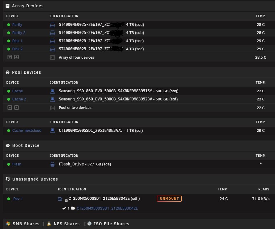

  6. Thank you. I tried the xfs repair and I get this "fatal error -- File system metadata writeout failed, err=117. Re-run xfs_repair"
