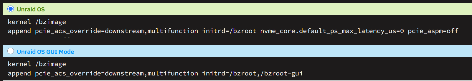

  2. Great. So to confirm it would be: kernel /bzimage append pcie_acs_override=downstream,multifunction initrd=/bzroot,/bzroot-gui nvme_core.default_ps_max_latency_us=0 pcie_aspm=off
  3. nettech_gt posted a topic in General Support
    I want to set GUI boot as default. This is what I have selected right now. After selecting Unraid OS GUI mode. Would I need to add nvme_core.default_ps_max_latency_us=0 pcie_aspm=off to match what I currently have for Unraid OS? Thanks!

  6. At the moment my server is doing a parity check, so I can't test it right now. However I found this: Should I select "UNRAID OS GUI mode" on the right (blue dot) and then would I need to add anything else to get my cache pool to boot? I didn't know this was an option. I would prefer to boot to GUI mode by default rather then console. Thanks.

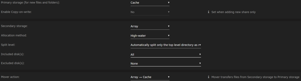

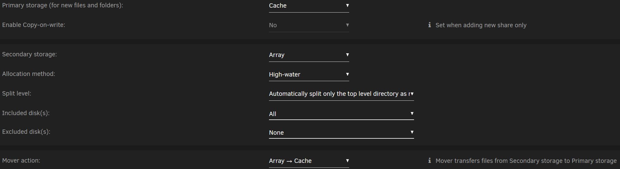

  10. Ok. Would you recommend I keep this for my system share config? Or is there no need for the secondary storage to be set for the Array? Thanks.

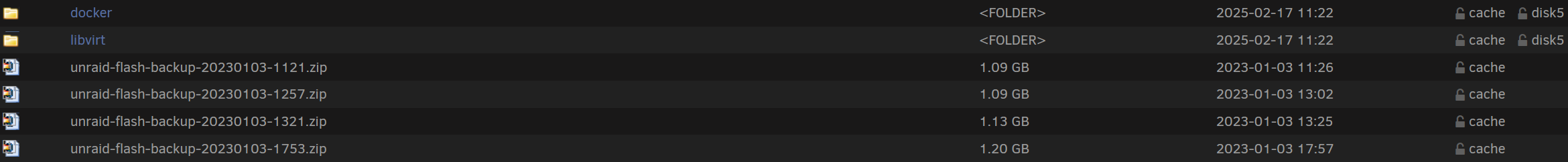

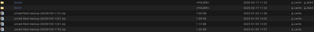

  11. I checked the Users Share page, this is what is on the array from system. I set up my server many years ago so I can't remember exactly my reasoning for configuring everything. Can you explain why I shouldn't leave it how it is. Is it best practice to have everything from system running on the cache only? Why? Thanks!
  12. Ok. What system files are on the array? Once the Docker and VMs are down what do I need to do to put the files in the correct place? Thanks.

  15. My Dockers and VMs are running again! THANKS!!! From my understanding it seems when I attempted to upgrade to 6.12.15 This caused the cache drives to not load. kernel /bzimage append pcie_acs_override=downstream,multifunction initrd=/bzroot nvme_core.default_ps_max_latency_us=0 I don't understand what changing it to this did... kernel /bzimage append pcie_acs_override=downstream,multifunction initrd=/bzroot nvme_core.default_ps_max_latency_us=0 pcie_aspm=off pcie_port_pm=off From the other post I mentioned, I set the syslinux command (mentioned above) to fix a NVMe drive issue. At the time it was needed for an issue with the Samsung 980 and the currently used kernel. (if I remember correctly) That was a year ago and I forgot that I made that change. I read all the change logs and known issues before upgrading and didn't see anything mentioned that was related to my current situation. What I would like to know is, if I attempt to upgrade again will this be a problem? Is there anything I can do before I upgrade (presently) or in the future to prevent this from being an issue?
