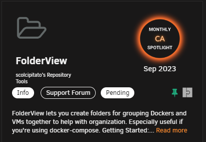

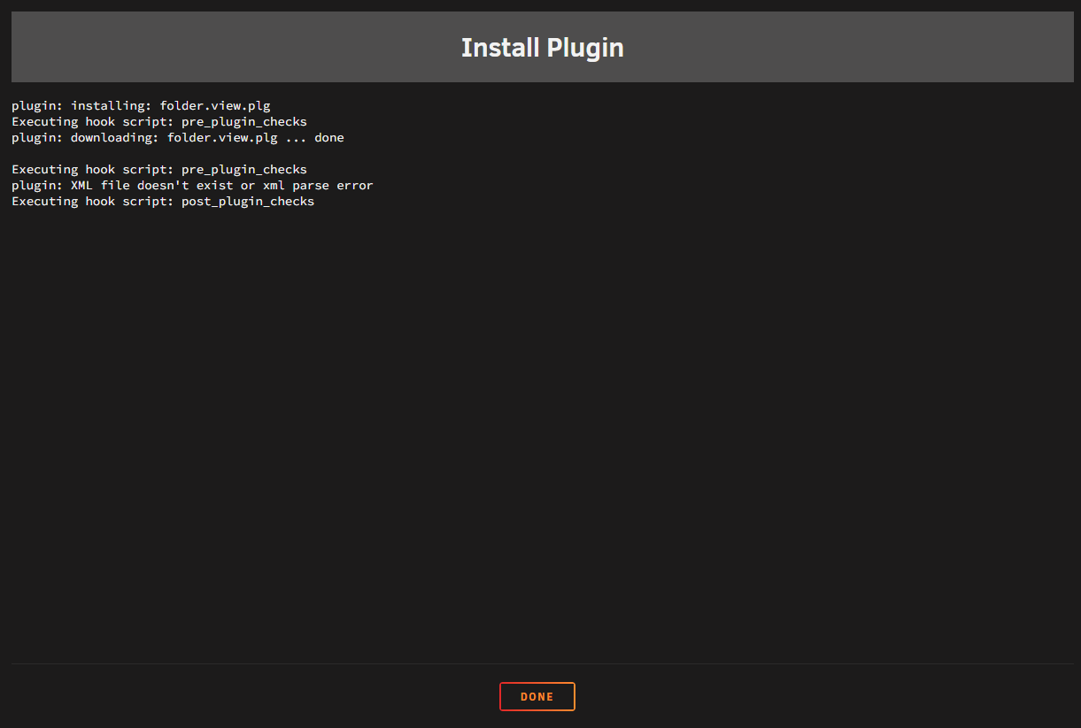

  4. I genuinely don't know how to install this plugin. Forgive me for being ignorant. I am on Unraid 6.12.8 I did try using the Install Plugins tab and I'm encountering this error: plugin: installing: folder.view.plg Executing hook script: pre_plugin_checks plugin: downloading: folder.view.plg ... done Executing hook script: pre_plugin_checks plugin: XML file doesn't exist or xml parse error Executing hook script: post_plugin_checks URL I used: https://github.com/scolcipitato/folder.view/blob/main/folder.view.plg
