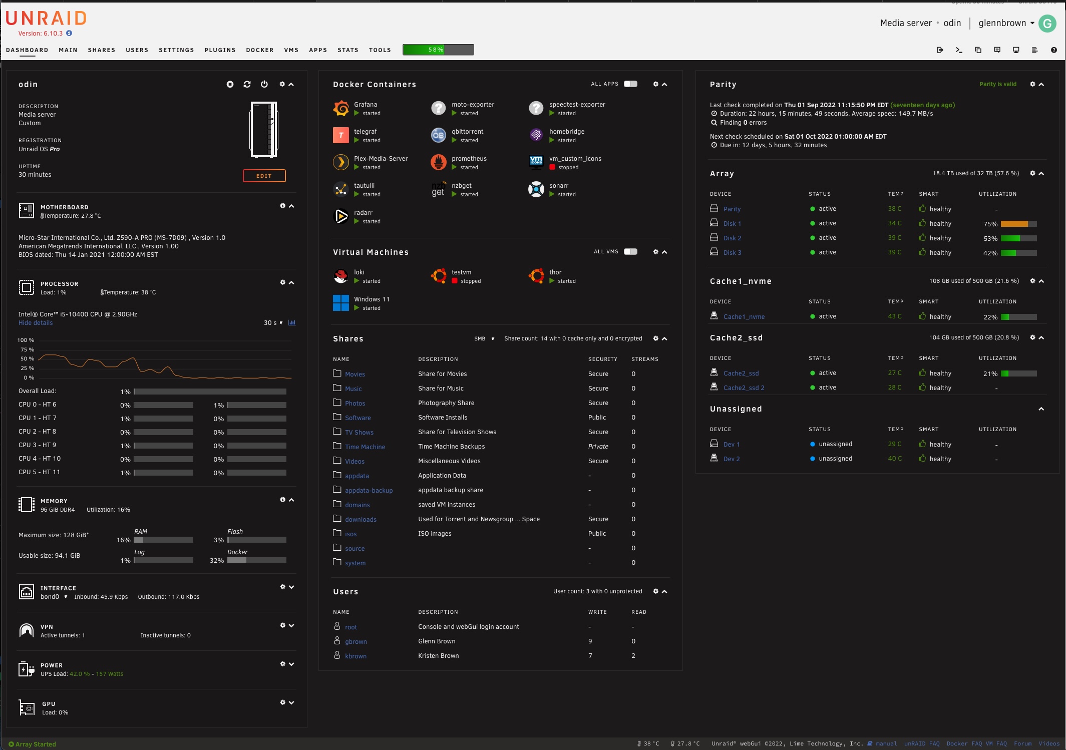

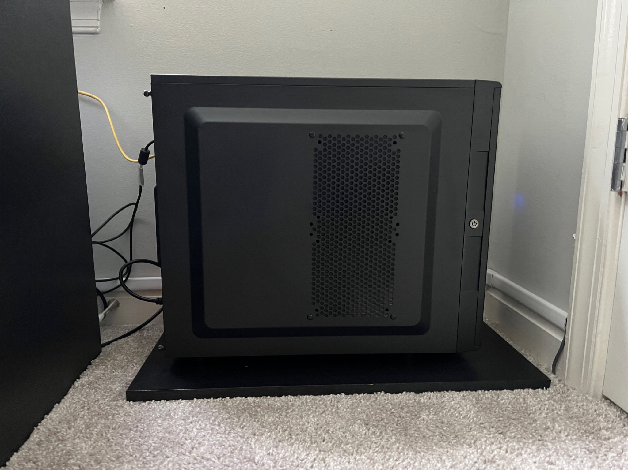

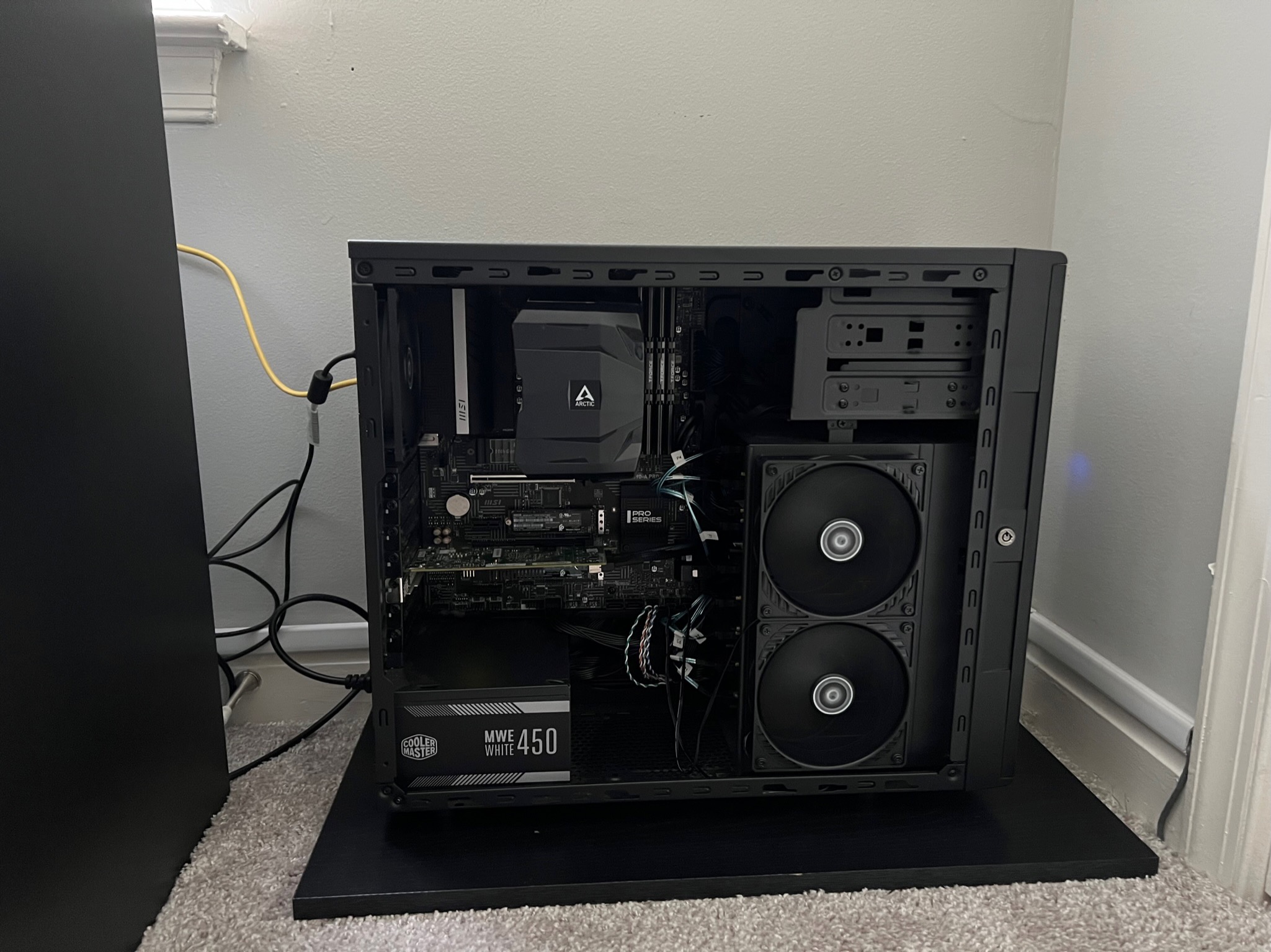

  10. System was originally built in 2020 to just run Ubuntu Linux and my storage was held by a Synology, after a series of hard drive failures I got a different case and switched my setup to Snapraid+Mergerfs on Ubuntu. After recommending numerous people to use Unraid including my father I decided to walk the talk so to speak and switched to Unraid myself maybe about 10 months ago now. Today I did a motherboard and ram upgrade plus added some new fans, CPU Cooler and an additional 1TB NVMe. Specs CPU: Intel i5-10400 Motherboard: MSI Z590-A Pro (was originally a Gigabyte B460M-DS3H) Memory: 96GB Team Group VulcanZ DDR4-3200 2x32GB Kit and a 2x16GB Kit SSD: 500GB WD SN750 Black m.2, 1TB WD SN750 Black m2 & 2x Samsung 840 SSD's (going to be retiring the Samsungs) HDD: 2x WD 10TB, 2x WD 12TB (all where shucked Easystores) HBA: LSI 9207-8i PSU: Cooler Master 450W CASE: Silverstone CS380 Miscellaneous: Arctic P12 Fans and Arctic Freezer i35 CPU cooler Some potential future upgrades: Power Supply, the current budget one has held up extremely well but would kind of like a Seasonic CPU, I am hoping that with Raptor Lake the 11700K will have some good sales at Microcenter.
