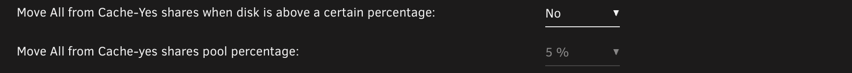

  18. So I figured it out there is a option in Mover Tuning that delays moving "yes" shares until a certain percentage is hit. But doesn't seem to be obeying the 5% rule since the cache pools where above 5% used. root@odin:/var/log# df -h /mnt/cache* Filesystem Size Used Avail Use% Mounted on /dev/nvme0n1p1 466G 117G 349G 26% /mnt/cache1_nvme /dev/sdb1 466G 45G 420G 10% /mnt/cache2_ssd I disabled the option and fired off Mover and it is now moving files to the array for the shares that are set too Yes
  19. So pretty new to new Unraid, I understand that with a share set to "Prefer" data will be generally stay on the Cache pool. However I thought that when set to yes it would write to the Cache and when Mover runs it would move the data to the Array. It does not appear to be doing that right now. I did install the CA Mover Tuning Plugin but did not modify anything in it.

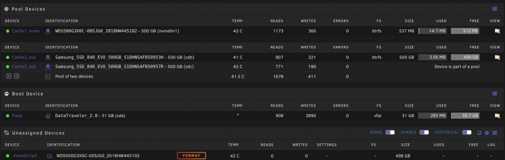

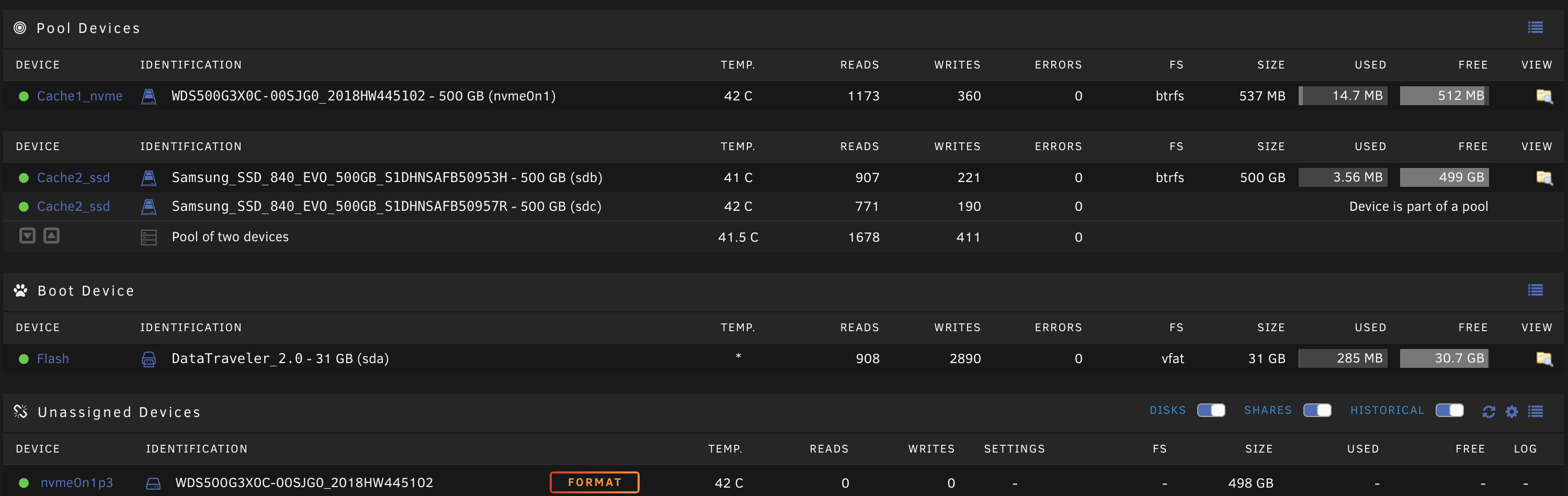

  21. So I created two different cache pools. cache1_nvme - Single 500GB NVMe drive cache2_ssd - Two 500GB SATA SSD's The ssd based cached created properly and is the expected space I would see. The nvme pool on the other hand only is a small 537MB size not the full 500GB. This drive was previously my boot volume for my server when it was running Ubuntu (just switched to Unraid) wondering if that caused this hiccup. Question is can I fix it without having to delete and re-create it?
