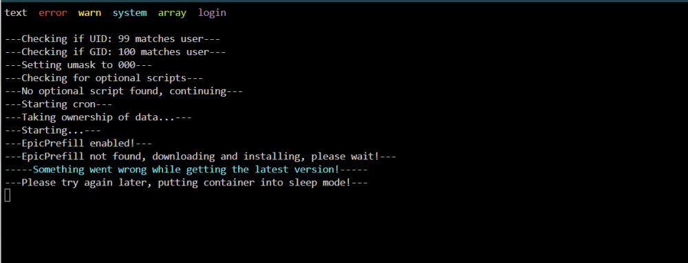

I'm trying to get the prefill lancache up and running. But it doesnt start and install properly, this is in the log: - Disabled drives. Cant stop array..
