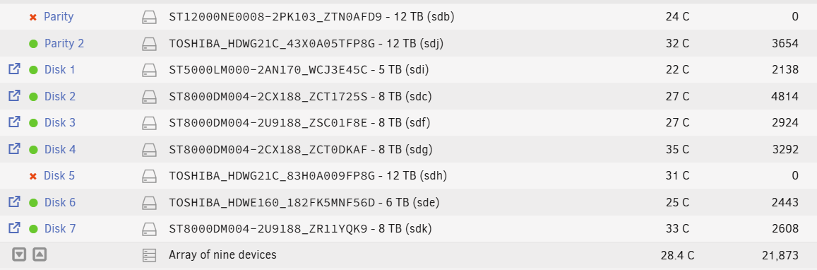

I have several issues and need some help.. This is the second time these 2 drives has gone disabled. I did manage to rebuild the parity last time. But lost the data on disk 5. How do I know why they got disabled?

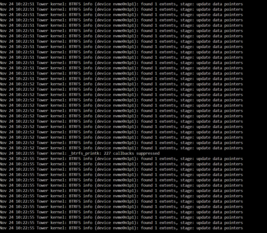

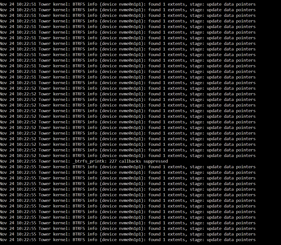

The log is only filled with these:

Looks like a pool is stuck balancing, post the output from:
btrfs balance status /mnt/cache

Would need to have the unraid syslog, set up syslog server for next time. Common causes are faulty SATA/power cabling or HBA and insufficient power supply. Since it was the same drives twice I'd suspect the cabling/connections.

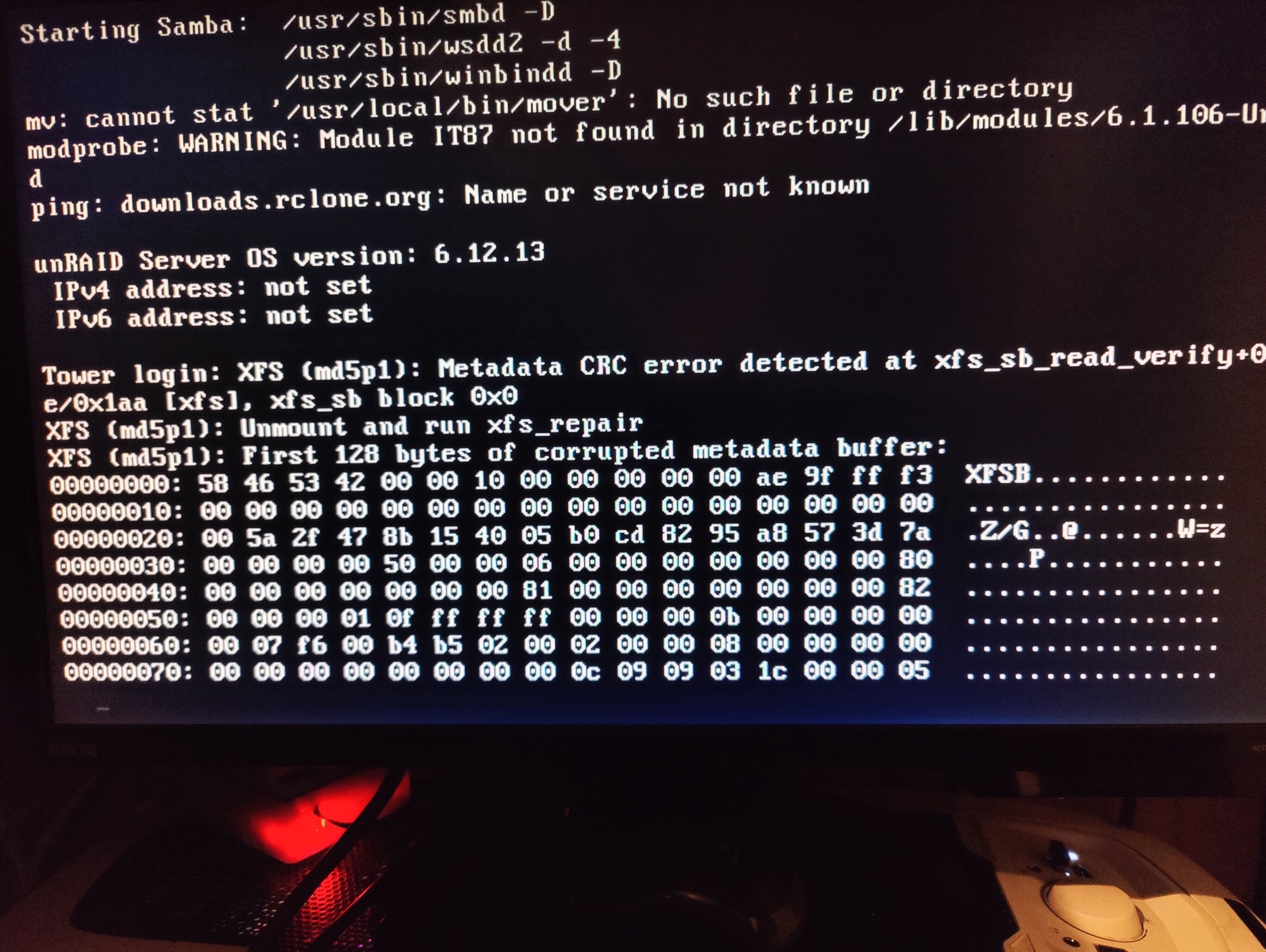

I got this. how to fix it?
1 hour ago, JorgeB said:
Check filesystem on disk5, run it wihout -n

Need to figure out why it was disabled, and then rebuild or replace, in any case, still need to repair the filesystem first.

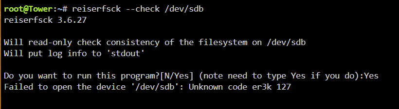

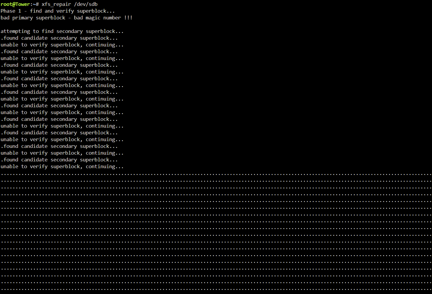

I get this when running xfs_repair. still going..
That's not the correct way, use the GUI.

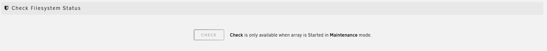

I'm not able to run that. since I cant stop the array, I cant start it in maintenance mode..
You will need to stop the array first, if you can't stop normally you will need to force it.
