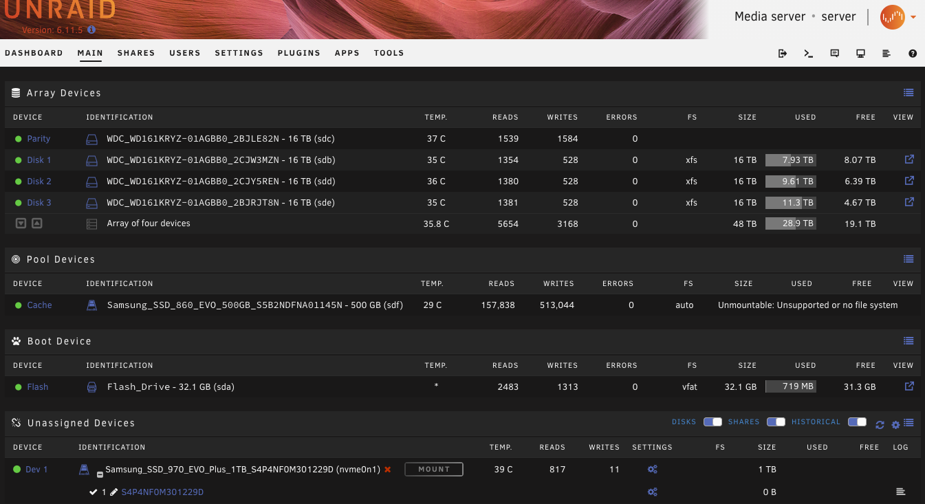

  7. I screwed up and unintentionally added nvme0n1 to my cache pool when it should only be a single drive - sdf. I removed the nvme drive and set the pool back to 1, however, I get the message "Unmountable: Unsupported or no file system" and can't proceed without it asking me to format. Is there any way around this without losing the data on that drive? server-diagnostics-20230201-1958.zip
