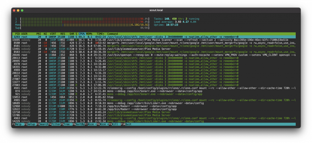

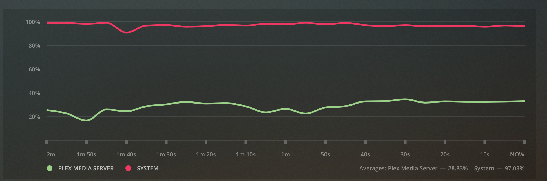

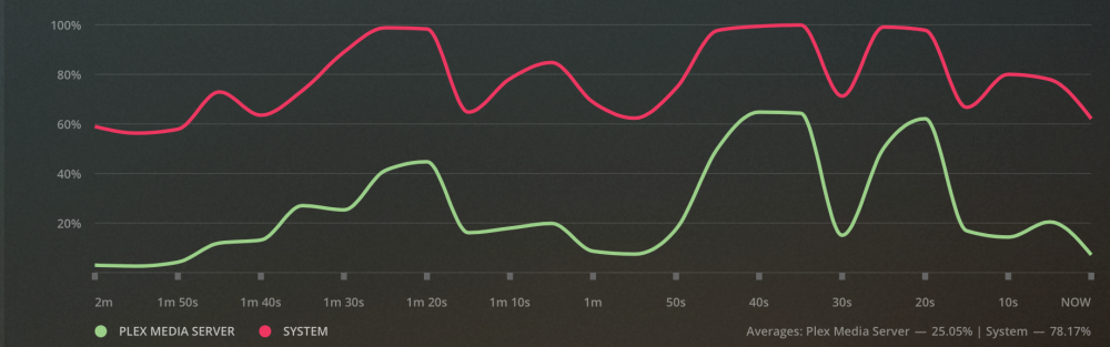

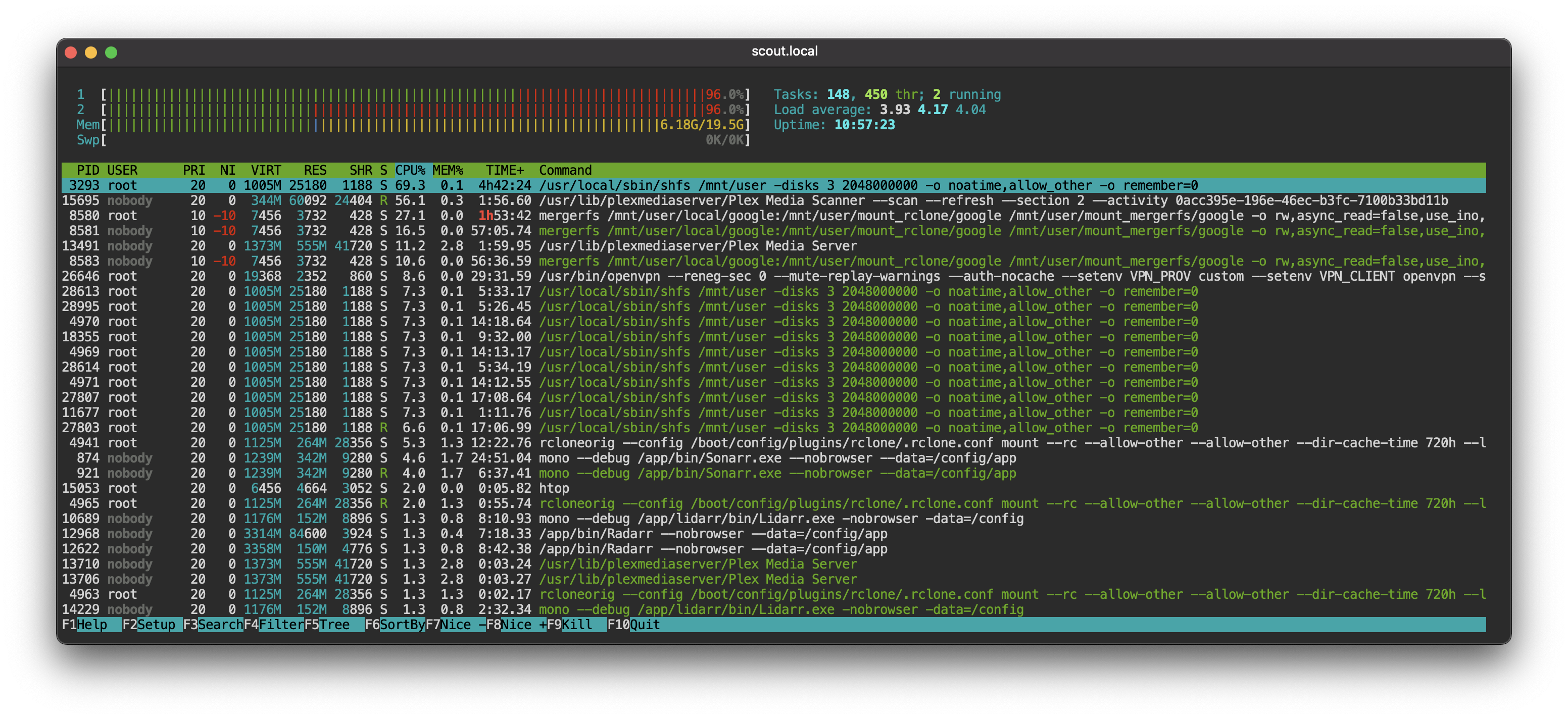

I am having an issue that I just can't seem to put my finger on. I constantly have 50% or more of my CPU being used and I have no idea what's causing it. I've attached a pic of terminal with htop running beside it as well as graphs from a direct play on Plex. I've tried turning off Docker, VMs, and it's still hovering at 50%. I only have 1 cache and 1 data drive (system running on an HP290). I know this Celeron isn't the highest performing CPU, but this seems a bit odd. FWIW, I was having the same issue on my older Xeon 1226v3 on my old machine.
Meanwhile, my memory is also being hammered by Log and I don't know what that means.
Any ideas?

Do you have syslog server running? Also try booting in safe mode.

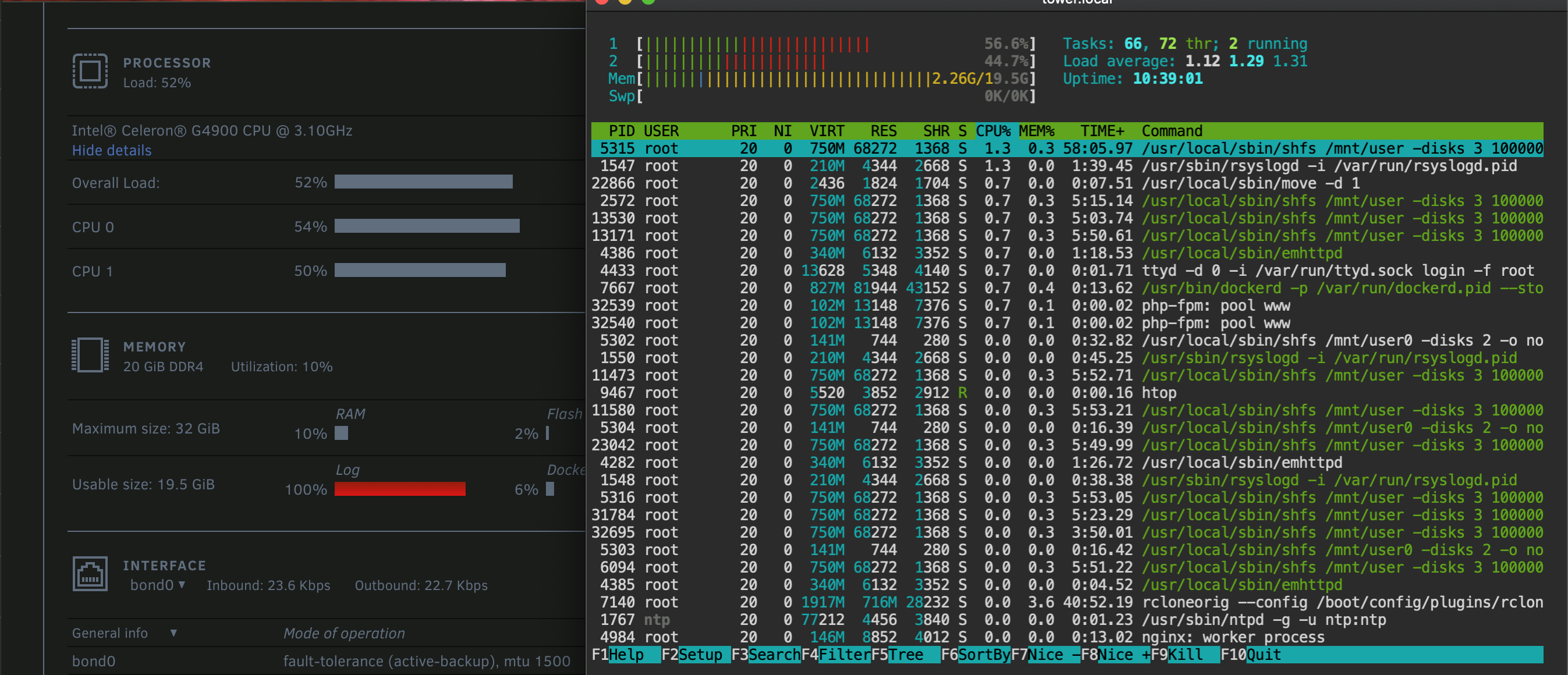

Ok, just want to follow up. I did a complete reinstall - only carried over my license number. The ONLY other thing I'm running is a mergerfs mount with rclone and Sonarr/Radarr/DelugeVPN, but I'm not seeing how those would be hammering the CPU all day.
Any ideas? Diagnostics attached.

If you stop the array is CPU still pegged?

Stopping the array drops it to 1% (if that).

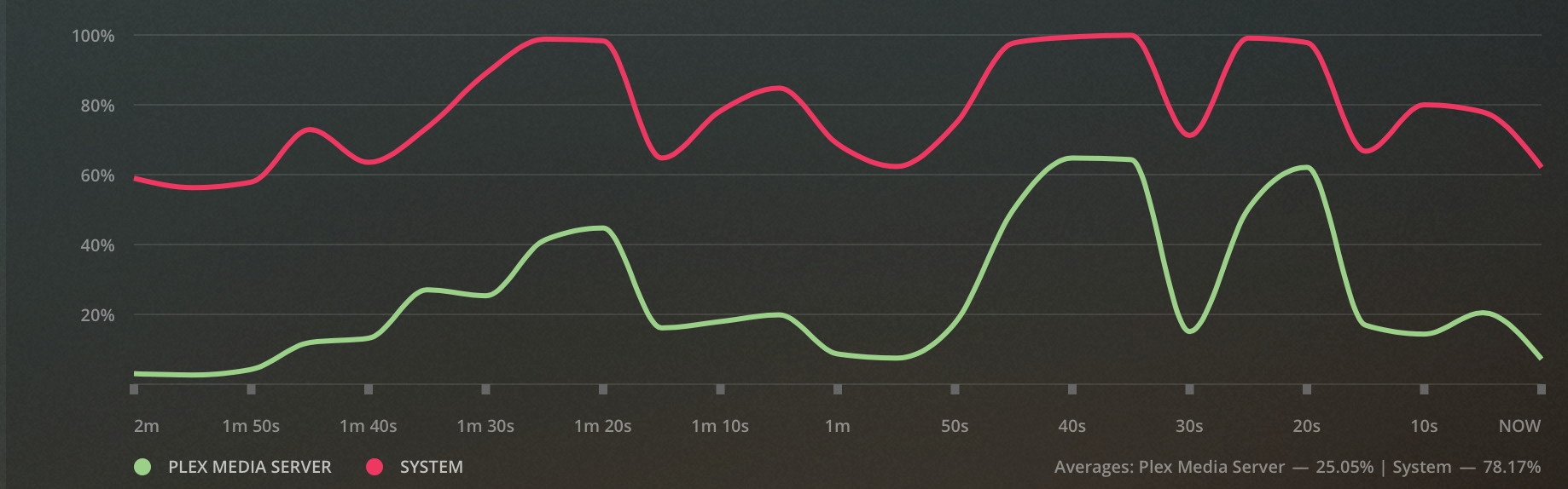

I noticed in your screenshot plex is doing a scan, try starting your array but not running Plex and see what usage is like.
The culprit might be Plex being over zealous.
I've actually been watching it for the last 10 minutes without a scan, and after the rclone mount has been added. Plex is at 2%, max right now (no scans), while streaming a video. I'm going to start every docker one at a time to see if maybe a docker has gone wild.
EDIT: Things were going like they should be until I opened NZBGet. As soon as it opened, the CPU and process shot up and won't subside. Interestingly, this was happening on my previous install...when I was using Sabnzbd.
EDIT EDIT: According to advanced view on the Docker tab, NZBGet is only using 1%. So I'm thinking it's not actually NZBGet after all.
EDIT EDIT EDIT: It just appears out of nowhere 11 minutes after the server is rebooted. I installed the Open Files plugin and it showed me a random video file was open, so killing that has fixed the error. I will keep monitoring.

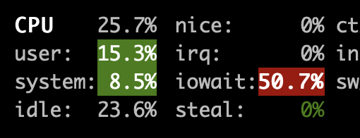

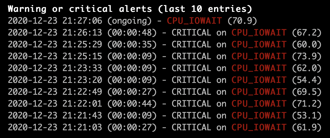

It seems like I have extremely high iowait. What causes this? I run one NVMe, one HDD. I keep everything besides seeding downloads on the cache, and I wouldn't expect to slow my server to a crawl whenever Sonarr or Lidarr copy files.
Any help would be much appreciated! I'm at a complete loss here,
