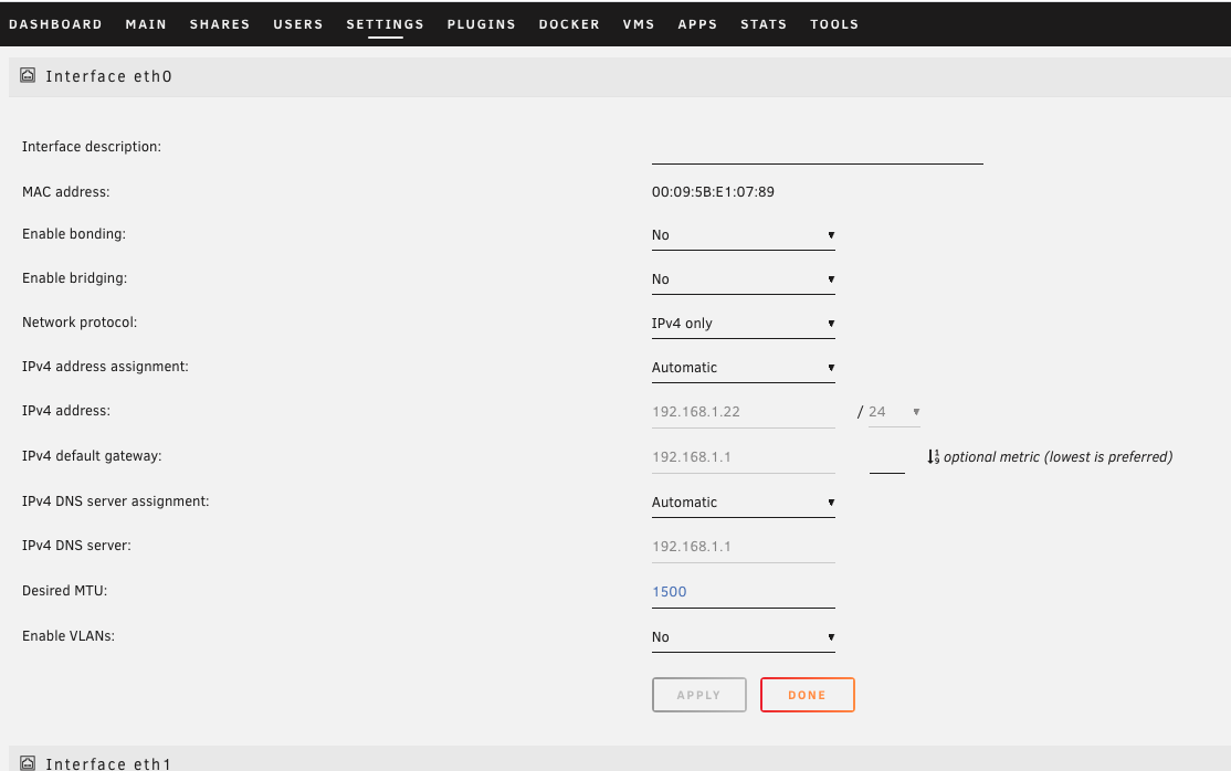

I updated the network.cfg file to enable DHCP and booted the server.  It boots, gets a dynamic IP from the router, and I can pull it up in the browser by IP.  I cannot browse to the server by going to http://tower.
Is there any special config that I need to make to my server or my router, in order to reference the shares and web ui by DNS name?

I read through some of that quickly and I don't think that related to the issue I'm having.  I thought that I can just navigate to http://tower in a browser on my lan and load the UI tooling.  Is that not the case?  I would like to switch to using DCHP and refer the server by host, but I'm not understanding how to do that.  For some reason tower isn't getting resolved to my DHCP address.

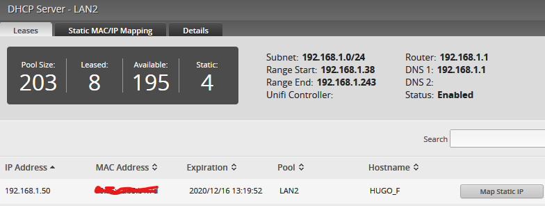

In my Ubiquiti router, I have a table of DCHP assigned addresses which a bit of looks like this:
Notice that the Name of the computer, 'HUGO_F', is a part of this information.  This allows access to the computer by using the name.  Having the name, allows the router to resolve the name to the IP address!

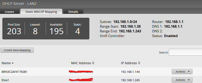

I also have another screen that look like this for the Static IP address:
Notice again that the name of my Server, 'Elsie1', is present to allow resolution of the name to the IP address.  (Ignore the other one as it is a printer.)
While I have blacked out the MAC addresses (because they are unique!), they are used by most routers to reassign a computer to the same IP address even when they are completely off-line for a longer period of time.  (I know the period for this router is more than a few days...)
