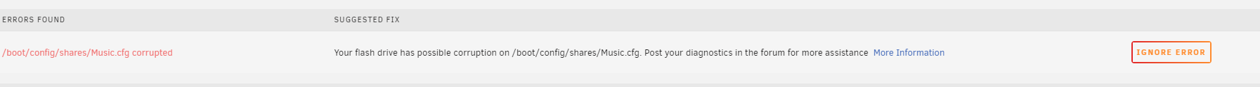

Fix Common Issues App Issue
Thanks, backed up the flash, deleted the Music.cfg file and unraid recreated it.
Hello, Just discovered this "Fix Common Issues" app and ran it. It reported this: So I've attached my diagnostics. Is there something I should do to address this? Thanks! tower-diagnostics-20230901-1105.zip
