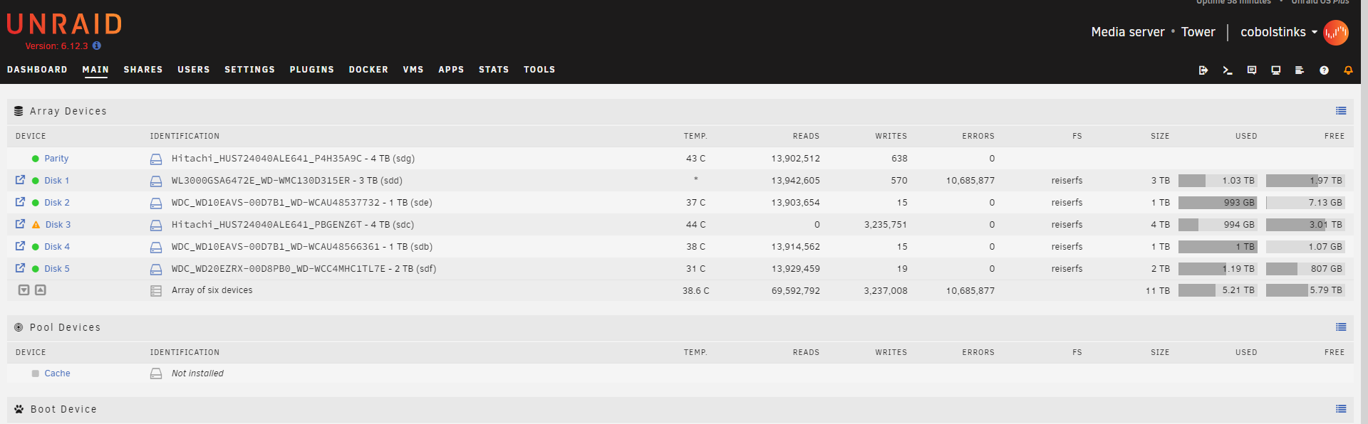

  16. Thanks for all your help! I'm making some progress but have another setback. I was able to replace the 3TB disk1 that was reporting errors with a new 3TB disk. I then upgraded my parity disk to a new 4TB disk. I then started to replace my existing smaller data disks with other 4TB disks but I keep getting errors on disk1 reported while attempting to rebuild disk3 onto a newer larger disk. I'm pretty frustrated with this and am tempted to purchase a new mobo/cpu/ram and just try to do the rebuild on it. Is there something else I should try before just building a new server? Is there anyway to confirm the issue is the onboard sata controller? I've replaced the cable and this is now the 2nd disk that is consistently reporting errors as disk1. I'm thinking of purchasing this as my next server https://newegg.io/00a2a3d Thanks! tower-diagnostics-20230820-1240.zip

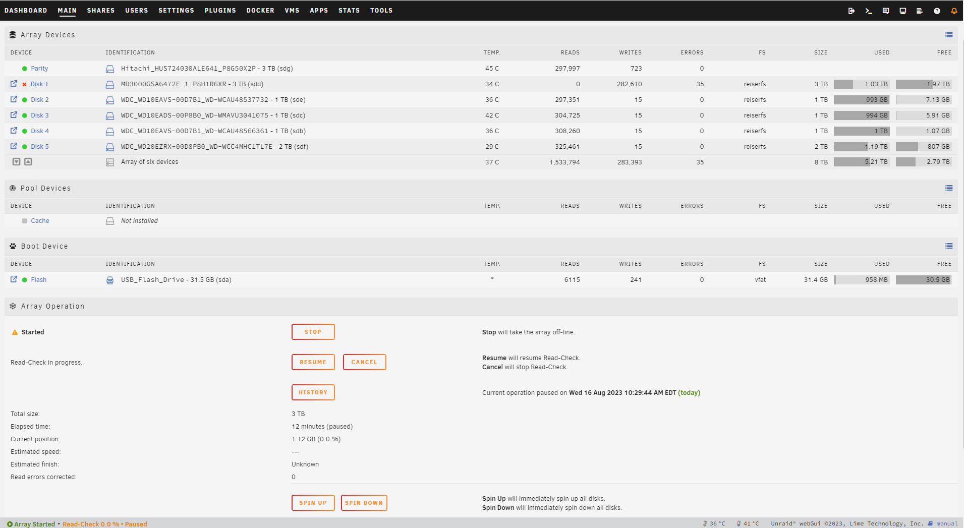

  20. I tried to rebuild on disk1 and it disabled the disk again. It says it's doing a read check, should I stop it and power it off? I ordered new 4tb disks and one 3tb disk. I will rebuild disk1 on the 3tb disk and then shuffle the disks again once I have a 4tb parity disk in place. tower-diagnostics-20230816-1040.zip

  22. I had it powered off overnight. Booted up this AM, I haven't started the array but here are the updated diags. tower-diagnostics-20230816-0748.zip
