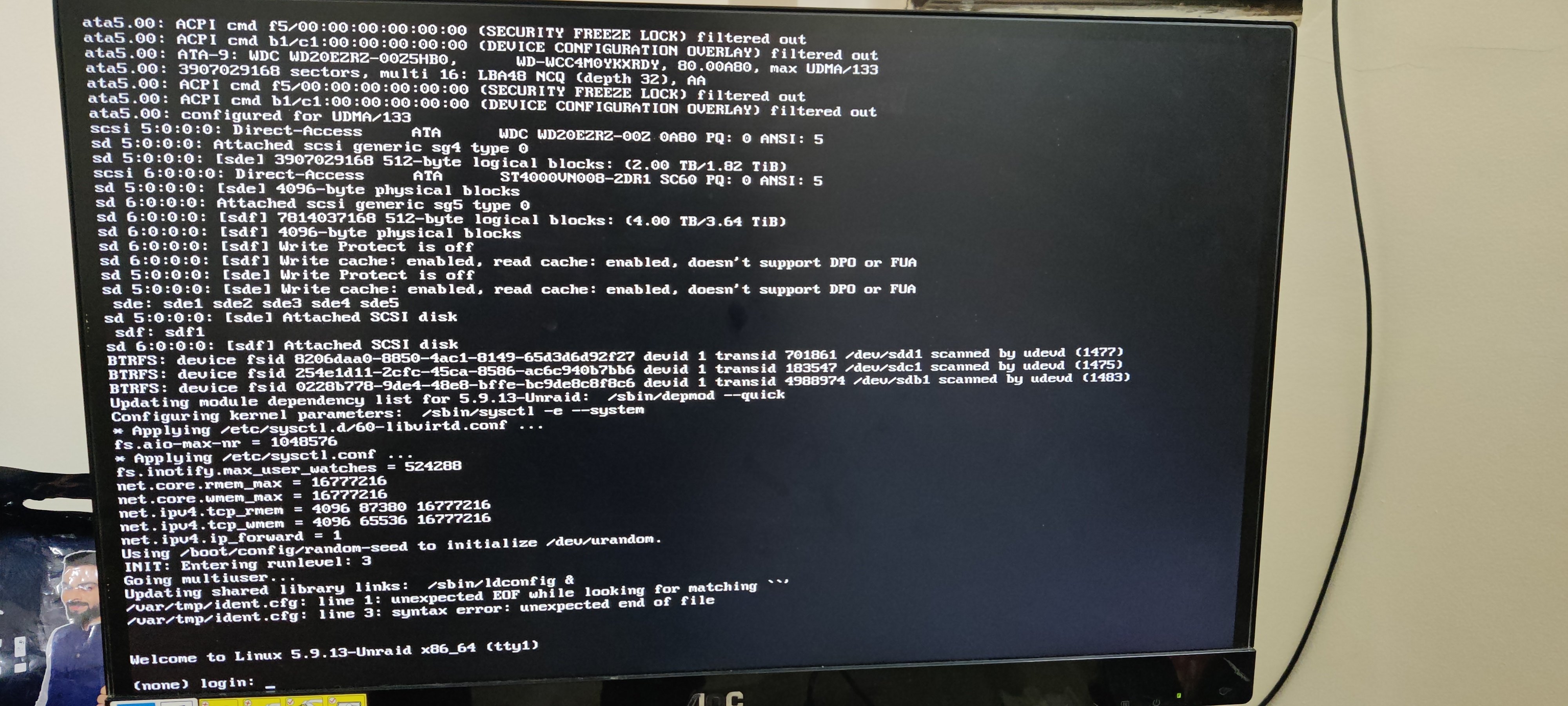

but lets forget all that as now i have even bigger problem.
i was thinking that after a reboot i start by formating my disk and see what all i have lost and start downloading stuff that i have lost but now i cant even access my web gui

Sort of a comedy of errors in a way. The emulated disk was mountable before we had to try to recover your flash backup, and not including parity made the emulation unmountable. Another reason it is better to rebuild to another disk and keep the original just in case. And maybe we could have noticed the emulated disk was no longer mountable before starting the rebuild. Etc.
Those last few lines in your photo where it is having problems reading ident.cfg make me think a flash problem.
Do you mean you can't access webUI from a browser on another computer?
yeah
Is this a new flash drive or were you able to reuse the same one that failed before?
reaseating flash fixed it.
