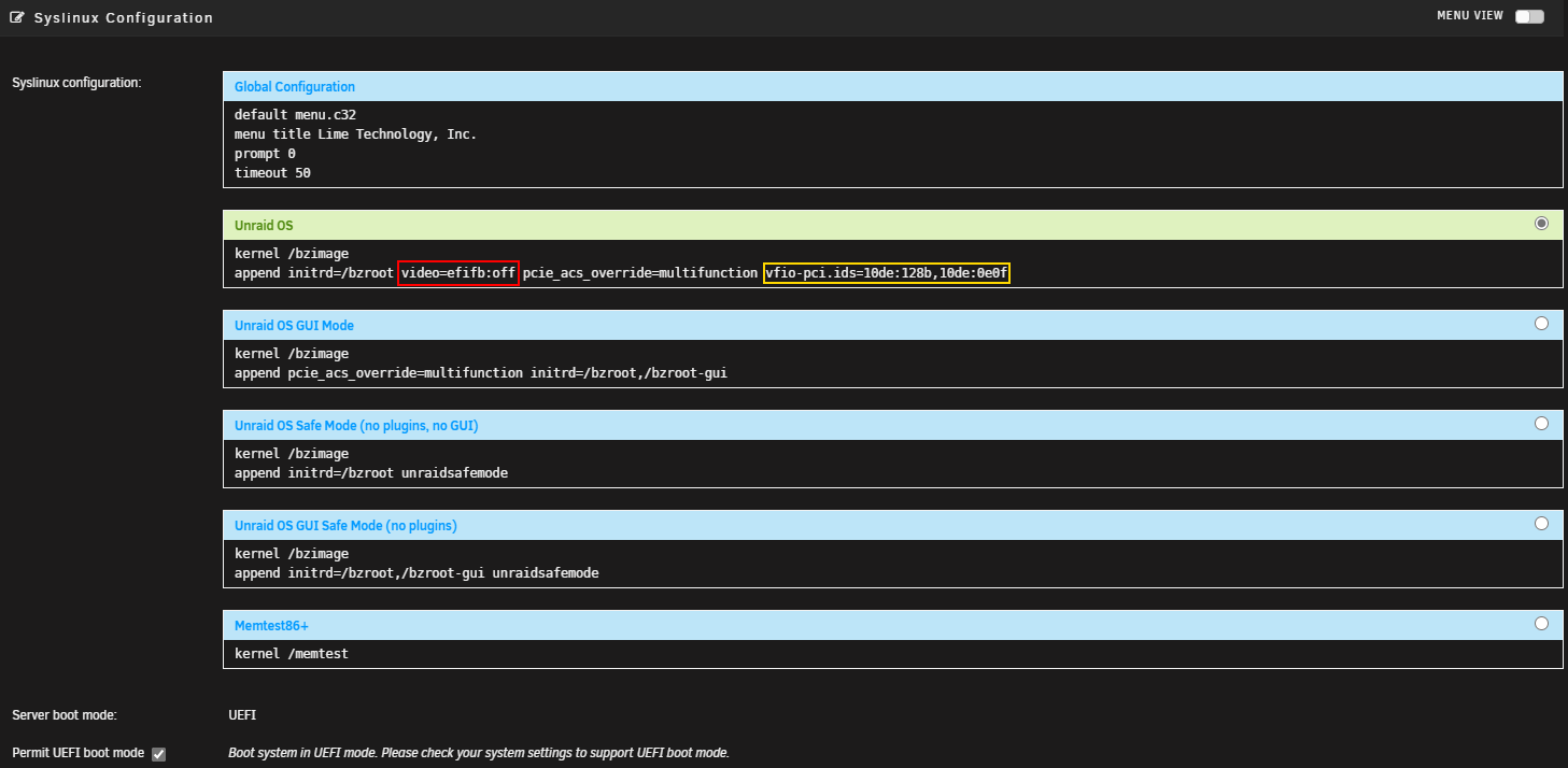

If you want a specific GPU not to be used by unRAID OS itself so that you could passthrough it to a VM, you would need to go to MAIN tab and lick on your Flash drive:
From there you would need to change Syslinux Configuration:
The red box is used for a completely headless unRAID, so you might omit that.

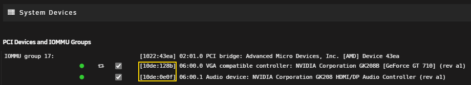

The values in the yellow box can be gathered from TOOLS --> System Devices menu:
You might need to fiddle with SETTINGS --> VM Manager (in Advanced mode) --> PCIe ACS override: for a working IOMMU Group configuration.
Note: I have a single GPU in my system, I'm running unRAID as headless and I'm reserving that GPU to be used in a VM.
But as @jonathanm mentioned, if you would like to use a dedicated GPU just for unRAID, you must set it up as your primary GPU from your motherboard's BIOS (if that option is there).
P.S: There might other workarounds, but this is all I can provide.
