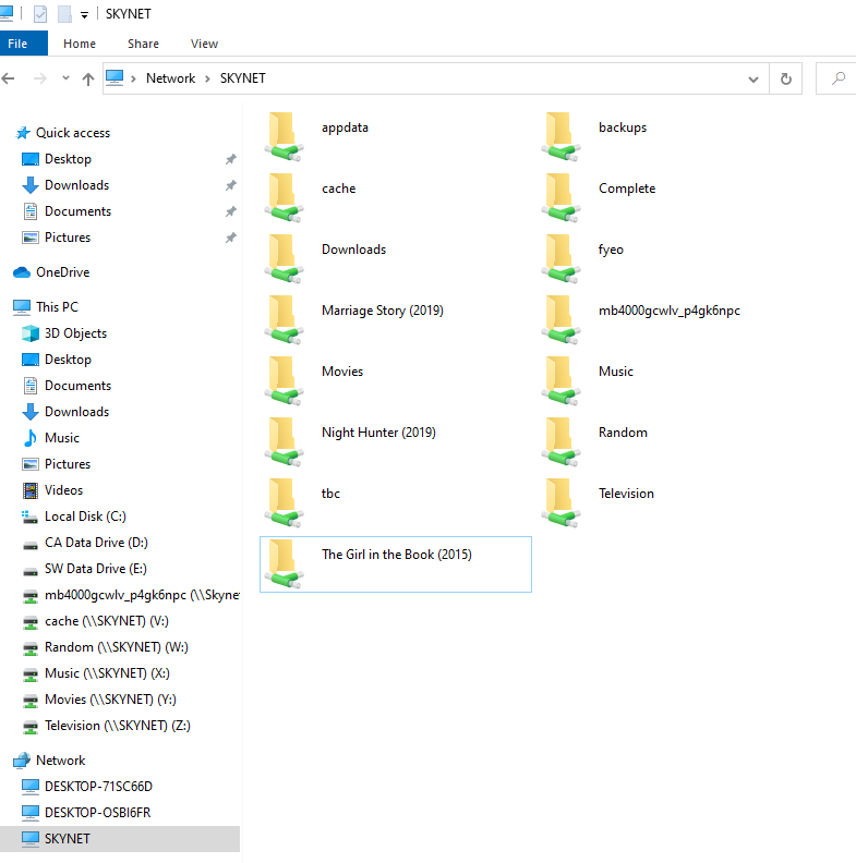

New Movies being written are showing up as base folder and also as share

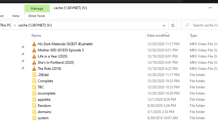

Ok - so this shows all the shares (typically) but I have no idea what I did yesterday where the last two movies are showing up in the file explorer
I don't see as a newly created share nor does anything seem wrong.  Its showing up in the Movies share as per normal.   I'm just wondering why its showing up here now.  i've included diagnositcs.

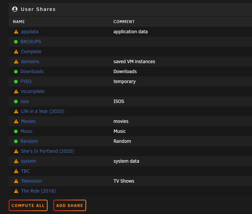

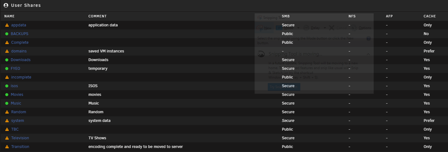

In the Unraid webUI, go to Shares - User Shares and post a screenshot.
1 minute ago, trurl said:
/mnt/user is all of your user shares, which is all of the top level folders on cache and array.
Looking in your Diagnostics it seems you have .cfg files for 52 different user shares with various names though many of them no longer exist as actual user shares. Probably these all got created when you accidentally created folders in /mnt/user or /mnt/cache or /mnt/disk1 or ...
These are set (sort of) how I want it to be set up.   Is there a way to delete all those other shares that you see?
They aren't really shares since they have no contents. They are just .cfg files leftover from shares that were created. It does make it difficult to figure out what shares you actually have though when we are looking at your diagnostics. These share .cfg files are on your flash drive in config/shares.

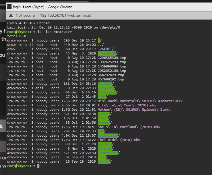

From the command line, what do you get with this?
ls -lah /mnt/user
ls -lah /mnt/user
It's the root of my cache drive.
and then this is what I'm seeing - (explorer wise)
 Do you think if I go through and delete the cfg files it would screw anything up?
There is definitely something (almost certainly a docker container) misconfigured as your cache drive should only have folders that correspond to shares - never top level files as your screenshot shows.
Deleting files from the config/shares folder on the flash drive does no damage except that if you delete one that really corresponds to a share the system will later automatically recreate it with default values for the share.   While you have anything misconfigured to be creating top level folders on the cache drive then you will continue to get superfluous share configuration files as the system automatically assumed any top level folder on any drive is to be treated as a User Share.
It's the root of your user shares, which includes cache as I already explained above:

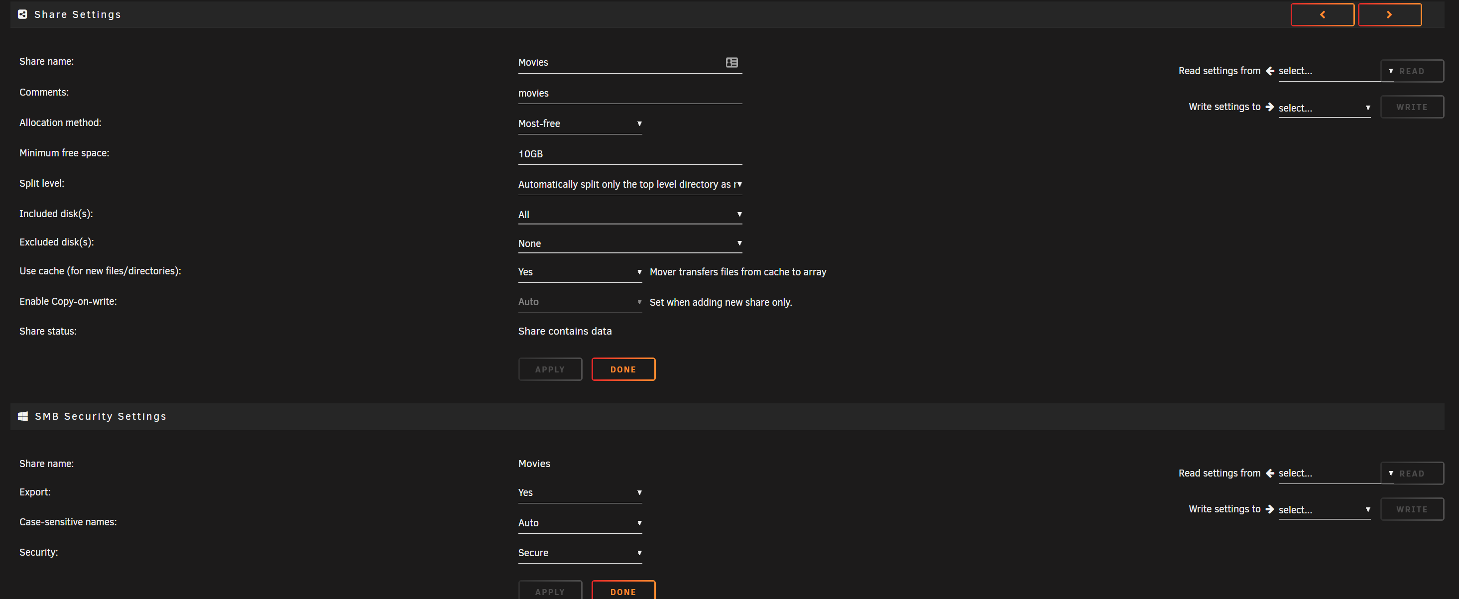

So it did it again when I moved movies from my cache/play drive into movies.  It added it as a share - I looked at the settings on my Movies share and it looks correct but maybe I'm not seeing it right.

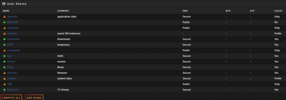

So its supposed to be in movies (duh, right?) this is the share settings. which looks right to me but obviously something is jacked up.   Thoughts?
Do you think its a weird Samba issue when I mapped the network drive to the movies share?
Edited by cbr600ds2
If you see movies showing up as User Shares then you did NOT move them to the Movies share but to the top level on one of the drives (array or cache).

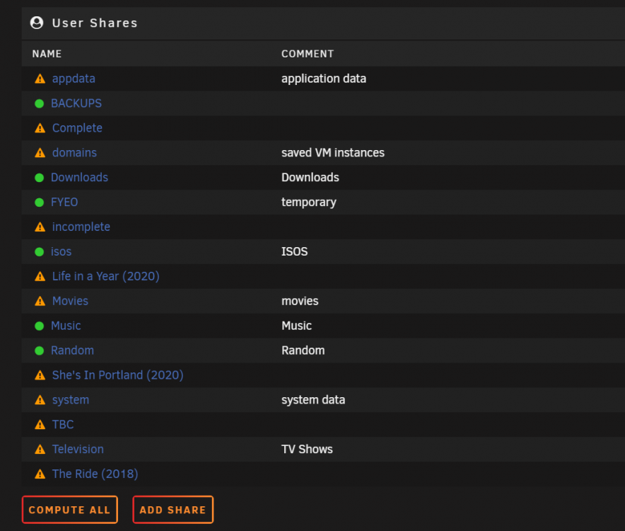

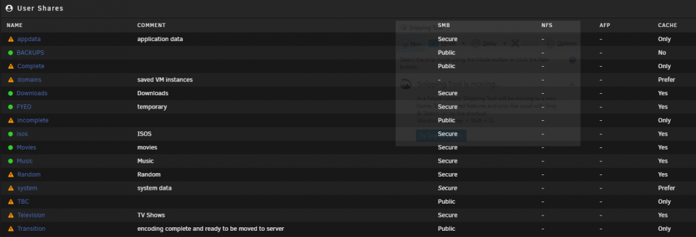

These are my shares - I'm trying to put it into a folder (transition) because if the movie shows up as a folder it creates a share for it.  If it
I have Sab download and put the completed files into the Complete Usershare.  from there Filebot automatically grabs it, changes the name and dumps the completed file into the TBC folder.   I used to have Handbrake then encode the file and just dump it into the cache root share.  I'm trying to write it to the transition share to see if that was it.
From the cache share I would create a folder for the file using files2folder and then move it (using explorer) to the Movies share.  I'm thinking that having an actual folder into this root cache drive is what creates the share cfg file.   I originally thought it was the read/write access but obviously that wasn't it.
