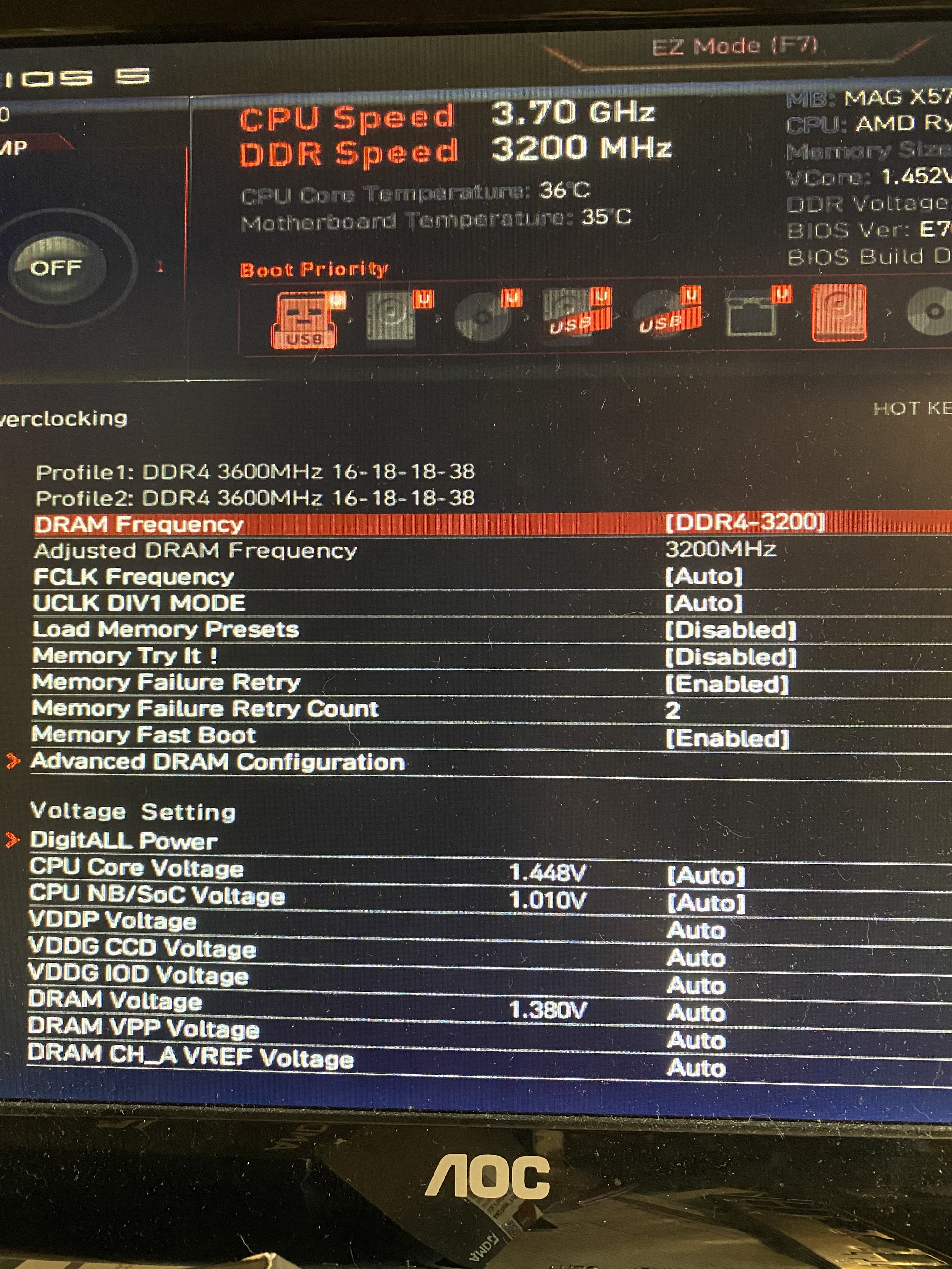

I’ve manually set the ram to 3200 MHz but I’m still getting a similar error. Are there additional locations in bios were this needs to be adjusted?

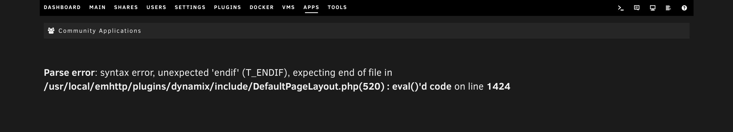

Thank you guys, the update to v6.9-RC got it up in running. The only thing that is not working is the community application tab with the following error. Is this a known issue with the beta?73AFAEEC-0BDC-41DB-B36E-520D01E941CA.thumb.jpeg.eaa243f2592754728d1e6d05e97842b6.jpeg
Update CA.  The version currently installed isn't compatible with 6.9
