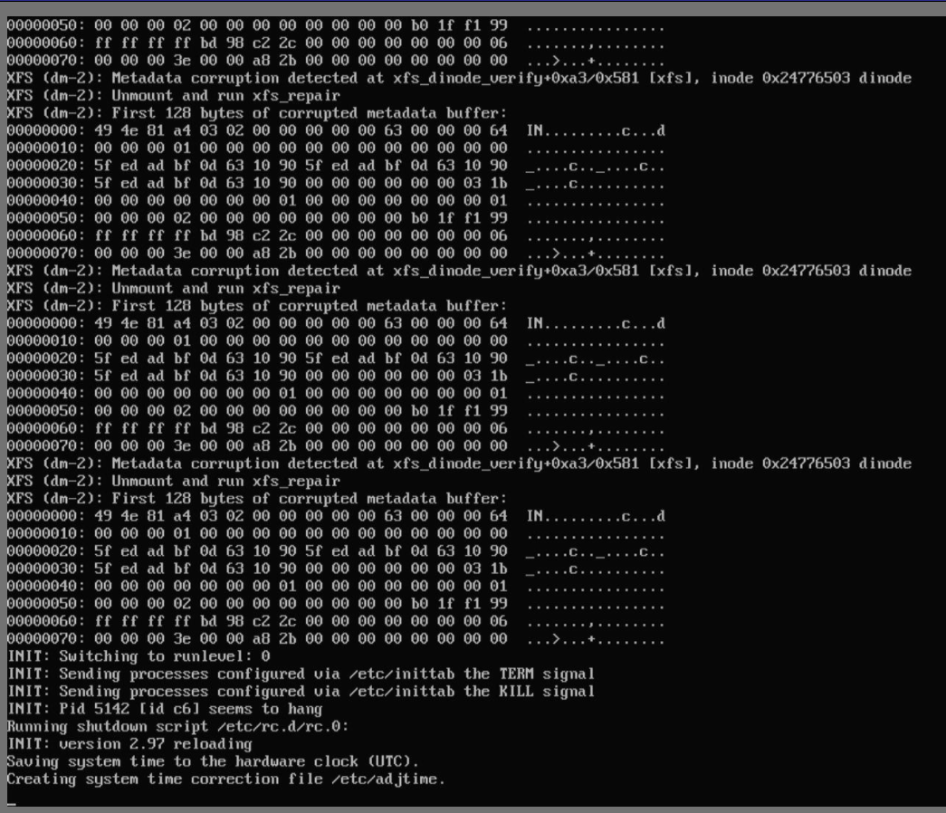

Crashed again. I could ping it but couldn't access ssh, web, or direct console.
I had the attachment on the screen. I decided to swap out the sata cable on dm-02.
Also noticed in the bios that the time was off and showing UTC time in bios.
I couldn't grab these diagnostics before the power down of course.
park-nas1-diagnostics-20210105-1836.zip
